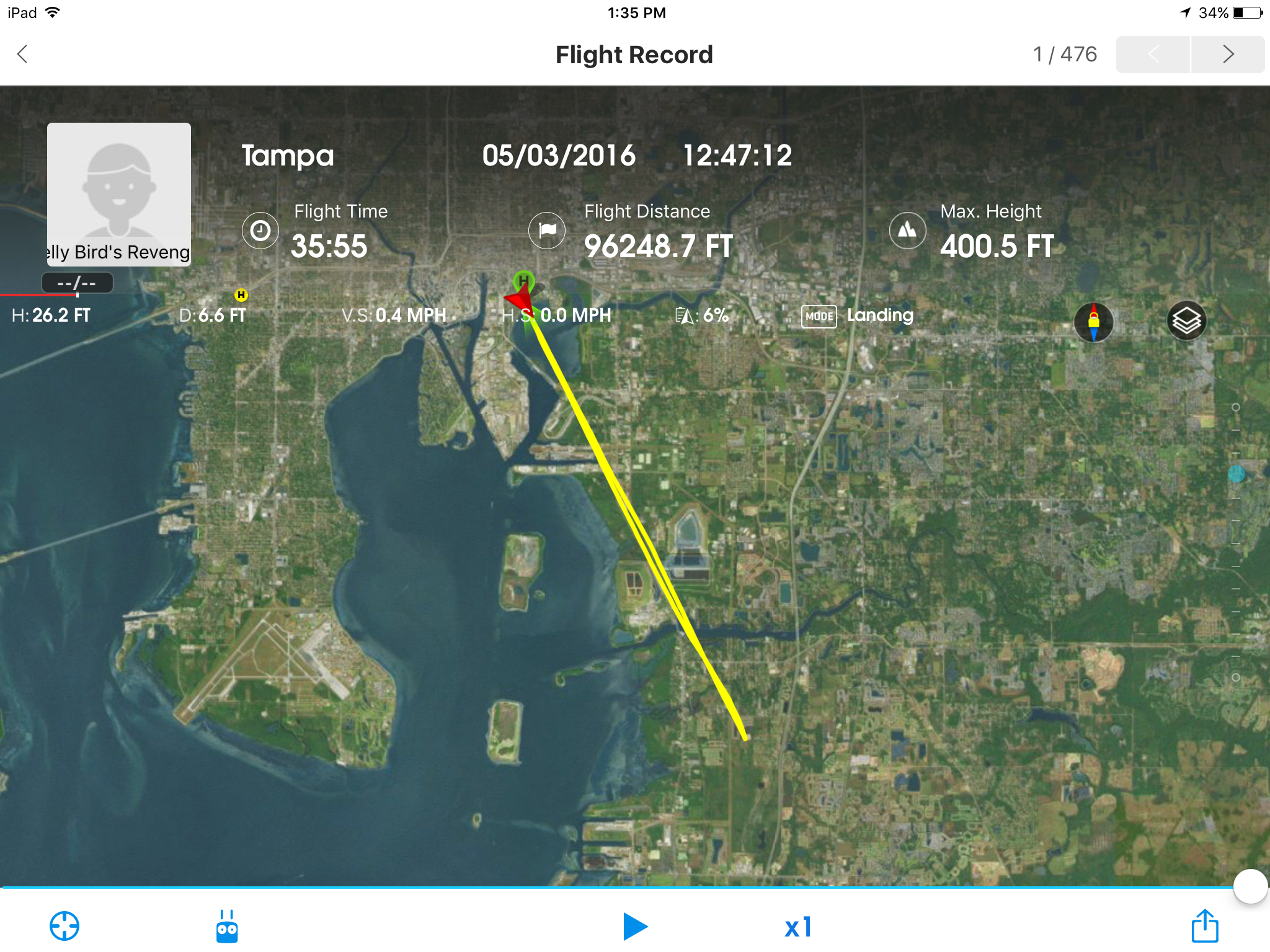

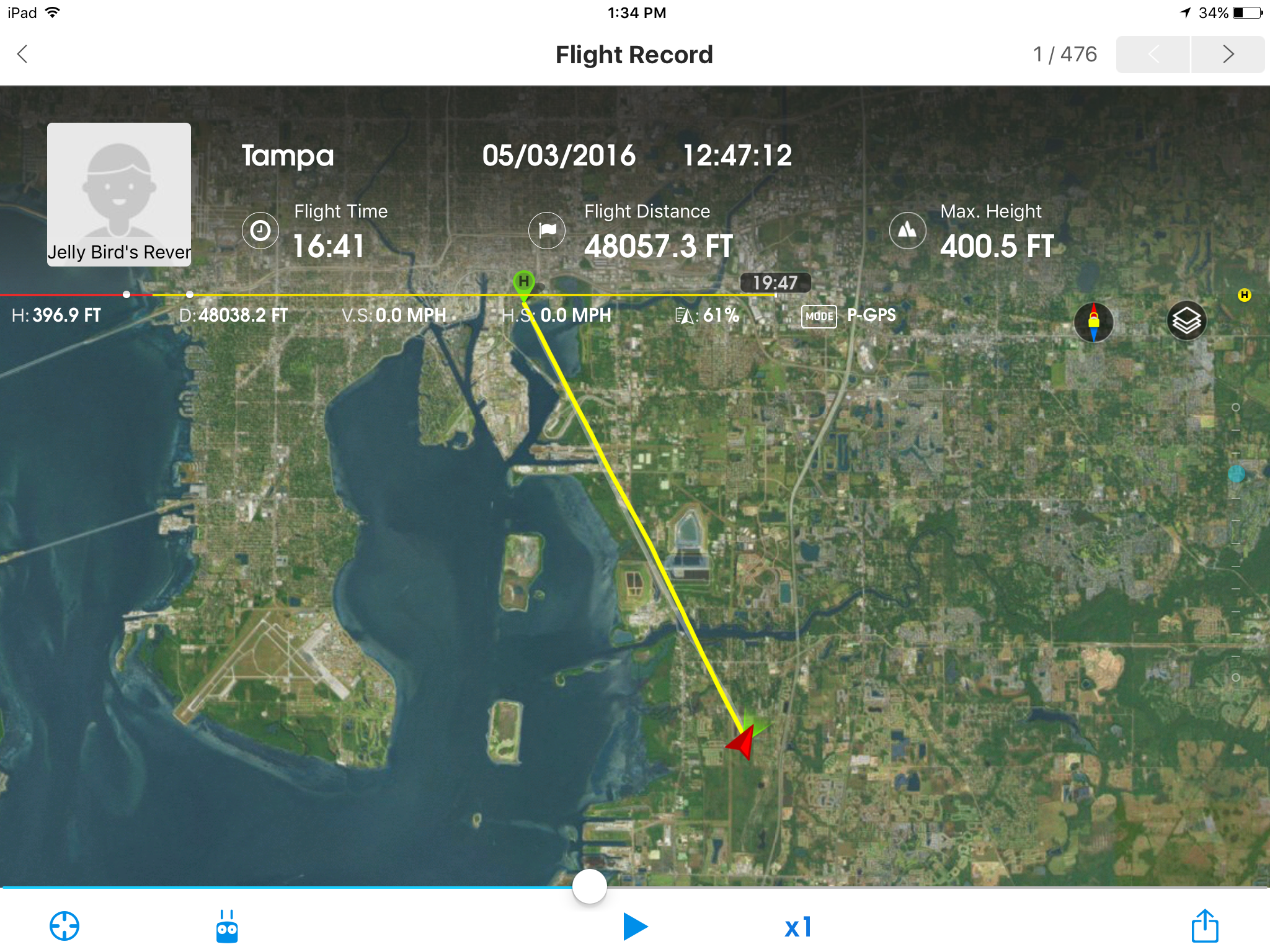

9.1 miles out and back with the Phantom 3 Horizon Power mod V3 36 min flight 6% battery left

Balls of steel man...Landing with 6% :fearscream: Congrats
Thanks man but I think I turned back to the early 6% is another mile at least that's the problem. Crosswinds are too hard to predict how fast you going to go on the way back I was flying in between 25 and 32 miles per hour I thought it would be closer than that it's got more in it. Nine and a half miles at least I'll keep trying thanks man.

Yeah I hear ya. I try a test run before really pushing it but sometimes the winds are different beyond the area that you did test run. Or god forbid wind shift.
I always do myself as well but its still hard to judge with heavy gusts like I had today. Weather reports on wind conditions are terrible it was suppose to be 2 knots today turned out being 10 to 15 mph.
