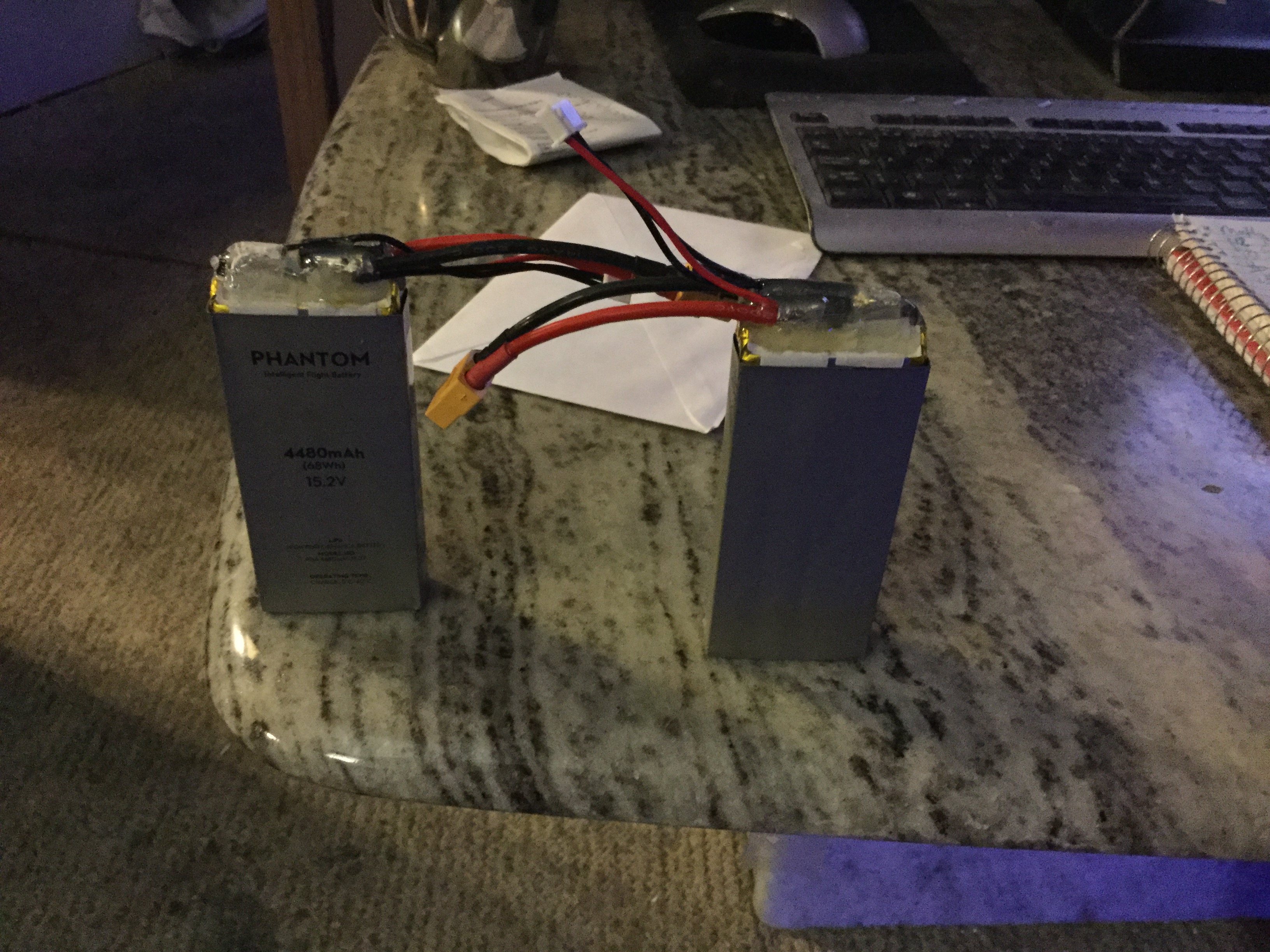

Interesting. I was able to get the pos and neg tabs soldered together no problem but the copper wire doesn't bond to the aluminum tab. I tried some light sanding on the tab but no luck. Maybe tomorrow I'll try a little solvent on a qtip. Anyways, I have some aluminum solder coming in Monday if that doesn't work.
I plan to charge them as 2 separate 2S packs. I haven't done the math yet to determine the proper charge power but I think 1C on a 4480 mAh pack is about 4.4A. I'm not going to try and push it with the charging. I'll also look at the DJI charger and see what that's doing to compare.
I have shrink wrap and everything. Ready to complete the job but I just want to make sure I have a proper bond on those tabs.

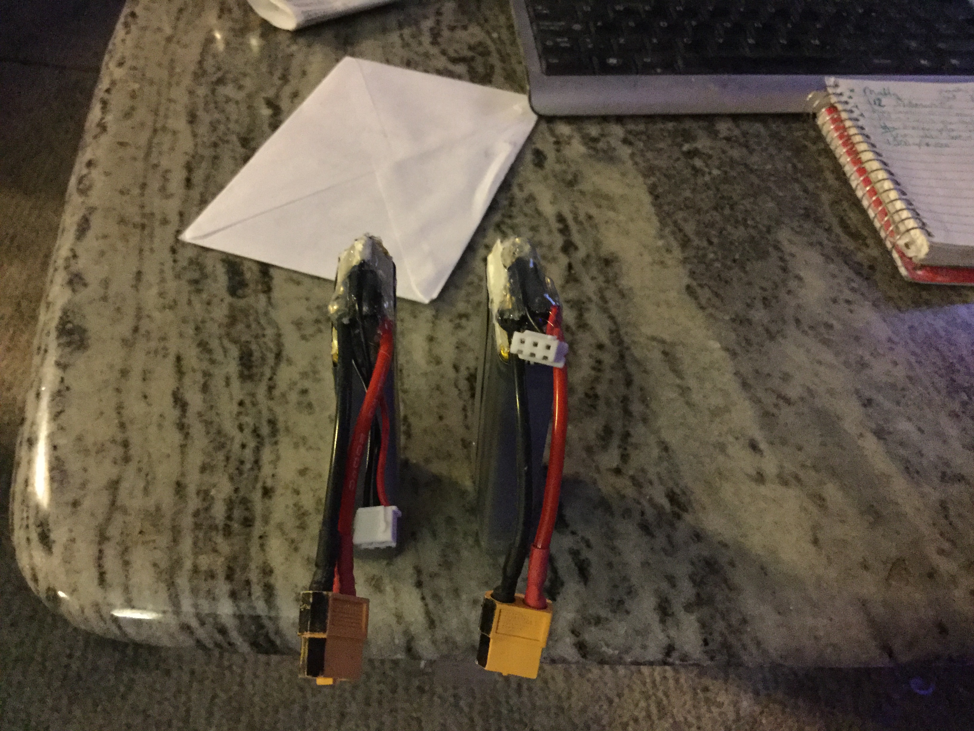

I'm going to make a series Y cable to combine the 2 packs and they will plug into my battery. Leaving the other connection empty on the FPV customs battery mod.
Ok I am not useing copper cables.what I did use was cables from my old Hyperion puffed and dismantled batt.

I already had this battery mod in parallel I just re did it in series.good To go now !!

Looks good. I would put some flexible nylon or something over the tabs and then wrap the shrink wrap over them so it holds the nylon down. It will protect the wire ends and the brittle lipo tabs. Look how your other lipo packs are where the wires come out... Well protected. You want to minimize the stress to that end of the battery. I'll try again tomorrow. I tinned the wires of course. Maybe the tabs have some residue on them.

Hoping all goes well.what I did do as well was encase the top of battery with hot glue it's solid.i am a dumb *** I got rid of that nylon I had when I parted out my old lipos.i did not think I would need it now I do!!!Lol

I am charging the lipos at 1.3A see how that goes.
Let me know. As long as you set voltage to LiHV 4.35 it should be fine. 1.3A is very conservative and will take a while.
