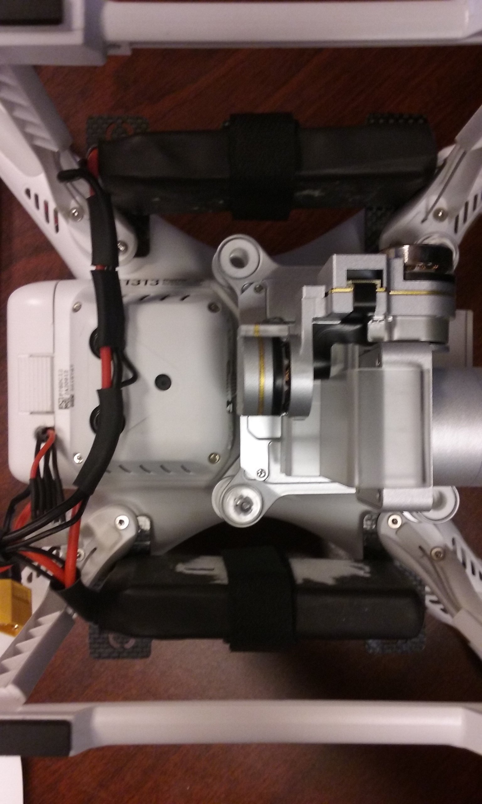

I have used that style of bracket at least 300 times I never had a problem with it bumping the gimbal or turning sideways I used a lot of different styles of batteries on those brackets smaller sized battery I might use zip ties from the front to the back horizontally to keep the battery from sliding but on the power mod v3 all I use is a velcro strap it fits perfectly. You might have to tuck the wire away from the sensors on the vision Positioning System if you use it in flight I don't know too many people that do outside I put a picture in here and show you what I mean.View attachment 45849
I've also successfully used gaffers tape to help secure the external batteries to the battery plate and the struts, so they don't slide around underneath the velcro strap. Same with tucking the battery wires up and out of harm's way. It's easy to put on and take off, and yet secure, without needing zip ties, especially to keep the sensors clear.

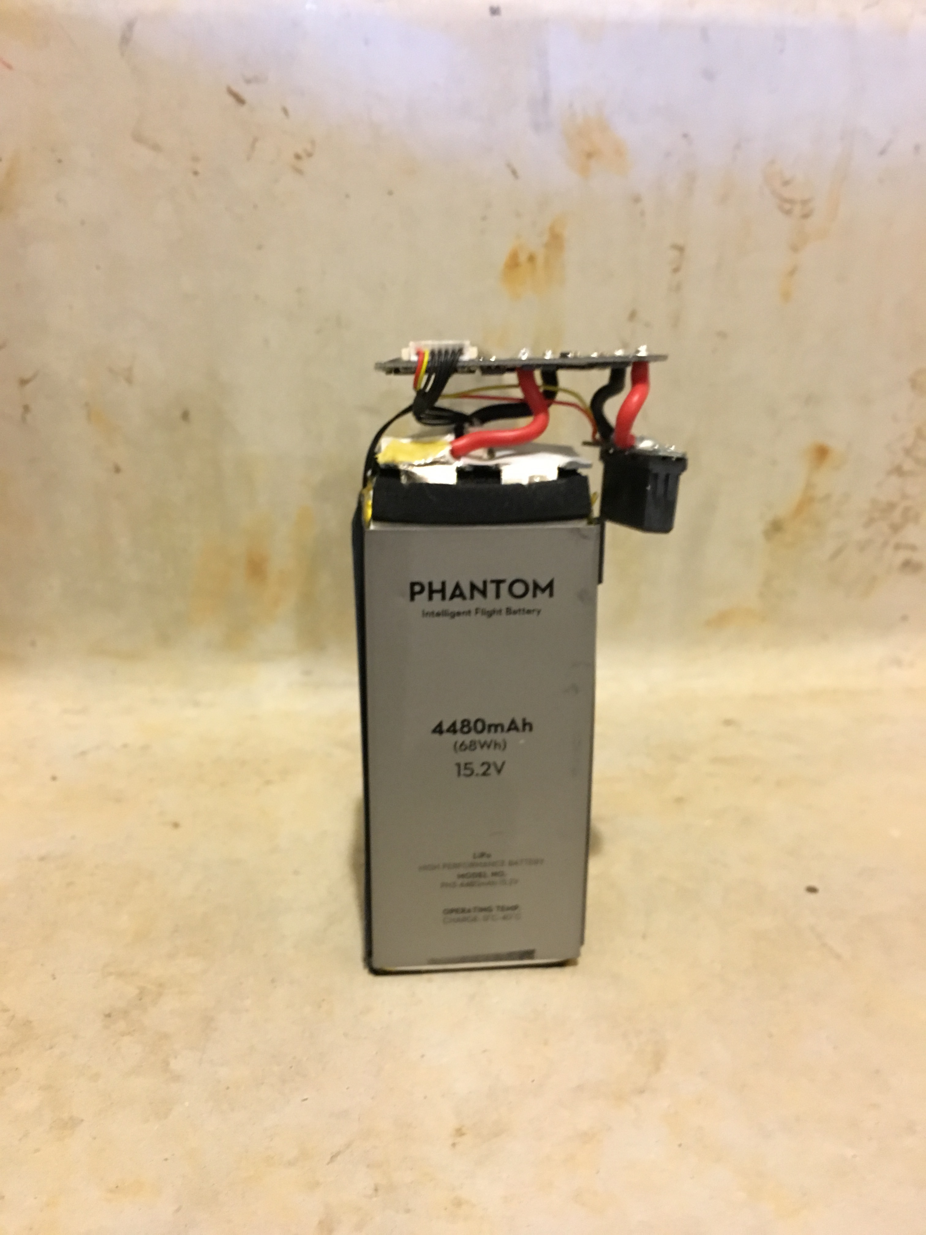

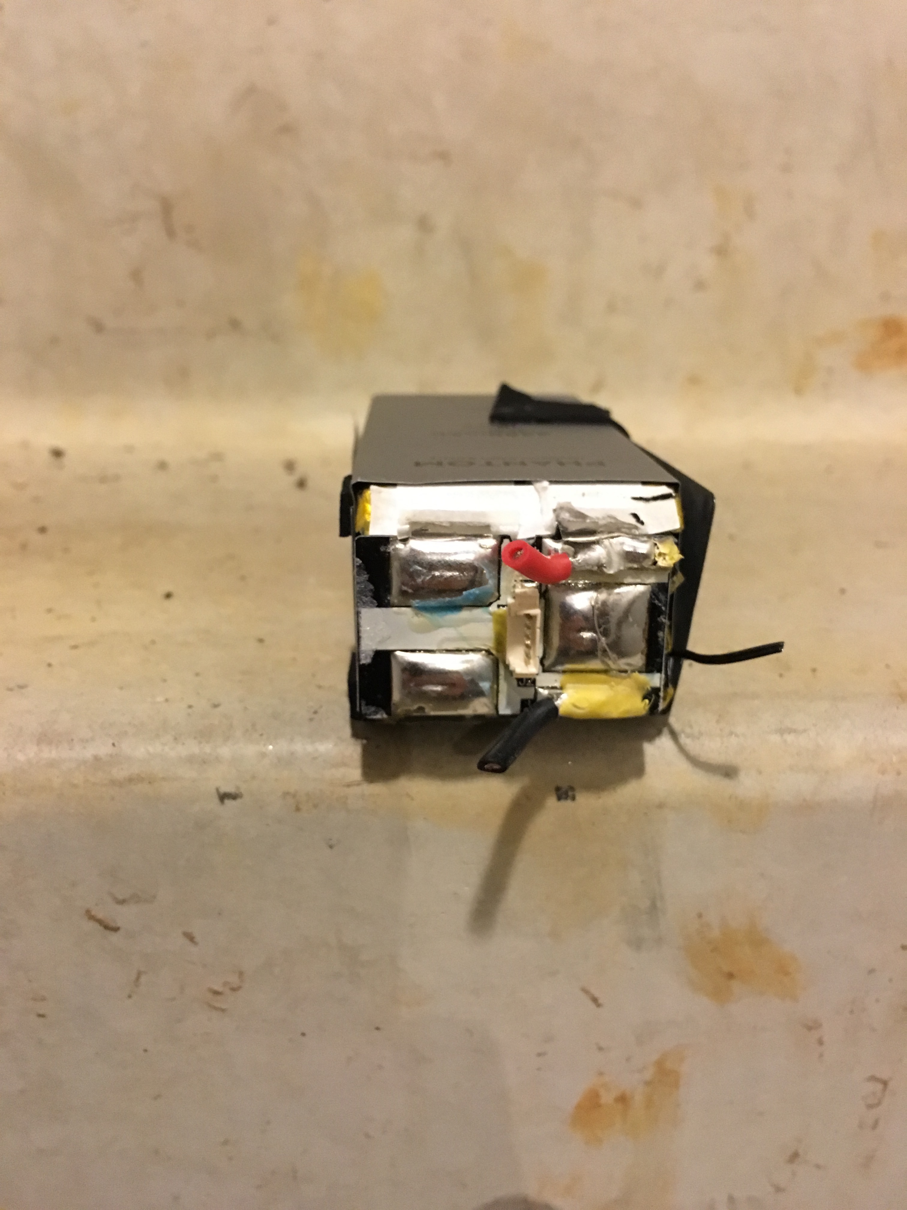

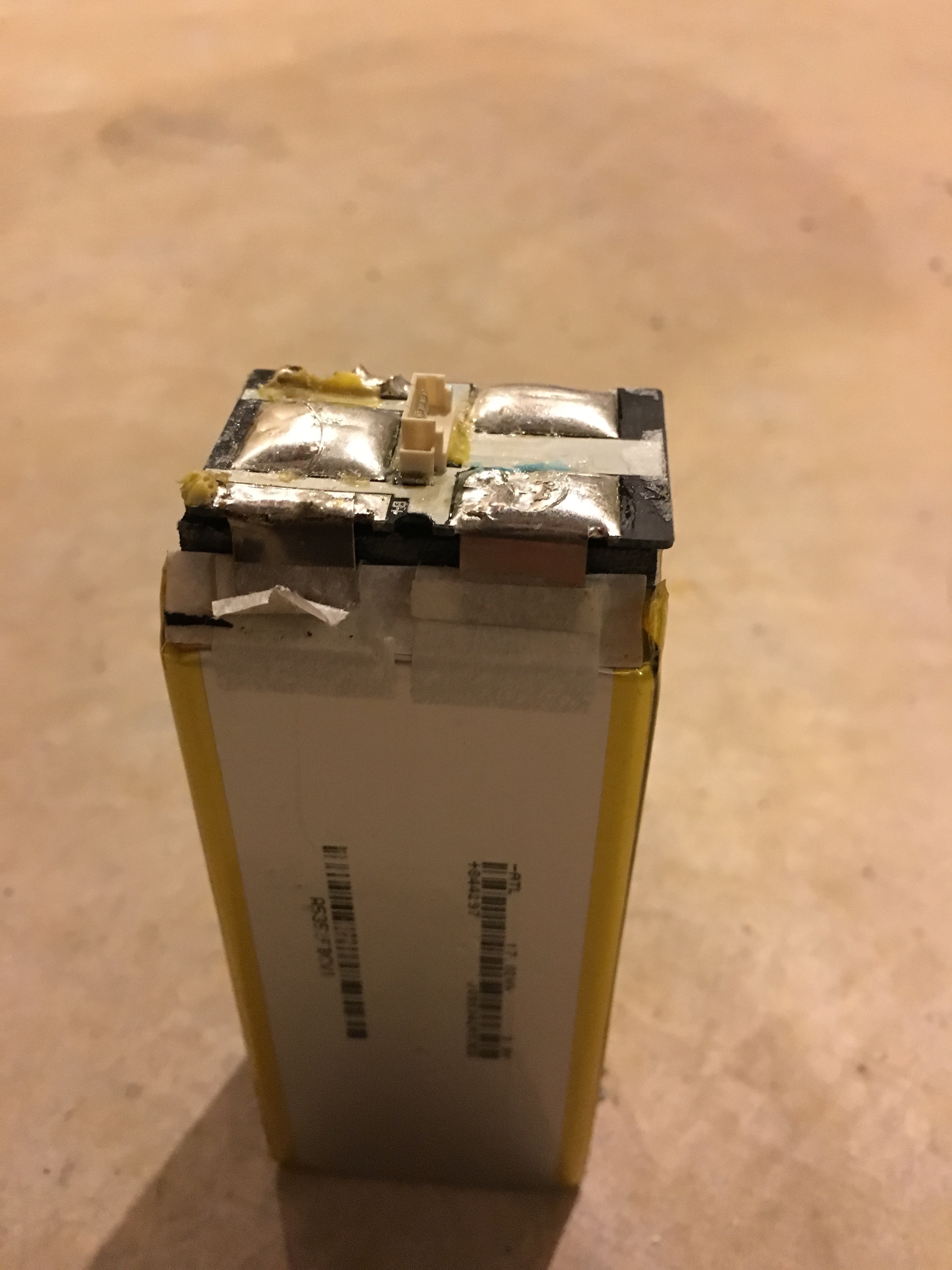

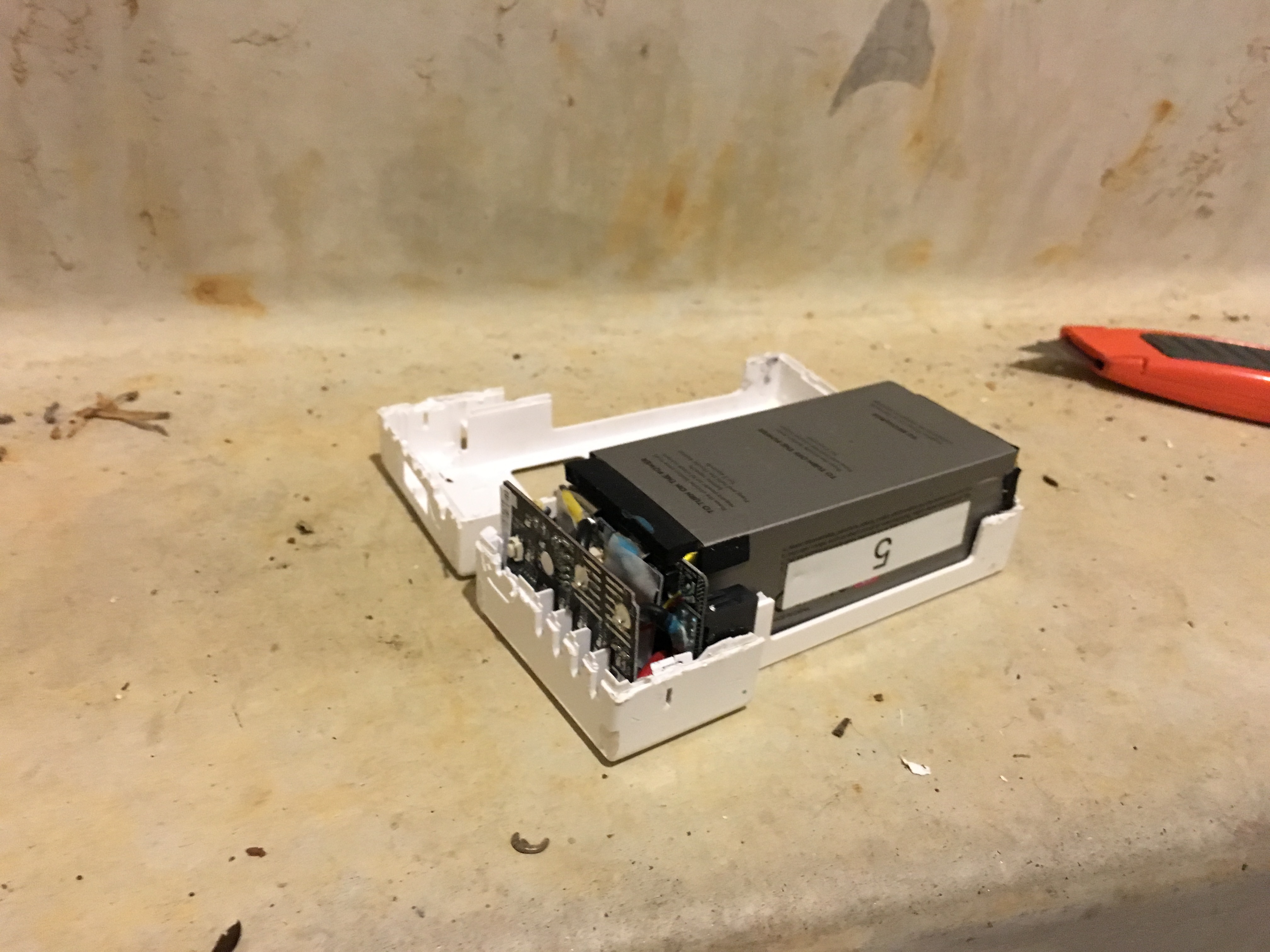

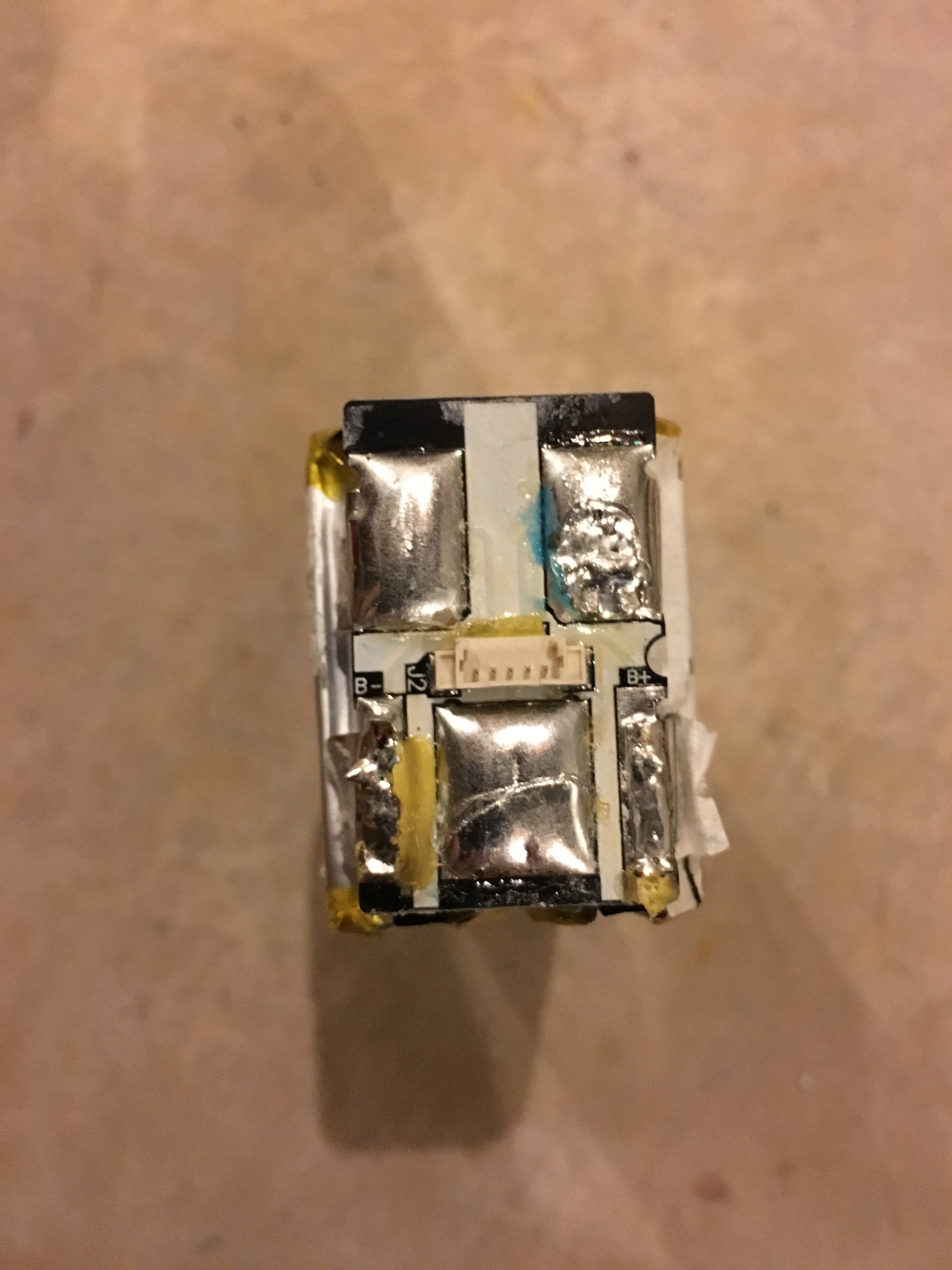

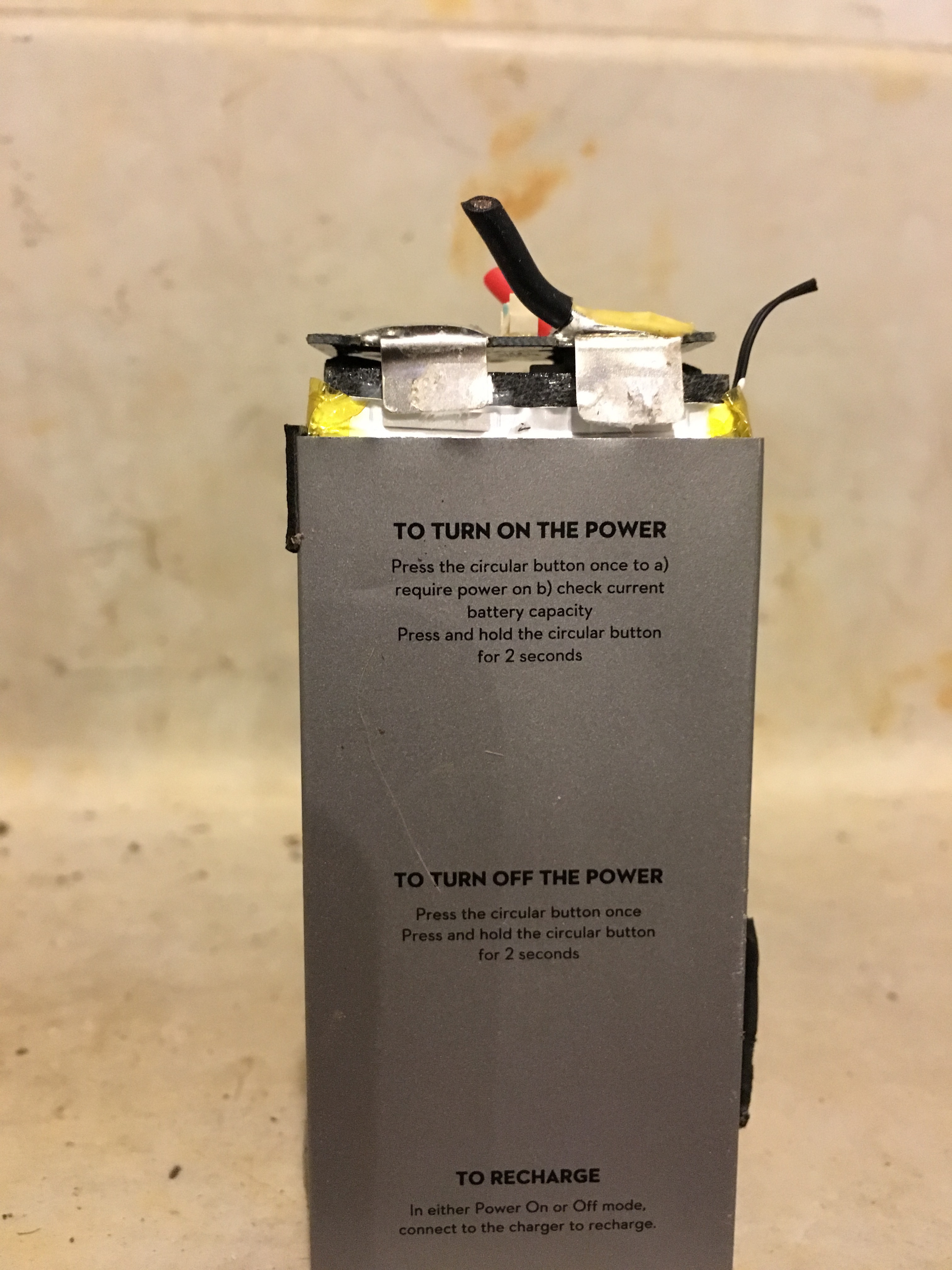

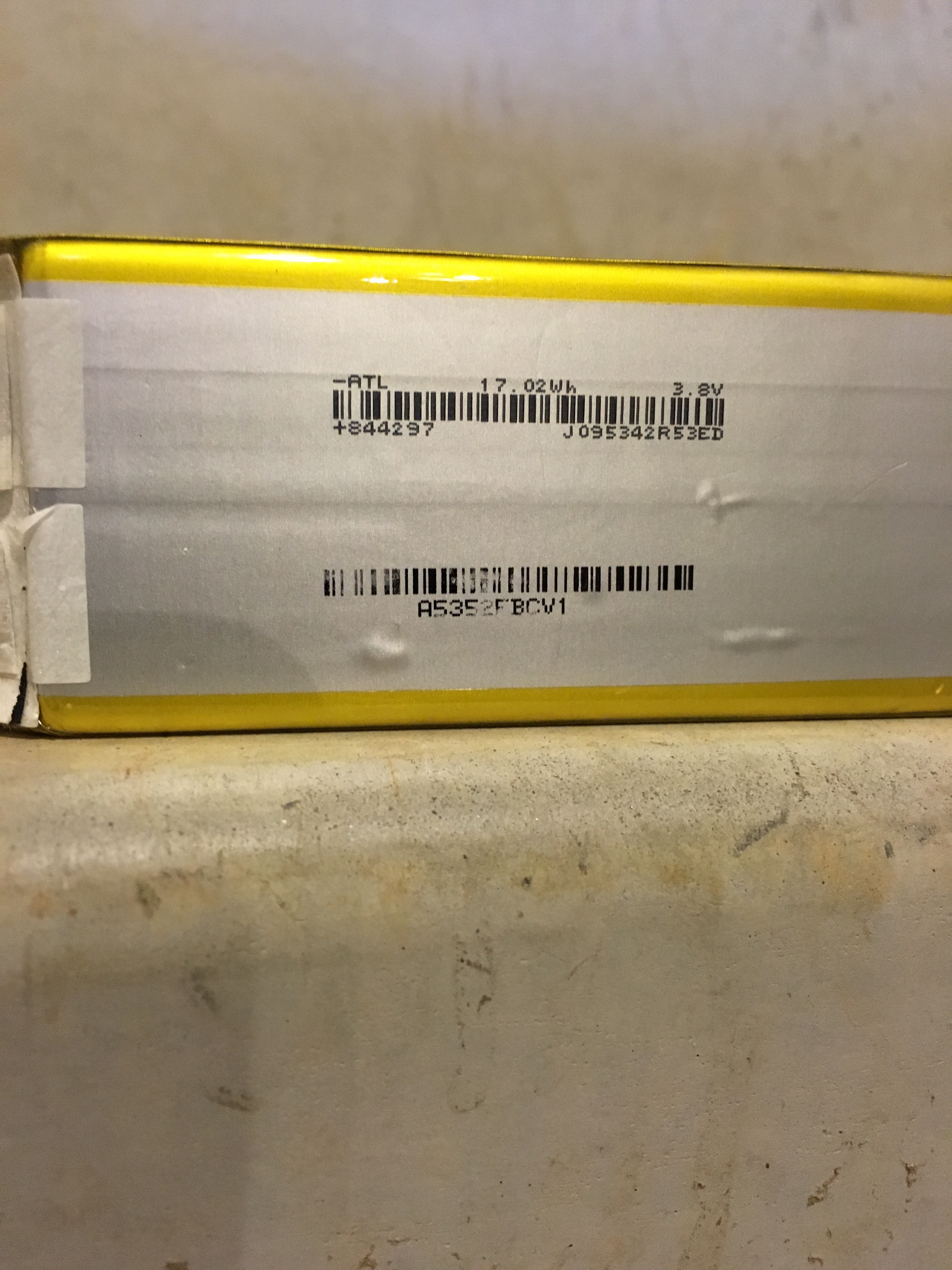

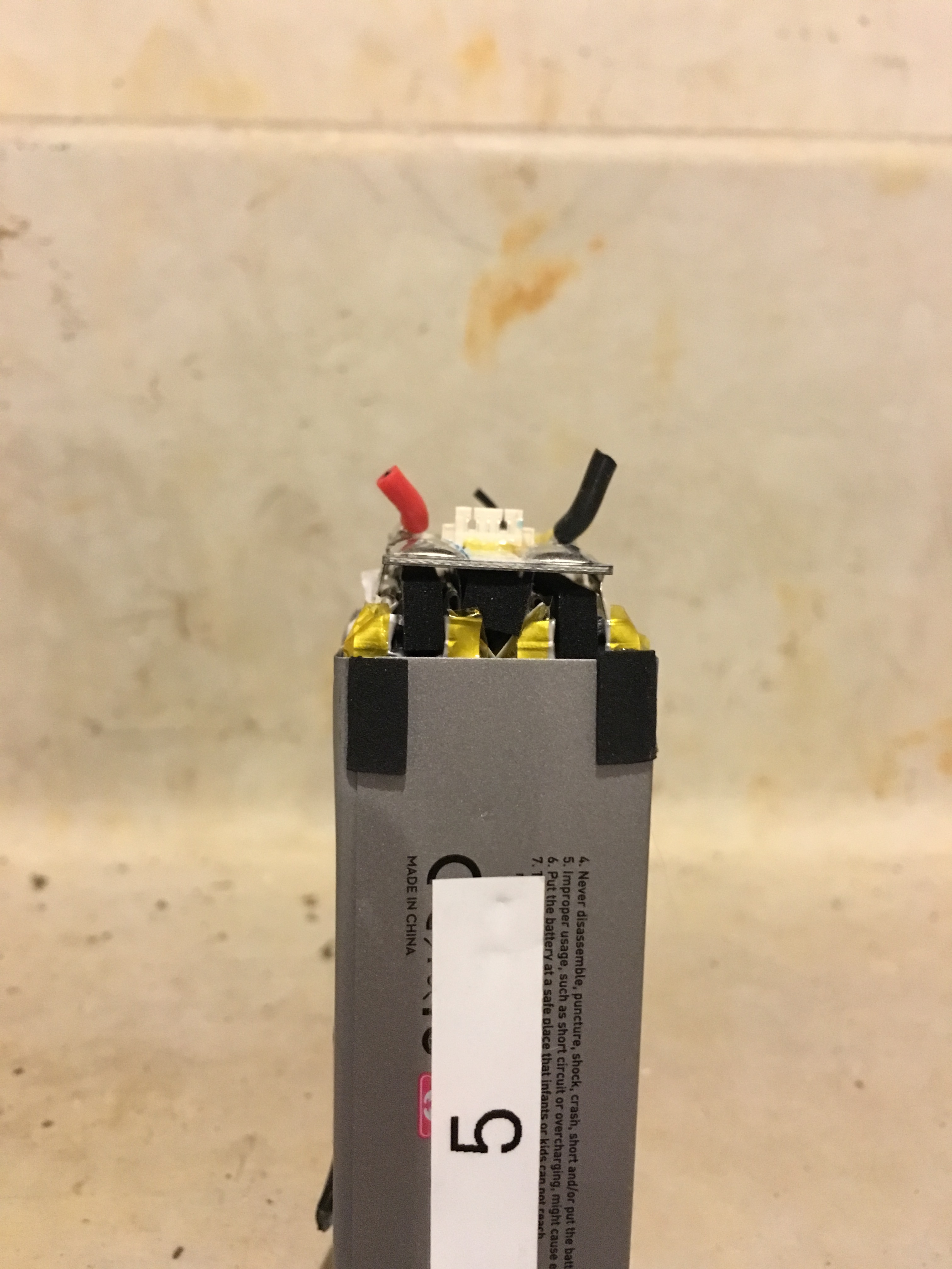

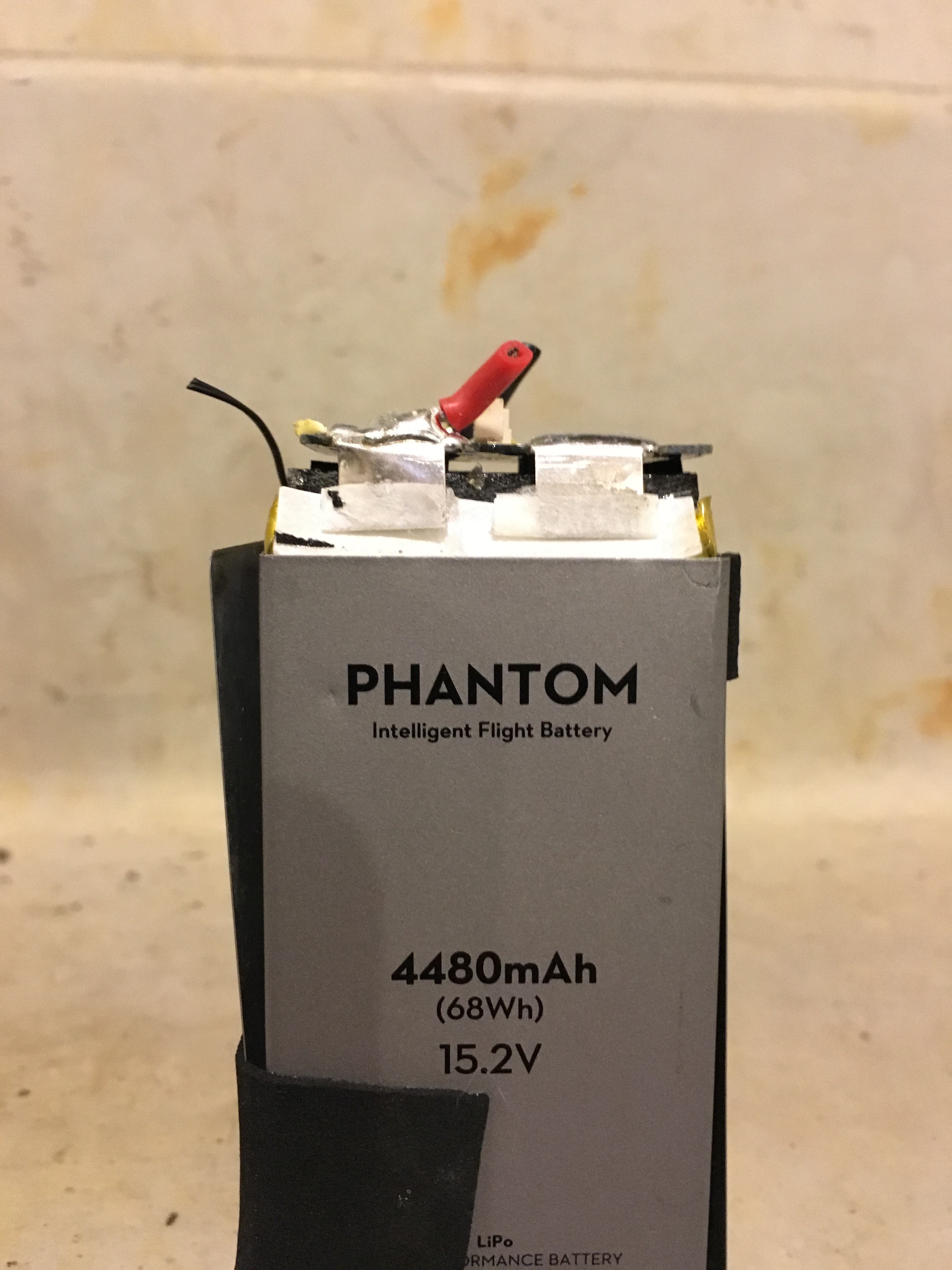

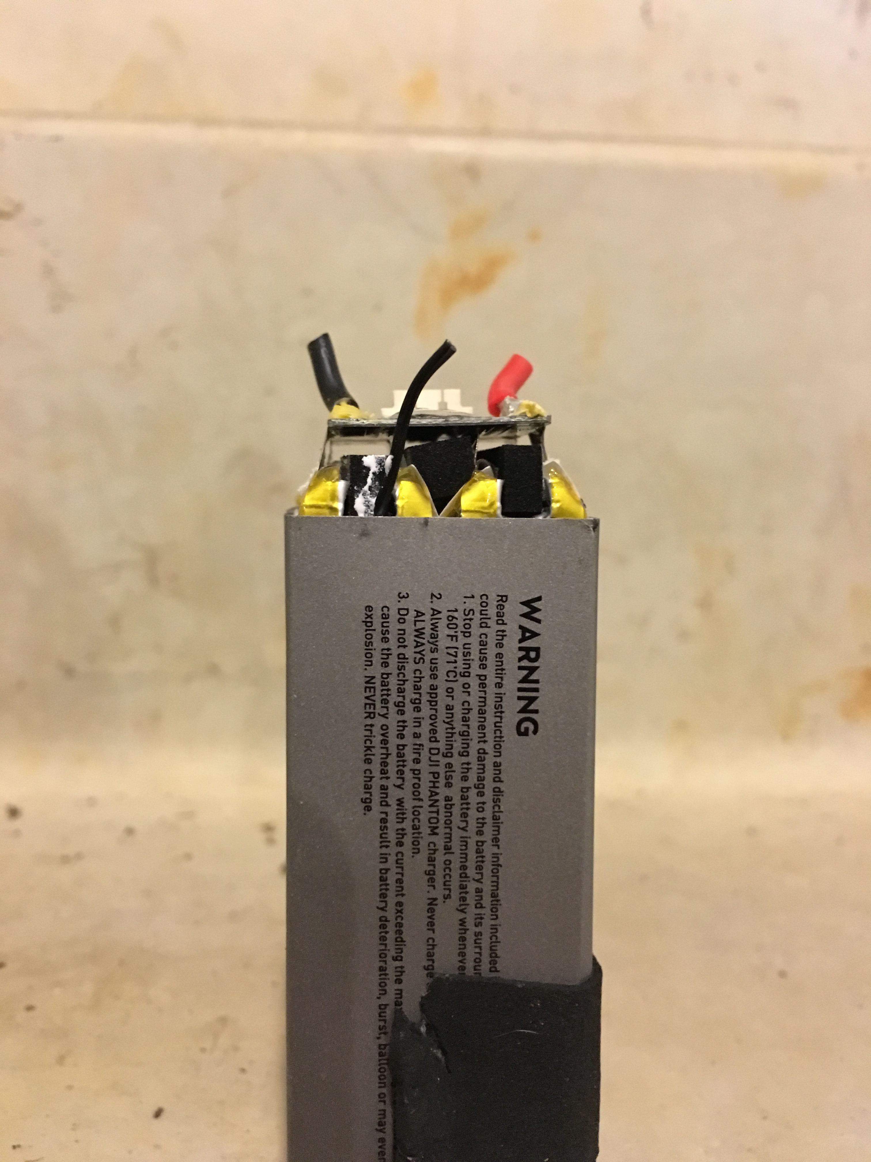

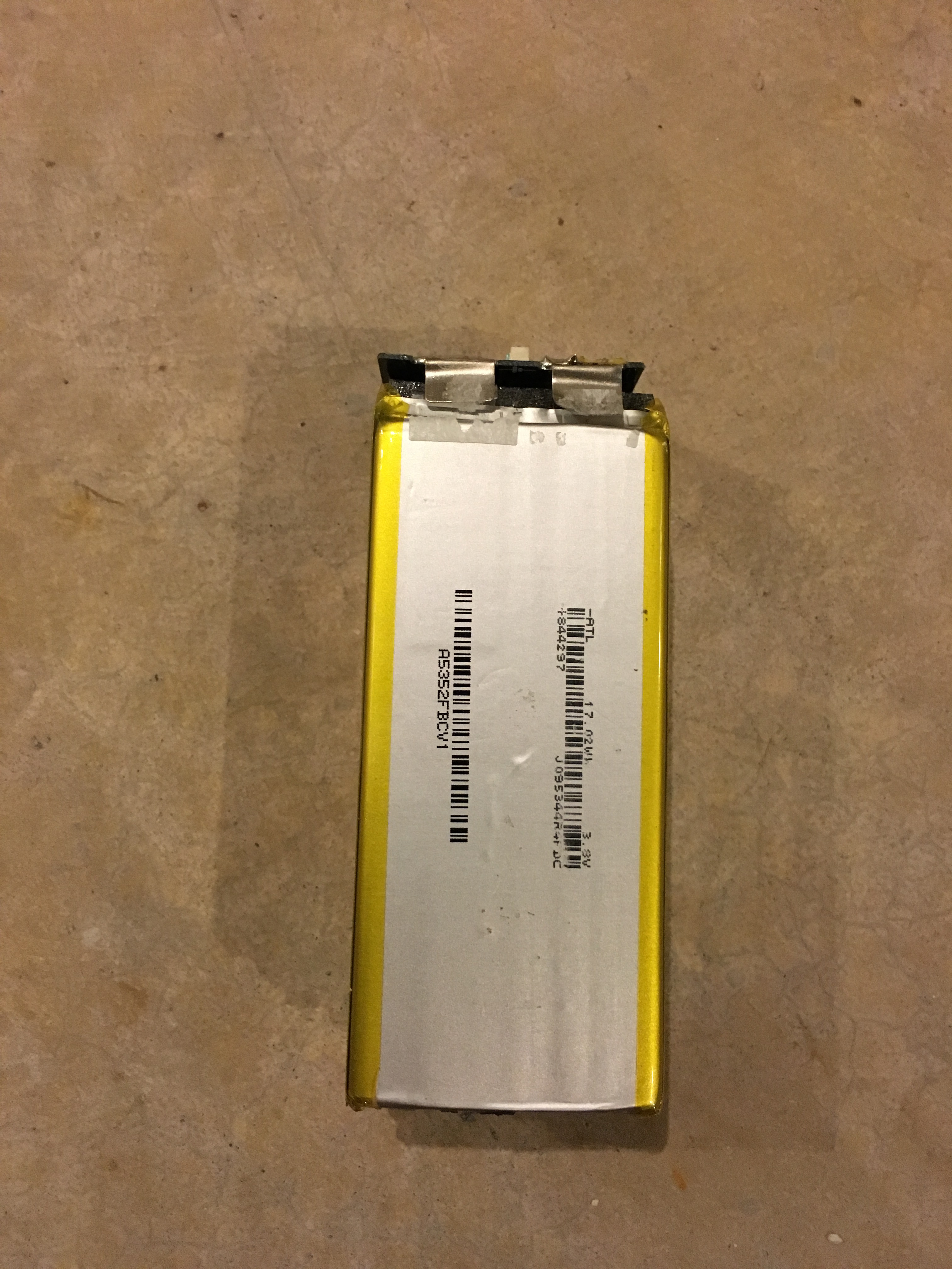

I have the battery apart and the main board with the buttons/lights off. I desoldered the leads that connect the 2 boards together. I was doing this in the stairwell of my basement exit (bilco doors) just in case all hell broke loose. I am trying to figure out if I should desolder the tabs to free the cells from the board or cut the board with a dremel. Either way has its risks. I'm leaning more towards desoldering for a cleaner job but have to be careful not to short the battery out when solder is flowing (you can see how close the connections are that need to be desoldered in the last picture). Solder sucker works well in sucking up hot solder but it is time consuming and requires heating up the solder and sucking a small drop off at a time. You have to be careful not to hold the iron on the tabs too long because the heat will transfer into the cells and damage. I'm not sure how tolerant these batteries are to that sort of thing. Here's some pics of the progress.
Yes I did as well + is on left of first cell - on right cell but the 2 tabs on other side are they pos to neg together or!! The 2tabs to the right side of the cell marked + are they both -

I would test them with a meter to be certain. Here is how they connect with balance leads as well.
