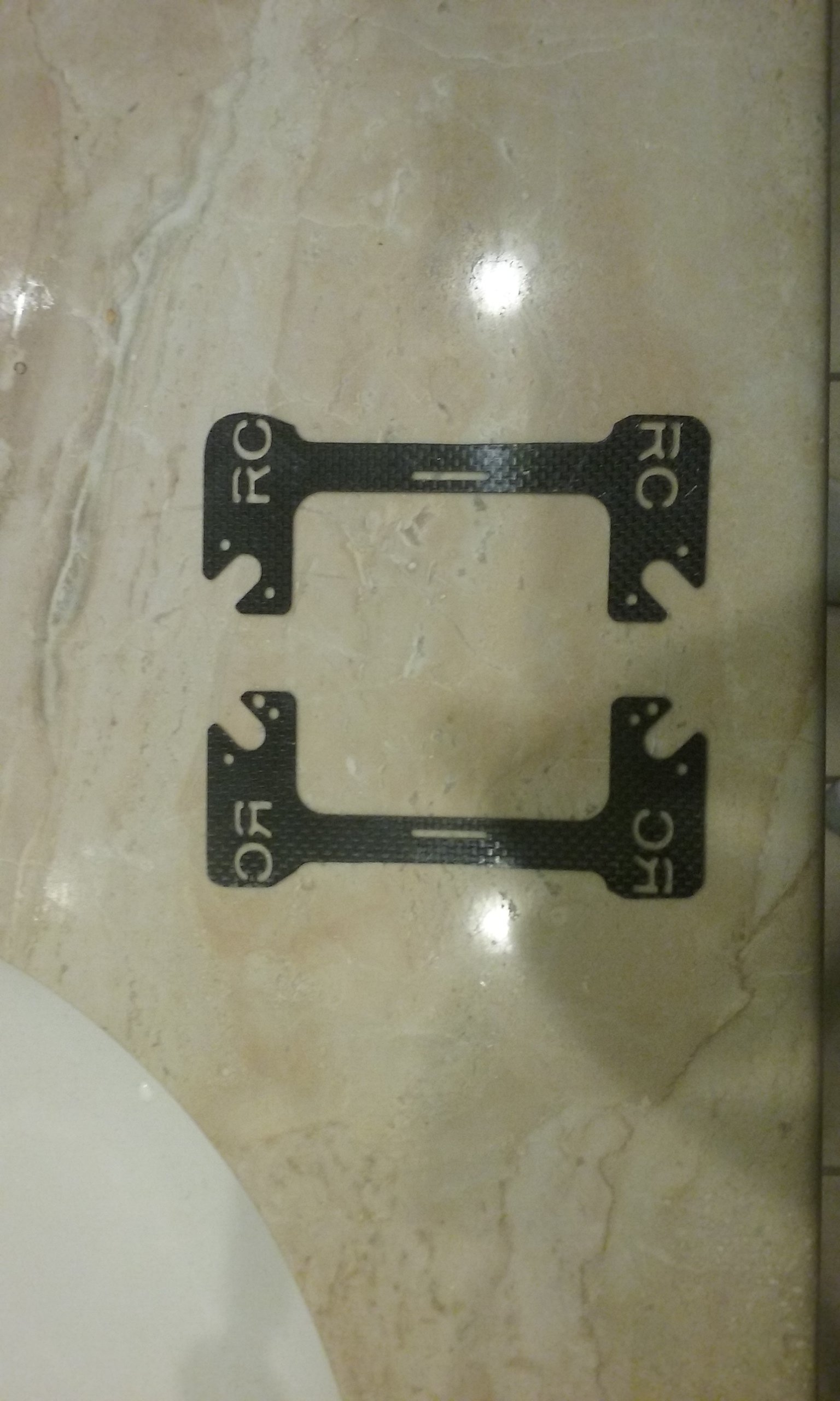

That some shots of my brackets I know most of you have these and if you want to continue to use them if you modify like mine you can run the power mod and your normal battery mod very easily. Or you can install the rails that horizon send you.

That's what the power mod looks like on my modified RC brackets they fit snug with just the strap no need 4 zip tie

Where did you get these new P3P battery plate brackets?
I need some of them!

Upon closer reading, have you modified Paul's P2 battery plates to cut them into these shapes, or did you buy them as displayed?
