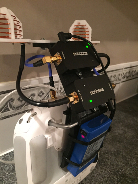

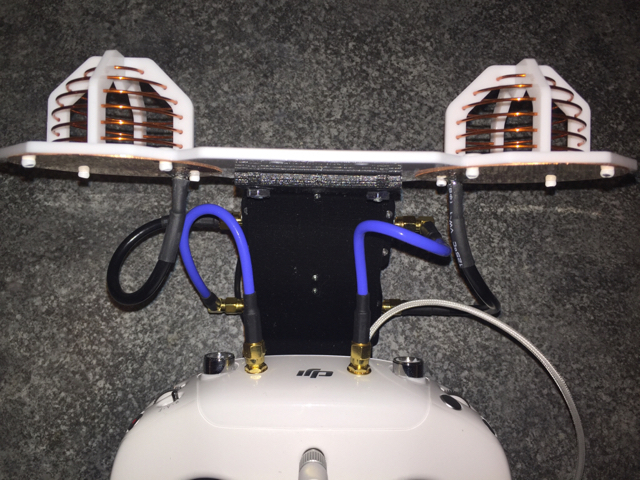

Looks like an awesome setup, but you do realize those Sunhans 2 watt amps are technically not legal by FCC rules of the 2.4Ghz band, right? The power output is way over the legal limit. Chances are you'll never be caught, but be aware of you see some government looking black suburbans nearby with freaky looking antenna's on top. Run if you do.

Lol seems like a scene right out of a movie
I live in a different jurisdiction where the FCC has no authority to micro manage every aspect of nothingness. :)

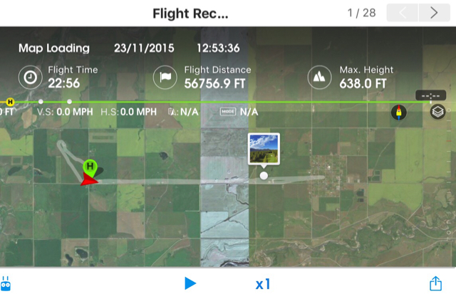

Alright.... First test flight on all 3 brand new batteries. ( new DJI p3 battery and 2 X nano tech 1600s. Not the most efficient flight with lots of ups and downs and a few turns but pretty amazing. No loss of signal at all...
What's the most guys are pushing these things distance wise round trip. I think I need to set up a way point or two and optimum throttle control some how.

Those batteries should get a little bit better after you run a few cycles through them. I noticed with mine it wasn't until the 3rd or 4th flight did I get the best results . Good luck and keep us updated !

I can add it to my spreadsheet. Old or new motors? Touch down at what batt %?

I've got the new shell with the older motors. Got mine right in the middle of the change over.
Flight time with the brand new 3 virgin batteries came in at 23 min. When their broken in, surely they will be better. The Hyperion 2400s will most definitely carry me further than the virgin nano tech 1600s
