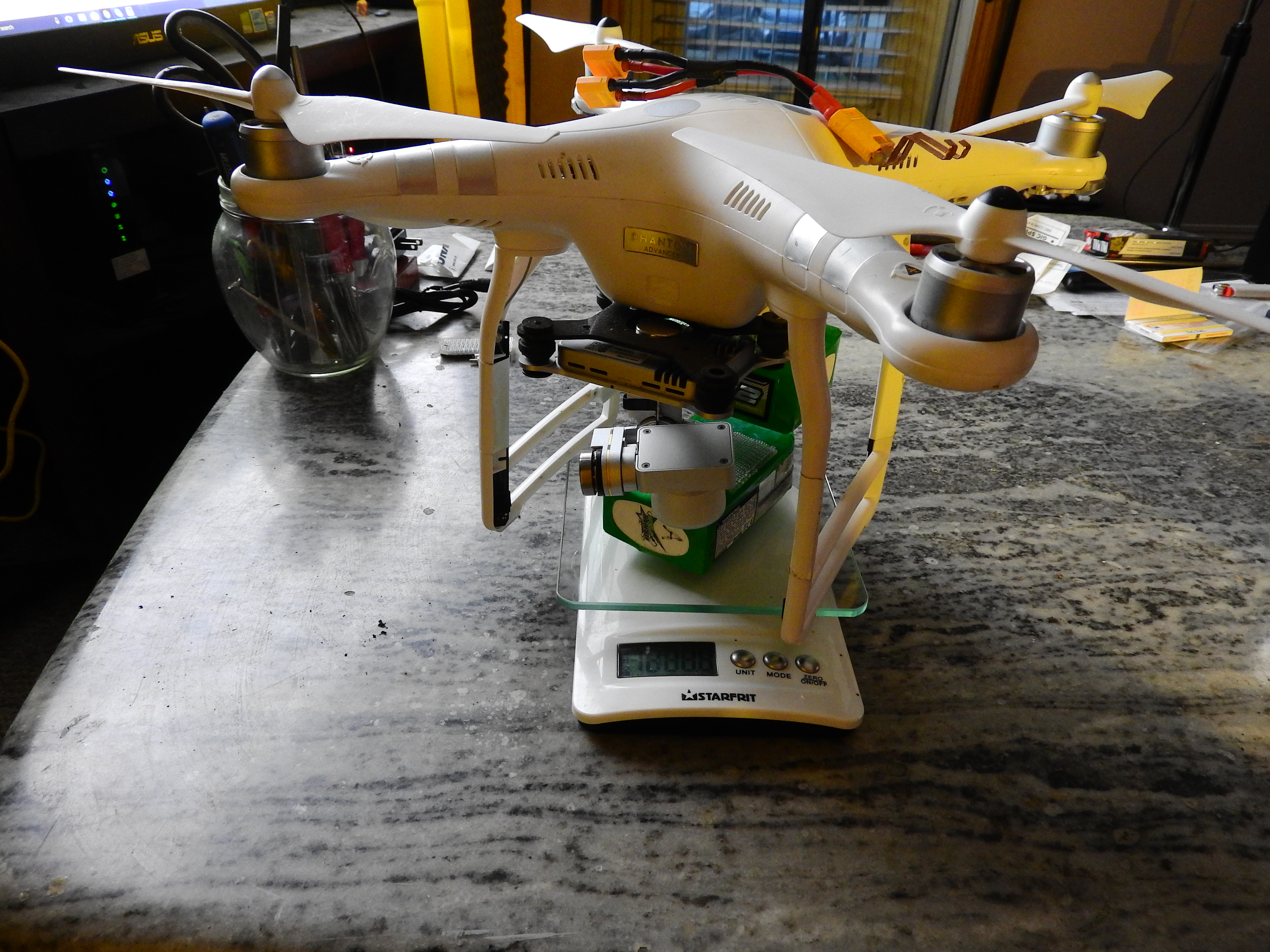

my bird with cam AUW is 2215 with 2x52's and battery clip View attachment 82092
with the 2 x 5.2 mine is 2016 with the camera mod and the vps off...
Also id like to say i see you only use the clip and I only tested it once but i took the lead out of the leg and only used the clip to run both of my batteries and i didn't get as good of a time with the 2 x 5.2's on the second flight by a few minutes so i added the lead back to the main board...I'm not positive because i only tested it once ....It seemed like to much juice to suck through only one straw...:)

Thanks for weighing it because now we can see we gain about 1.8sec per gram lost....
Mine and yours with the same batteries attached
46min 2015grams
40min 2215grams
360sec gain for 200grams lost
360sec / 200 =1.8 sec per gram.
I know there are other variables and it's a small sample size but still not bad to see it..
also being ours weigh pretty much the same with different batteries we can do this too
mine 47min 2215 grams (15grams off for simplicity)
6600 + 8000 14600 added mAh
yours 40min 2215 grams
5200 + 5200 10400 added mAh
diff = 4200mah and 7min (420sec)
7min (420sec) gain for 4200 mAh added
=0.1 sec per mAh
doesn't seem like much but it adds up...
