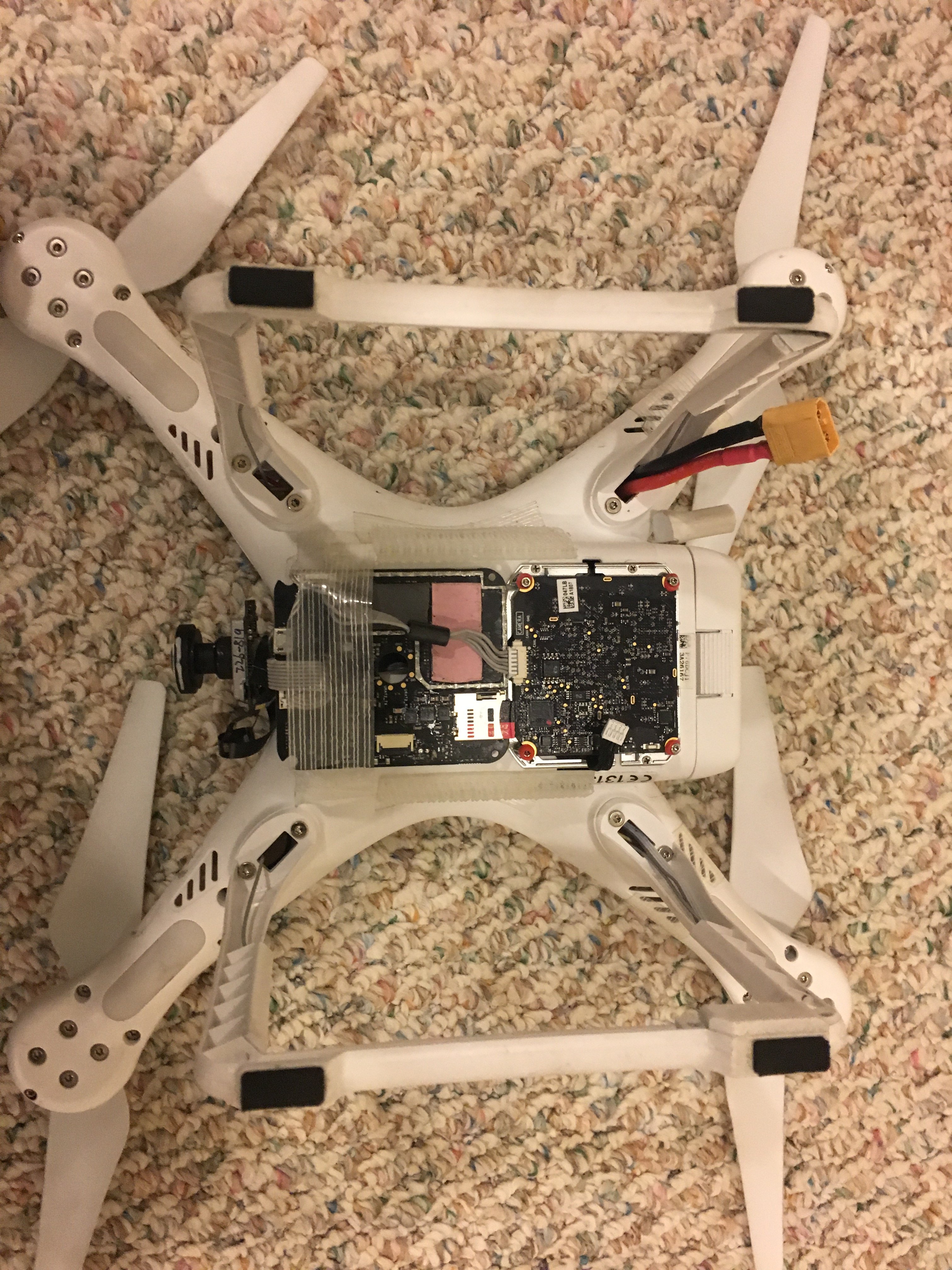

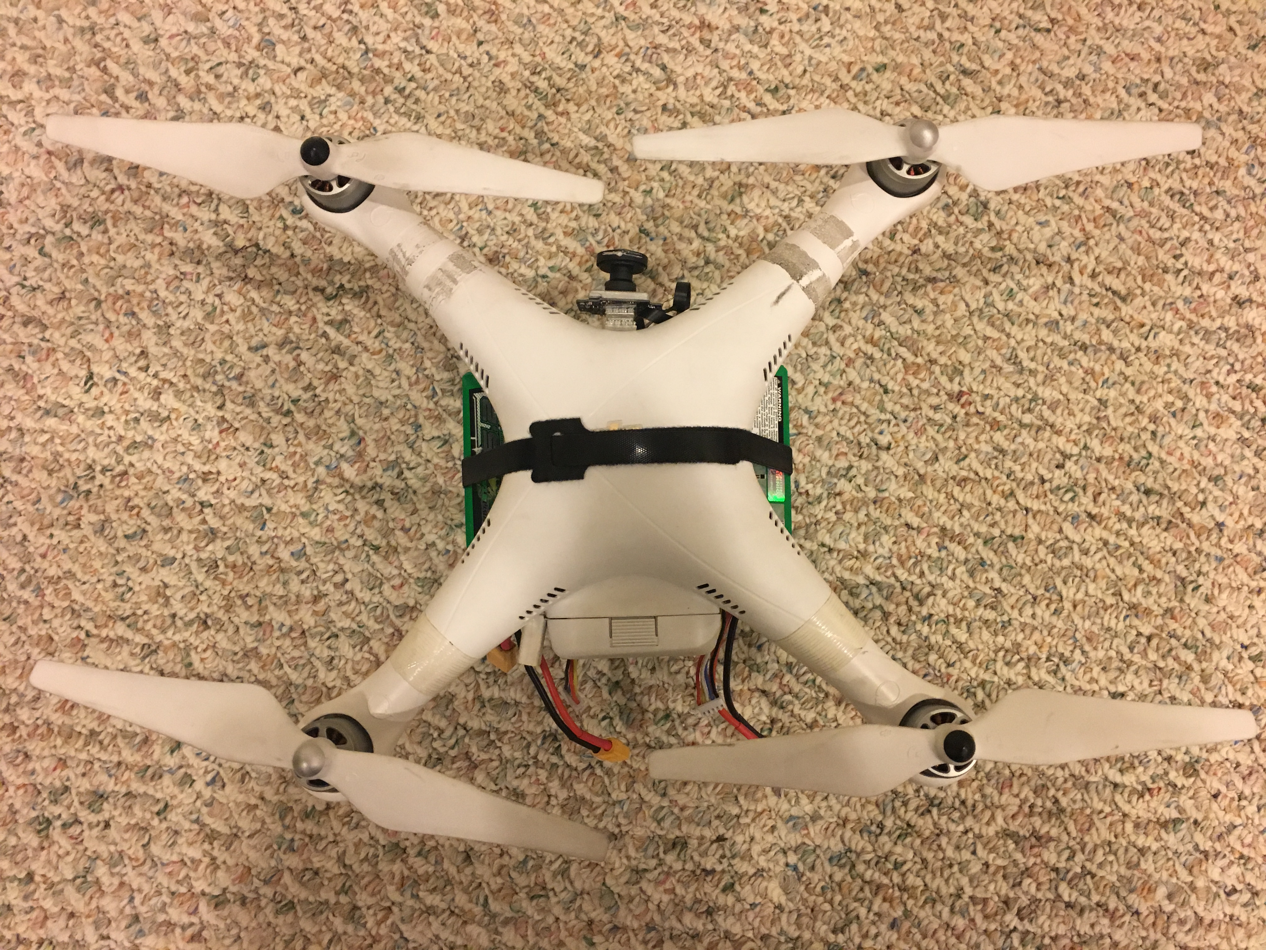

I opened the P3A up and ran a + and - cable (XT60) to the mainboard leads. Batteries are mounted underneath the VPS module (turned off).

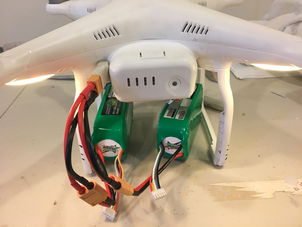

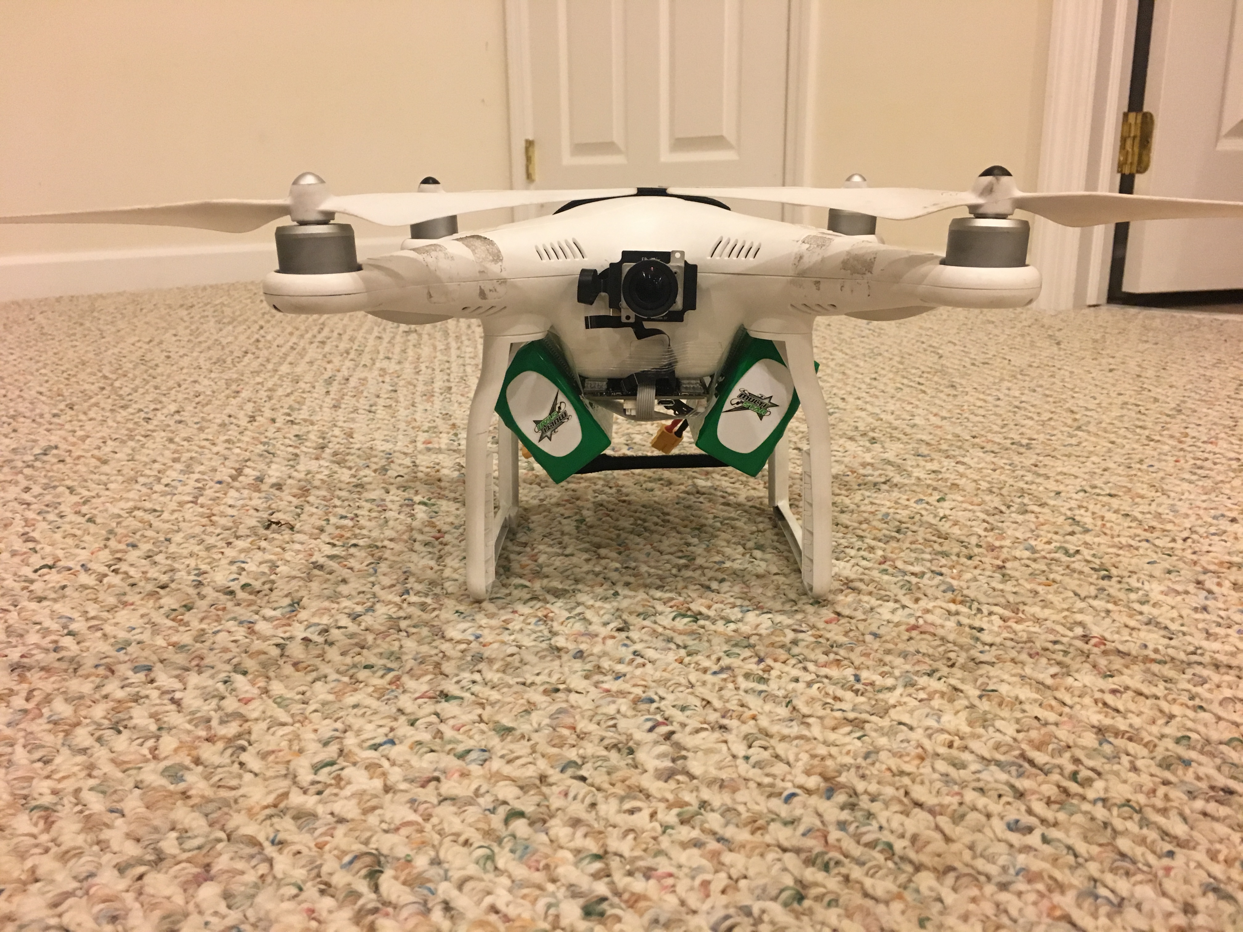

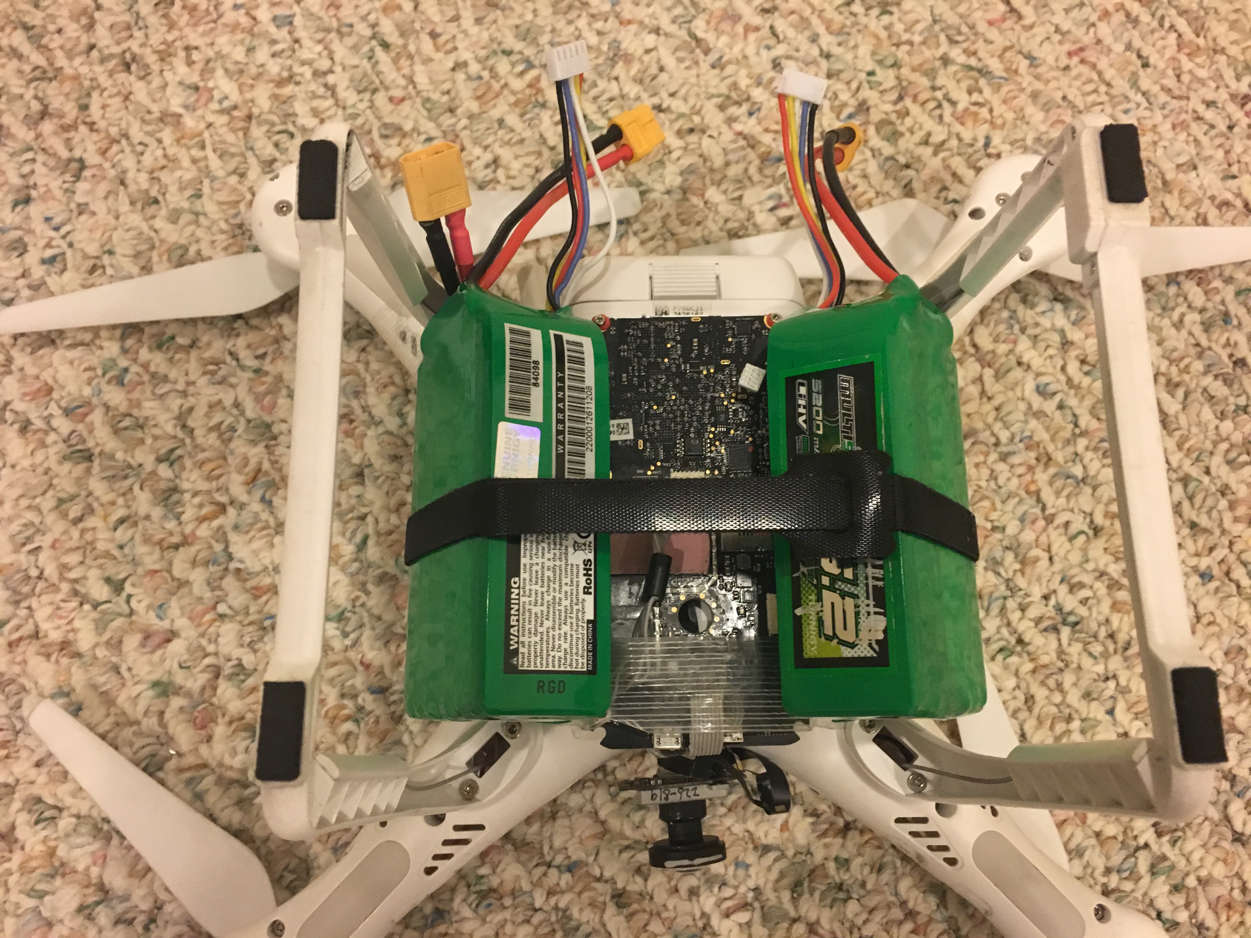

I would say I found a pretty good setup following Digdat0's lead with a camera mod and 2 - MS5200's...I wouldn't say I flew efficiently at all and still got pretty good numbers…Flying at high elevations to clear mountains and keep signal and then when I came back to finish the battery I flew in circles in the radius of about a mile or so...If I could only find a flat place for 14 miles.
The first pic is 30min to 50% and if I can call any of this flight efficient this would have been where that ends. The second is 46min to 10%... I'll post pics of the bird a little later...

I would say I found a pretty good setup following Digdat0's lead with a camera mod and 2 - MS5200's...I wouldn't say I flew efficiently at all and still got pretty good numbers…Flying at high elevations to clear mountains and keep signal and then when I came back to finish the battery I flew in circles in the radius of about a mile or so...If I could only find a flat place for 14 miles. The first pic is 30min to 50% and if I can call any of this flight efficient this would have been where that ends. The second is 46min to 10%... I'll post pics of the bird a little later...
chazz, dang man! thats a heck of a flight, 46min to 10% is amazing I think you would get better results in a straight line. Thats easily a 70k flight with the modcam and good conditions. A guy on FB is flying 2x5200 lihv and no cam and he hit 75k recently. I'm getting close/similar to that with the 5200+6600 wrapped like baked potatoes, I think i may need to pickup another 5200 and run two of those!

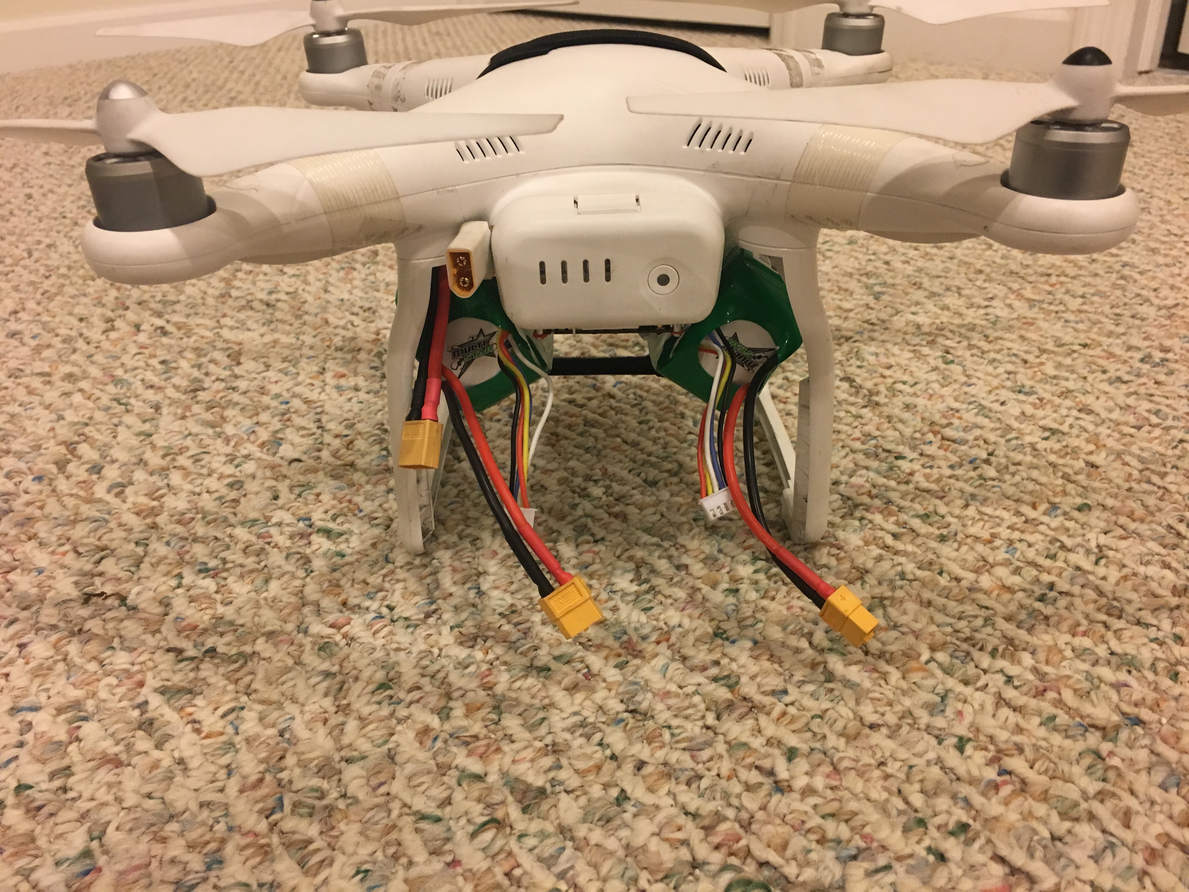

Could I see the power-connected pictures?

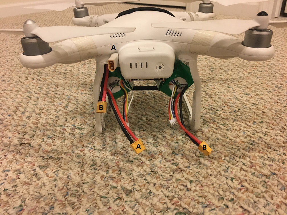

Hey Lee do you mean you want to see the batteries plugged in? if so i just changed my bottom shell last night and i took out the lead going to the main board that runs through the leg so i cant show you this but i marked them on the pic where I plugged them in...A to A and B to B...
The new way I'm going to try is like you see in the bottom pic with the parallel lead connecting the two batts. If this doesn't work and drains the batteries unevenly because of added resistance i will add the lead to the main board again...I'm waiting for Dual Lock to come in to attach the batteries is why they're not attached....
The new way I'm going to try is like you see in the bottom pic with the parallel lead connecting the two batts. If this doesn't work and drains the batteries unevenly because of added resistance i will add the lead to the main board again...I'm waiting for Dual Lock to come in to attach the batteries is why they're not attached.... View attachment 80694 View attachment 80695
I easily understand with your pic & explanation
Thanks chazz ^^
