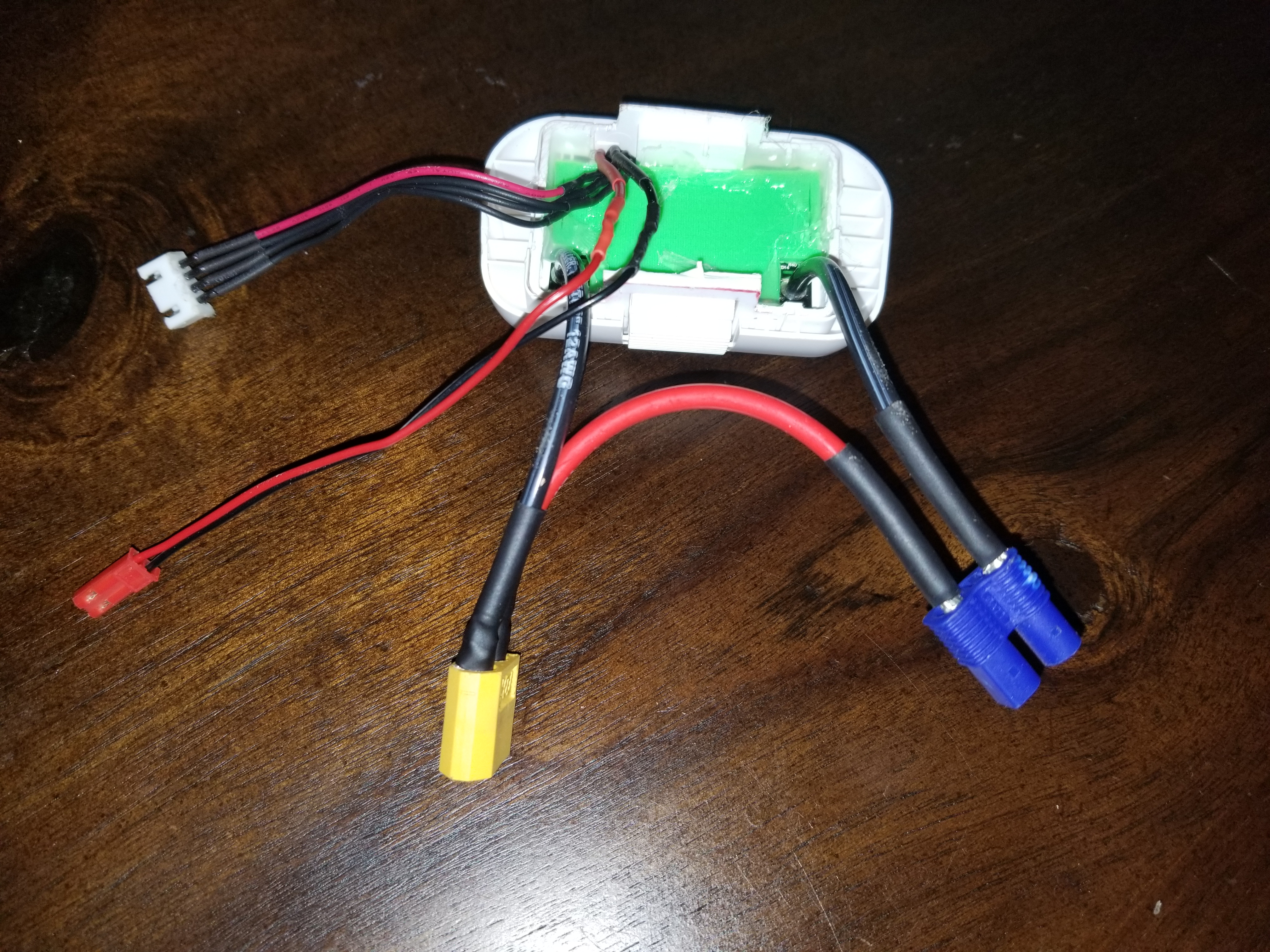

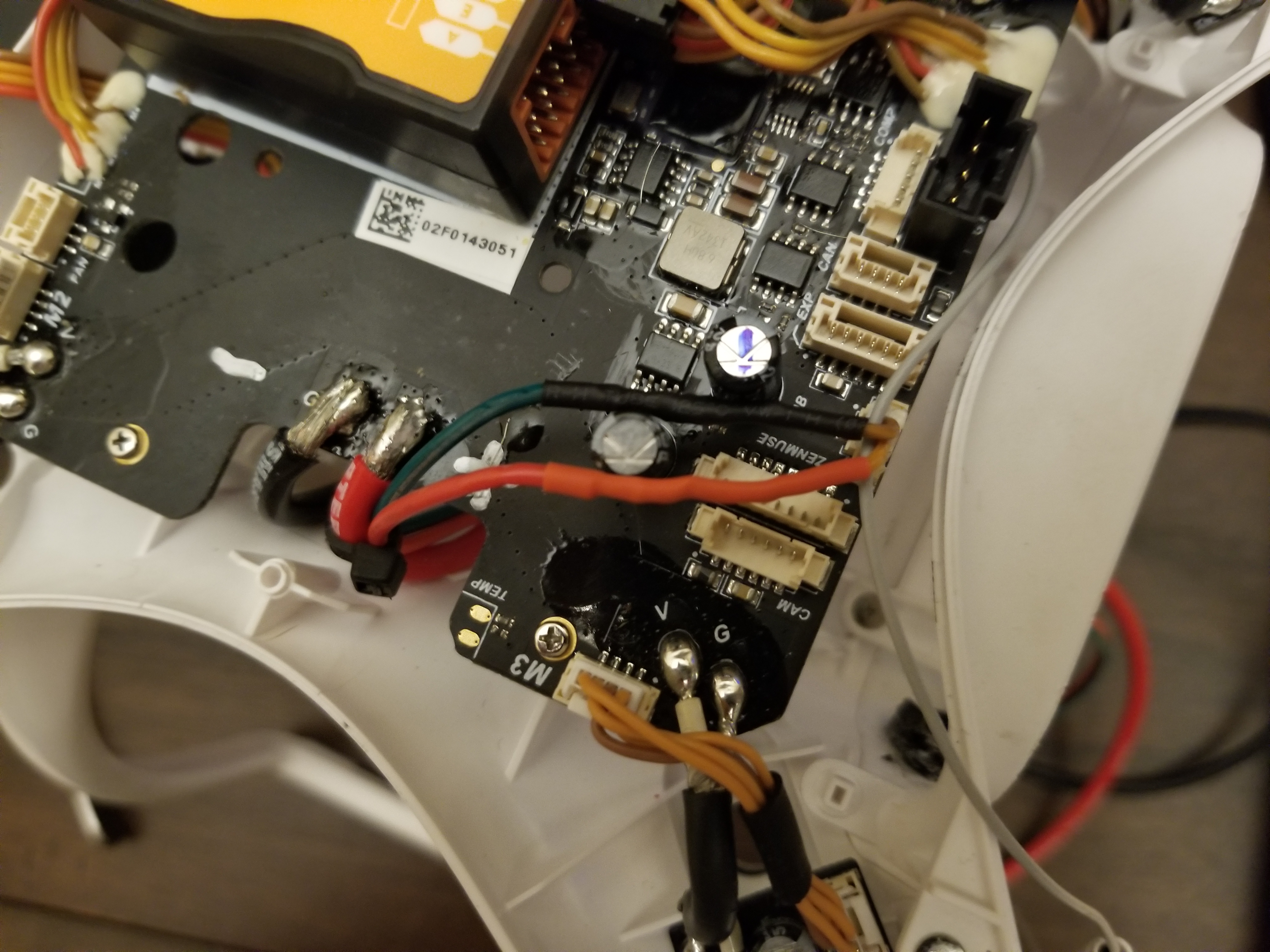

What all do you loose other than the ability to have a power button if you hook up a standard Lipo Battery directly to the main board? I have already made this Mod with the smart board but I want to go a step further and come up with a way to eliminate the smart board all together. There are too many issues with tying to integrate Smart Board with a standard Lipo like inaccurate battery levels. So I want to try to come up with a new method of completely doing away with the smart board but need to know exactly what is going to be lost in doing so.

What all do you loose other than the ability to have a power button if you hook up a standard Lipo Battery directly to the main board? I have already made this Mod with the smart board but I want to go a step further and come up with a way to eliminate the smart board all together. There are too many issues with tying to integrate Smart Board with a standard Lipo like inaccurate battery levels. So I want to try to come up with a new method of completely doing away with the smart board but need to know exactly what is going to be lost in doing so.View attachment 94490 View attachment 94491 View attachment 94492 View attachment 94493
So did you try just plugging in a lipo? How'd it go?

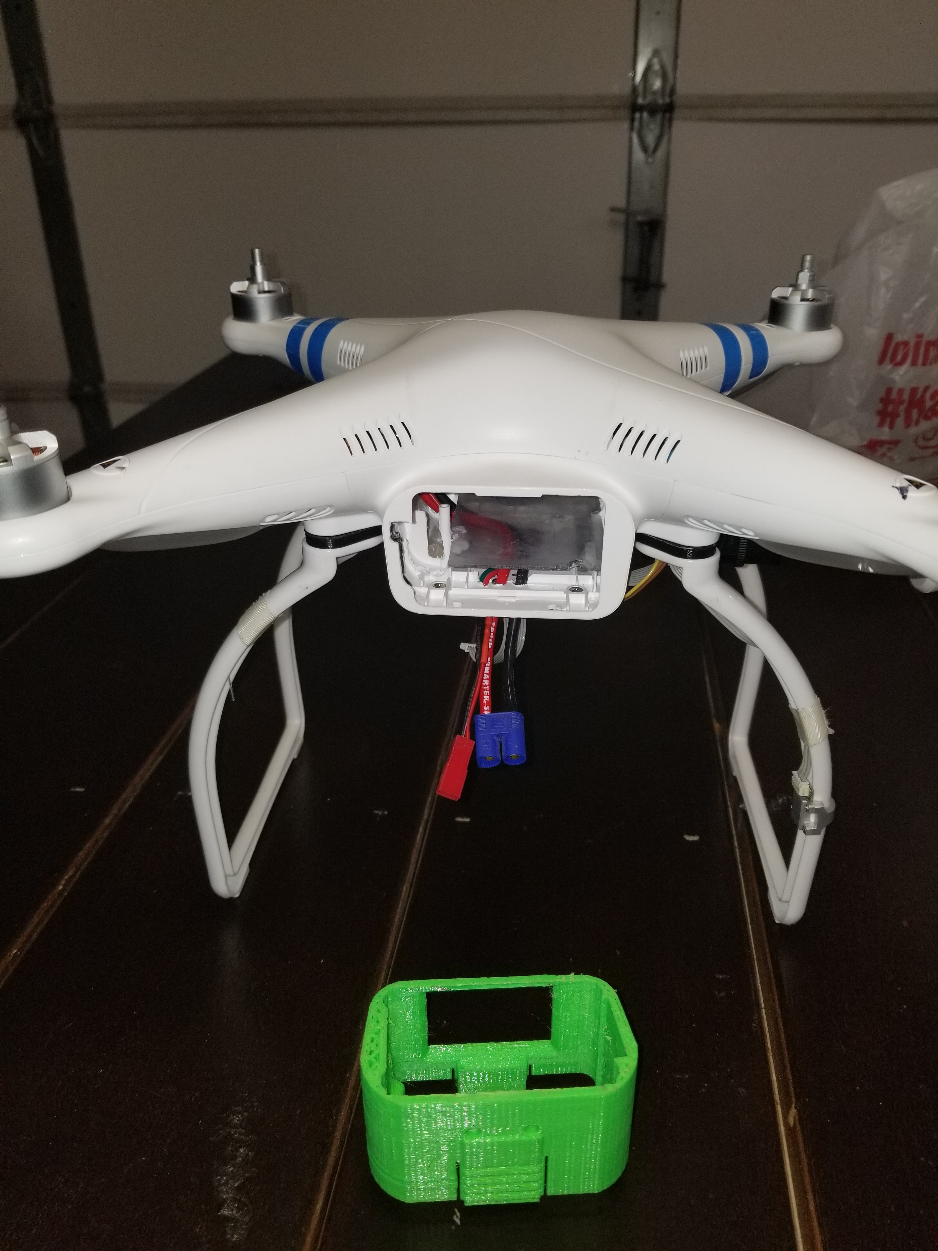

Hey guys. I've been going through this thread(there is a lot to cover. I wish I could view more posts per page...)and there is a lot of information to process.
Using the original post's method to mod the battery, what, in you all' humble opinion, is the best thing to hook up to it?? Best bang for buck, so to speak.
Right now I plan to mod an existing P3 battery, and attach whatever you guys say to attach to it. Probably two additional batteries. One on each side for balance and what not. I have a **** ton of zip ties so I plan to zip them to the outside of the landing gear on each side, unless there is a better opinion.
Thanks in advance for anyone who takes the time to provide some guidance.

theres an option in your user prefs on how many posts to display per page, i think default is 50 and you can move it up to 200.
For the best way, i personally think either the direct solder mod, or the battery clip. Two reasons, 1) if you do modded battery mod it ties you to that battery and that battery alone, doesn't leave flexibility if you have more batteries (you gotta mod them all) and 2) you end up with more runs on that stock battery, rather than being able to use multiple and spreading the love out .. the batteries lose mah/ efficiency over time, so thats not desired. The direct solder mod costs the price of an xt60 power connector and your time. The clip is a bit more, unless you make it yourself. Clip is super easy to use as well. I always do the direct power line, just cause its cheap and easy for me (taking the p3 shell can be a pita though).
Saddle bags works well, one on each side. You can also ditch the vps or disable it (i used to remove the vps unit itself) and strap a battery on that as well if you wanna run a single, a MS 5200 4s fits well under there :)
I would stay away from zip ties, I would use tape .. electrical tape is great. Wrap it a few times, boom your done. Zip ties, I'd be afraid wouldn't hold as well as wanted if things got bumpy/hard flying, etc. Good luck man, the p3 is a fun bird to fly, especially with some batteries. Your gonna want an antenna next!

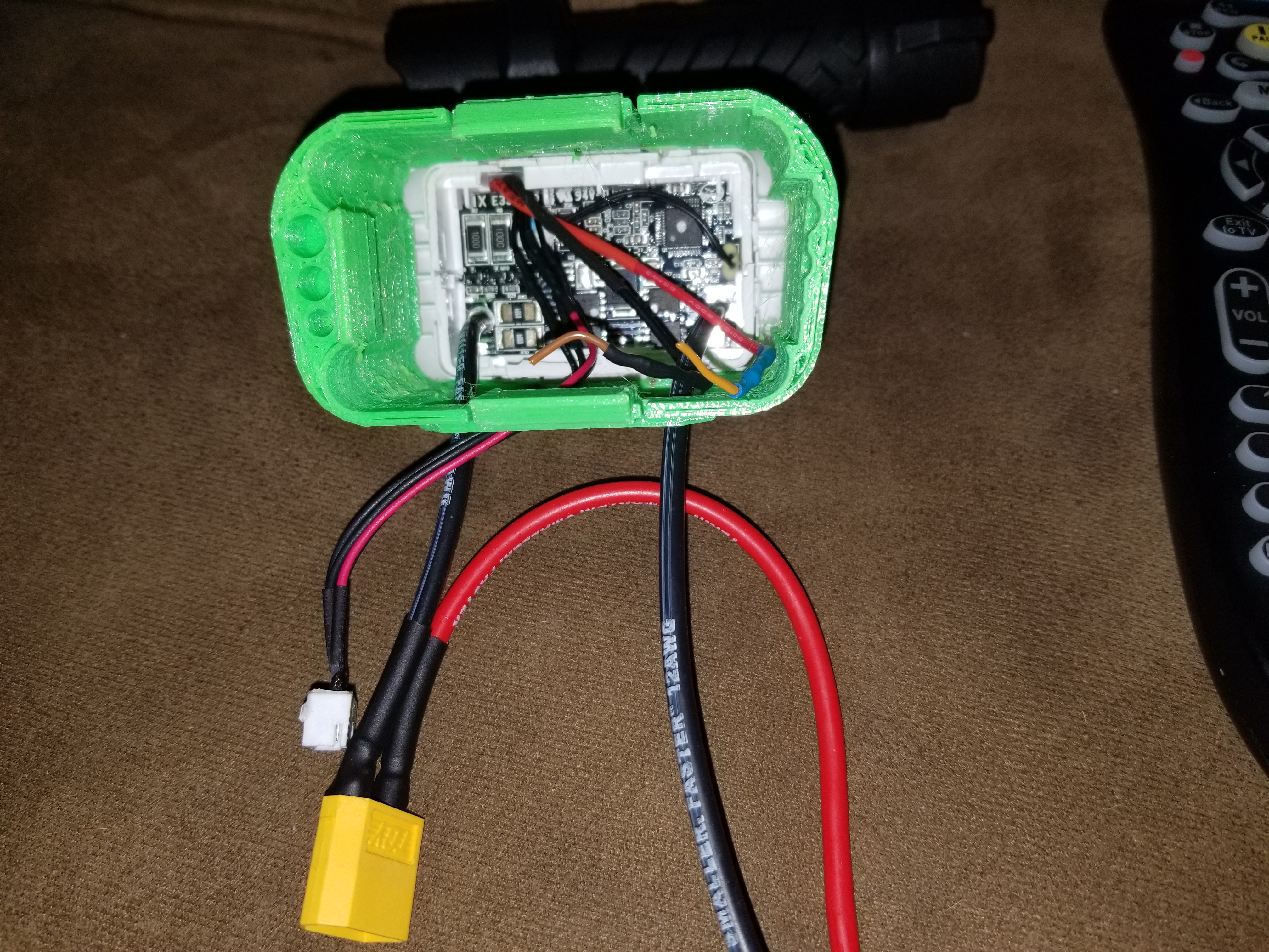

can someone point me out to where I can find the wiring diagram of the balance cable coming off the the original phantom 3 battery board? I'd like to use a 4s lipo to replace dead batteries like pic
