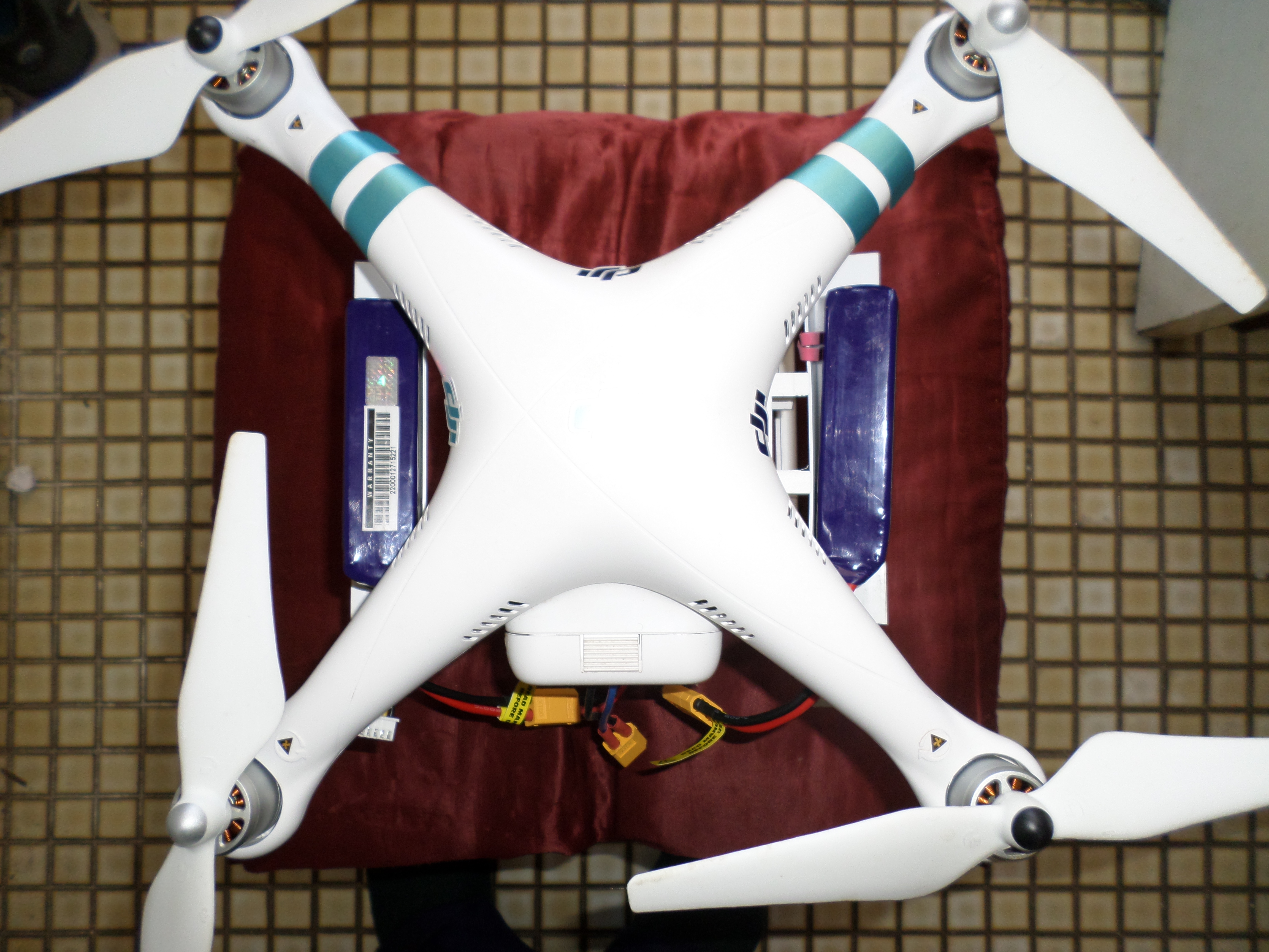

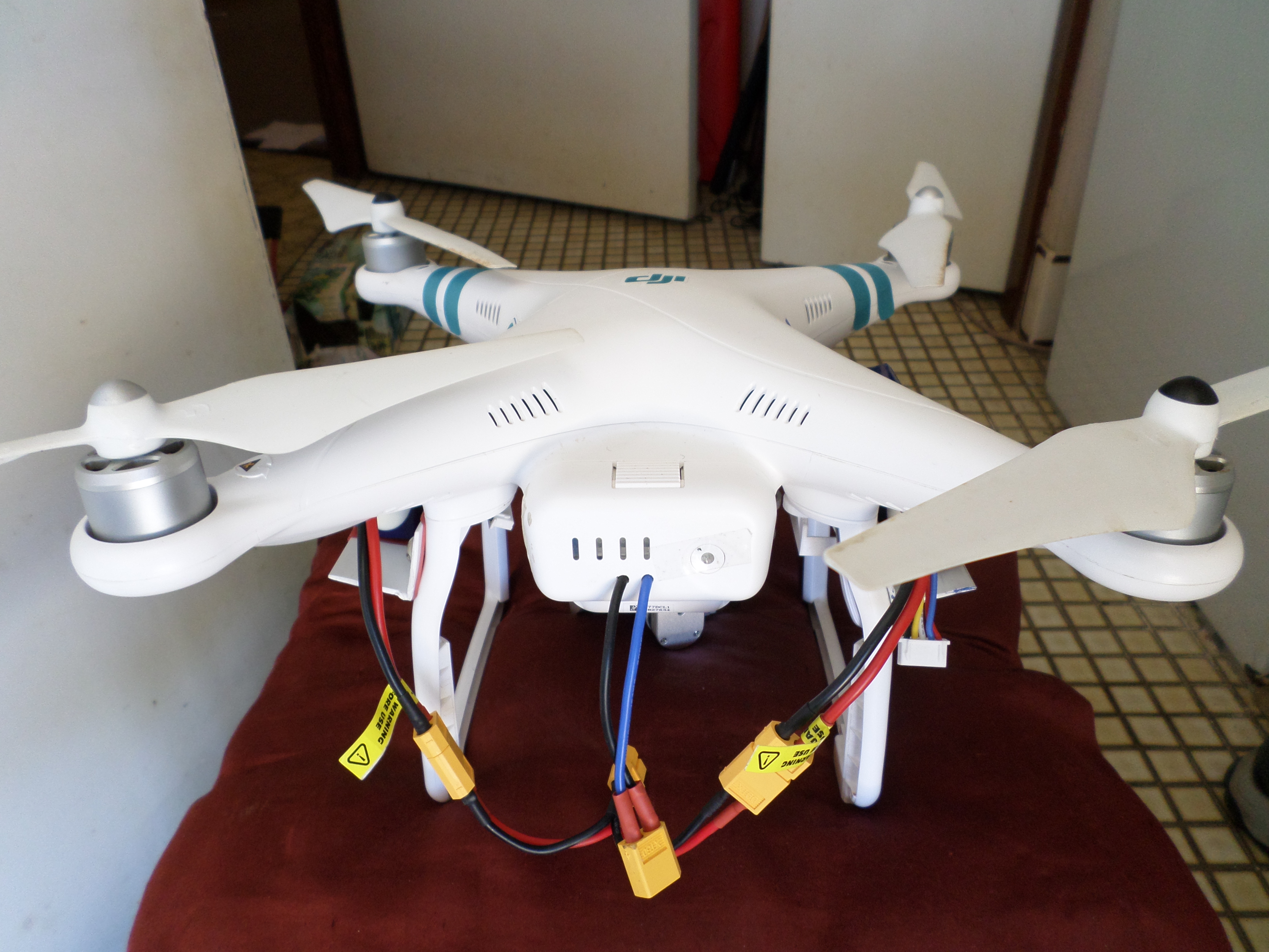

Greetings..just recently completed battery mod on my P3P..now I have a couple of Nano tech 1800 mah 25-50c on the
bird, but at 263 grams each a bit to heavy so I think I will be going for some lighter ones. I have found this thread very informative and helpful...well done to all those who SAM_0462.JPG SAM_0464.JPG contributed.
bird, but at 263 grams each a bit to heavy so I think I will be going for some lighter ones. I have found this thread very informative and helpful...well done to all those who View attachment 67286 View attachment 67287 contributed.
That's a great spot to start. I just try and stay under 600g .. do share how it works out, welcome to the battery mod game heh

Hey Digdat0 had second test flight with P3P battery mod using those nano tech 1800s...flew 23k and returned into slight
headwind..still had some more in the tank, flight time 23.20 mins.
