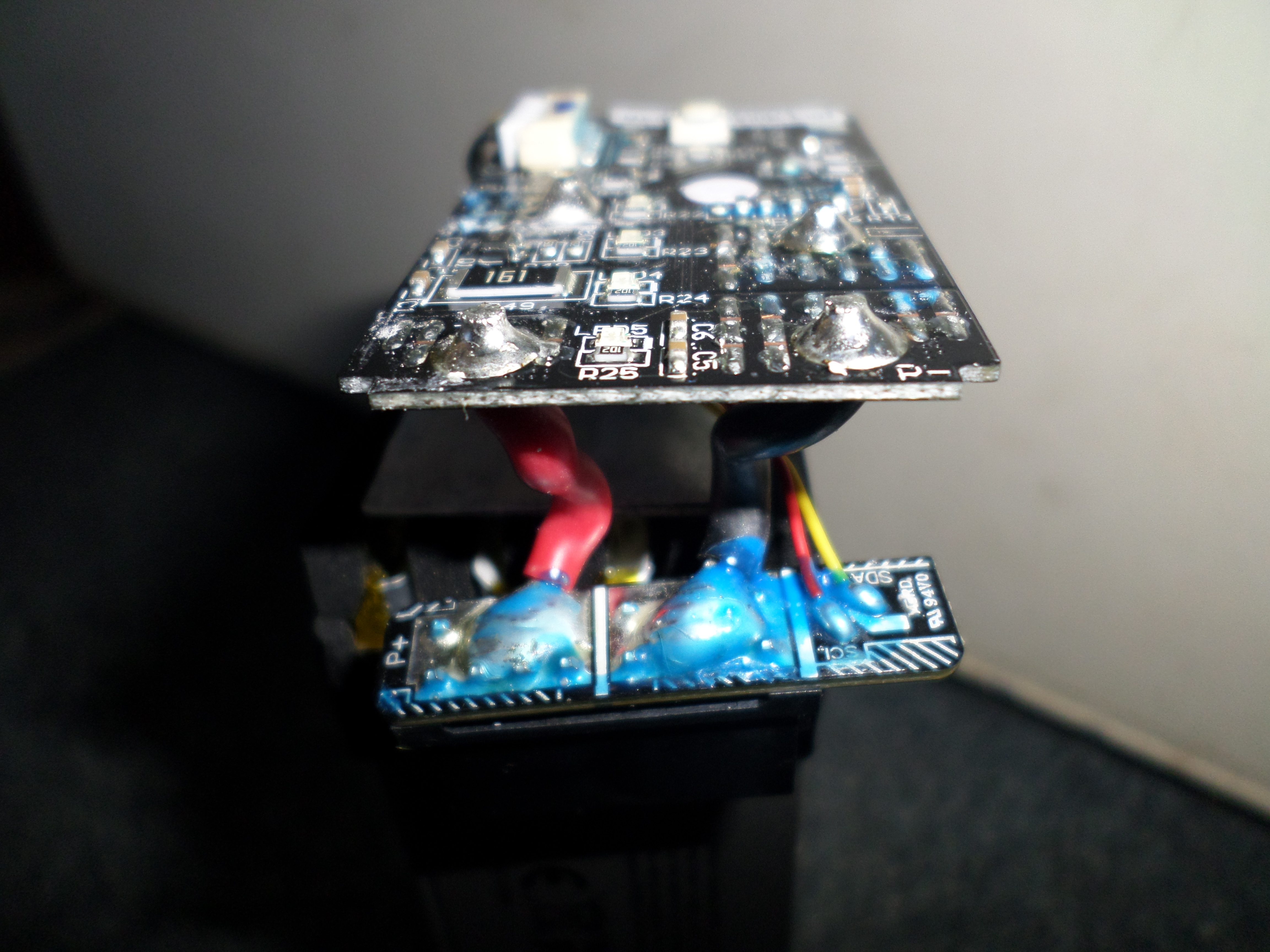

Hi I am doing a battery mod on P3P and am a bit unsure where to solder wires for my external batteries, in Rocket_Aus original post he stated solder on the positive and negative terminals (covered with epoxy goop) these are on top of charging port right, so do I solder them on there or do I solder on small positive and negatives on the control board. help
Hi I am doing a battery mod on P3P and am a bit unsure where to solder wires for my external batteries, in Rocket_Aus original post he stated solder on the positive and negative terminals (covered with epoxy goop) these are on top of charging port right, so do I solder them on there or do I solder on small positive and negatives on the control board. helpView attachment 66460
Yes on the top side of the board.
