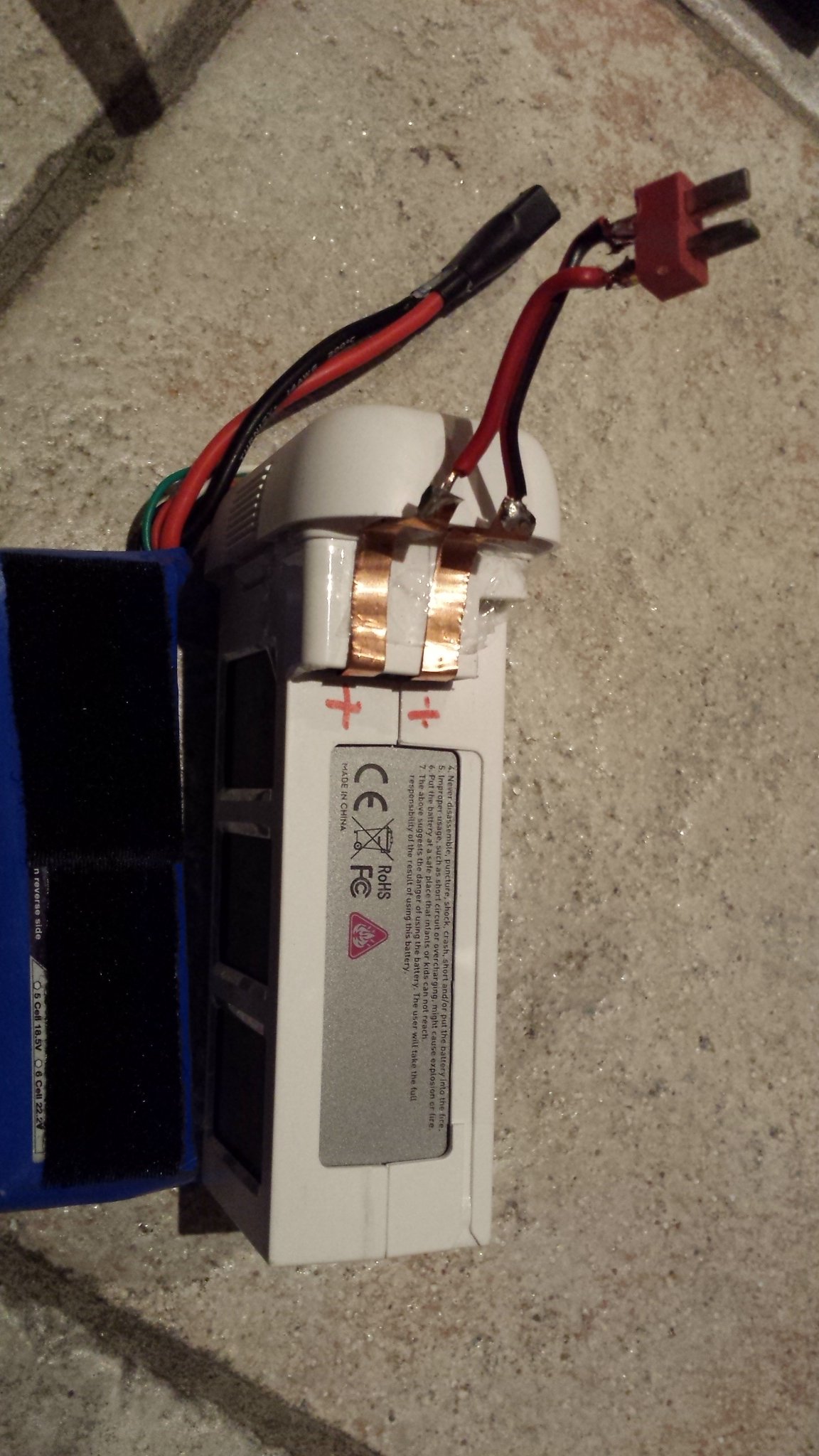

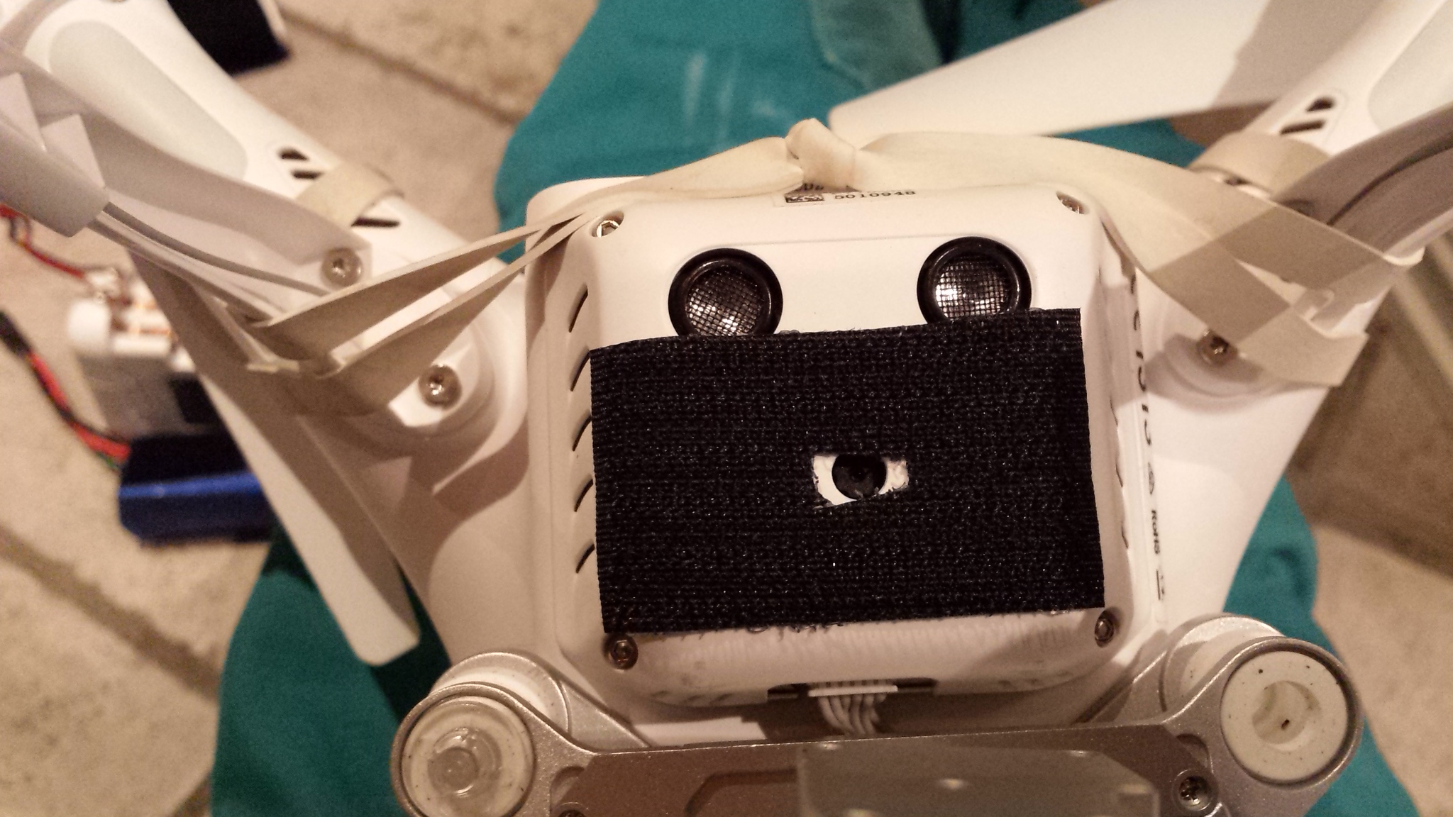

My extra battery worked very well with this diy connector. I used self adhisive velcro on the battery and the VPS module, with a cut out dor the sensors themselves, in case I want to fly without the extra battery and VPS activated.1477151948459249013151.jpg
Reactions: Digdat0
My extra battery worked very well with this diy connector. I used self adhisive velcro on the battery and the VPS module, with a cut out dor the sensors themselves, in case I want to fly without the extra battery and VPS activated.View attachment 67536

I have a duel DJI battery mod and I removed the VPS sensor altogether.
Can you please post pics of the external battery attached to your phantom without the VPS? Those screws holding the vps seem like a great place to latch a 5200mah multistar 15.2v battery without anymore modifications to the body.
so that white thing isn't just the VPS, under that white piece of plastic are two circuit boards, one is the VPS board and one is the transmission board.You take the plastic cover off, remove the VPS circuit board and then put the plastic cover back on. You then keep attaching the battery to that plastic part like normal. the vps board is gone, but the plastic remains.
