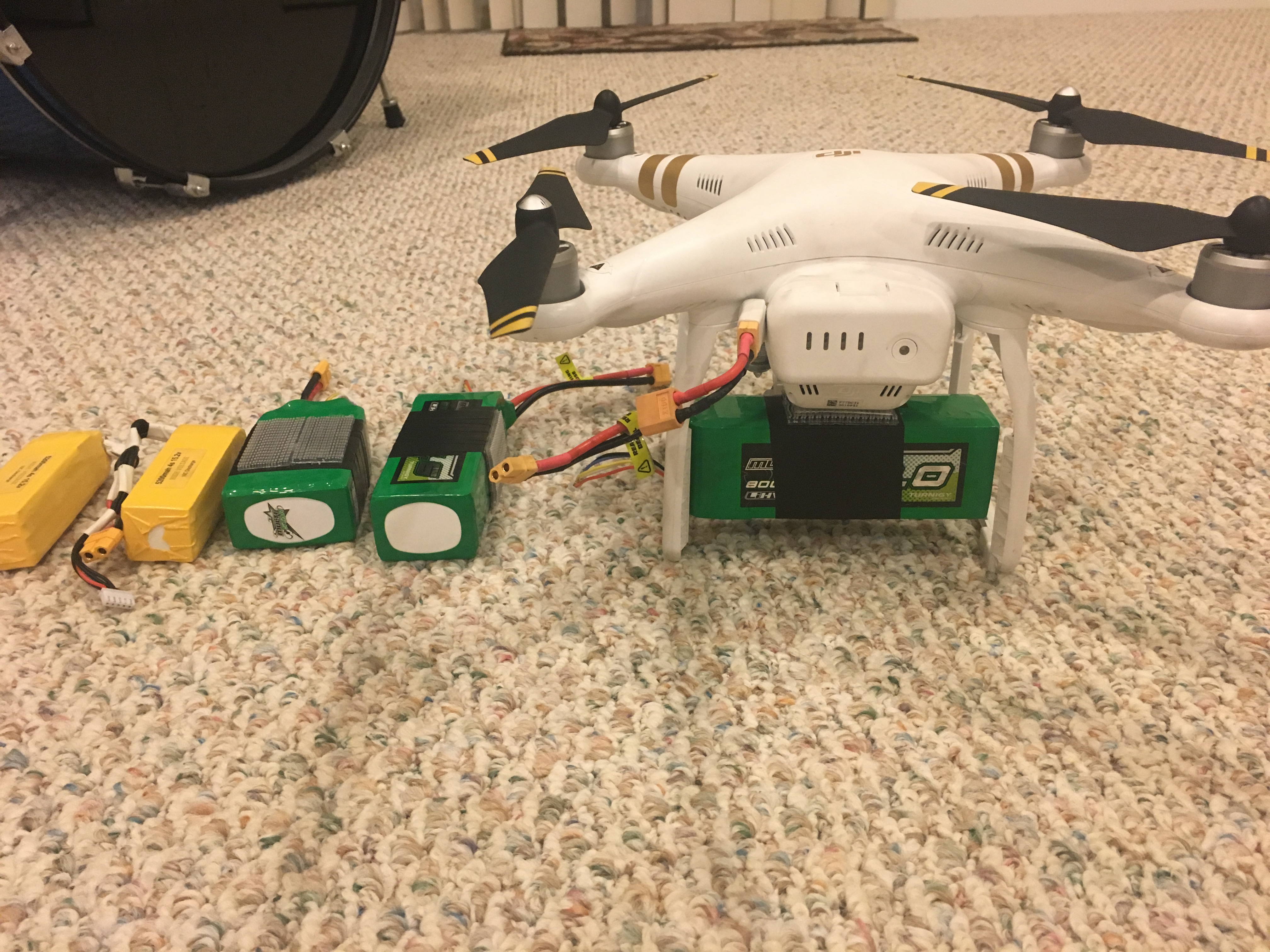

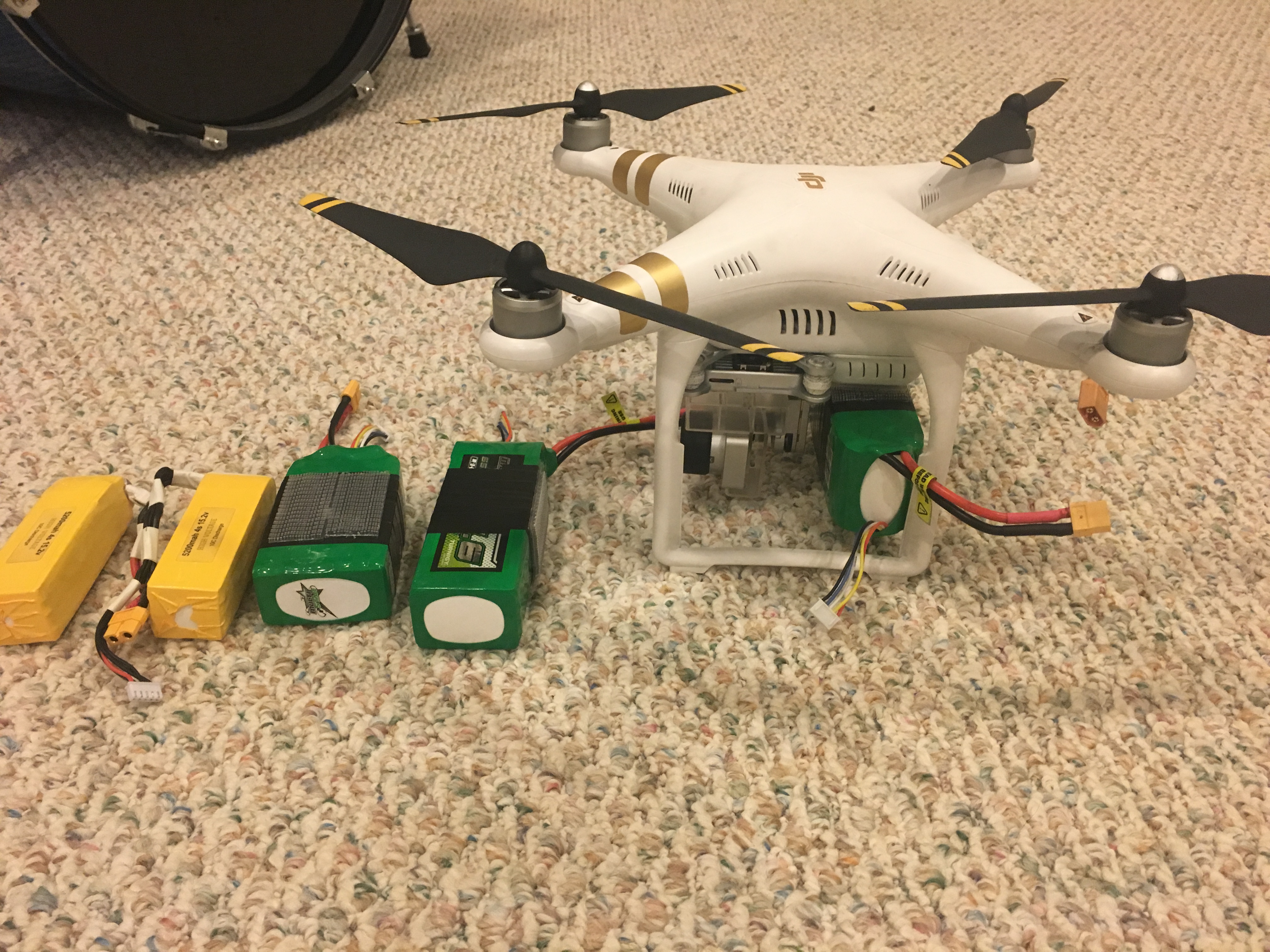

Sorry no pics, you just have to trust a stranger…
Here's what I'm testing...no secrets...
5200 split from Horizon barely made 30min…It sucks and wish I didn’t buy it…
MS 5200 LIHV 418g I get a little over 30 min maybe 32 to 10% (I didn’t keep good records but it was a little better than the horizon split)
MS 6600 LIHV 532g - No sure what I’ll get on this one I only ran it to 50% twice
MS 8000LIHV 639g - got to 40min and a few s first and second flight to 10% or around there… I’m hoping it gets better after “break in”… Rear motors were just a little warm to the touch from lifting the back end continuously (full throttle) for 40min to test...

Come on chazz! You peeked our curiosity too much. How long does it take to strap the battery on and snap a pic[emoji41] I got to see how this 8.0 fits on there. Hell the 6.6 almost made my aircraft do backflips
For the master I'll post a pic ;)...But I thought he wanted a pic of proof of the 40min flight and I don't have that...Sorry to maxwell if I misunderstood....
It takes me longer to take the battery off then put it on because of how good that dual lock stuff is...

Yep that's a big squeeze chazz! I thought for sure you was squeezin that big battery on there without a camera. I can imagine get some good flight time out of it, but I can't imagine getting good distance out of it, just from an aerodynamic standpoint. But you won't know till you try right. Little word of warning to you, i've tried (2) MS 4.0's and they do balance OK, you'll probably get 37 minutes or so, but one thing I found out the hard way carrying that kind of weight for distance runs is that it eventually burns up an ESC/mainboard! And it's really not even a matter of if only win both of mine happened around the 12th flight area. So while I do like to experiment with different battery combos and heavier than most will try, lately I found to try and keep it between the 5 to 600 g area with camera and just fly on calm days for distance. I tried the thunder power HV 4500s because they're a little lighter, but both pairs I tested were complete junk and not worth the money. After the main bat runs to zero the external still have 30% which means you're not utilizing all the resource you can or you can try to fight autoland for 20,000 feet. Writing zero for that long is not very comfortable[emoji41]

View attachment 67047 View attachment 67048
Thanks for sharing chazz. My last house had that EXACT same carpet!!
How does the aircraft fly with the 8k? If you go from full throttle to stop, any issues in balance coming to a stop, or issues turning? I noticed with my 6600 that braking was hard and kinda wanted to flip the bird, so I lowered the sensitivity to 70% and that really helped.

I have the duel DJI battery mount, and I had to dial the braking back to keep the flip from happening . I like the MS 4000 Hv. It is a good cheap battery to throw on for a little more time. I get about the same as running two DJI battery's.
With the active braking backed down it takes some feet to stop. And in a good wind it can drift some to.
