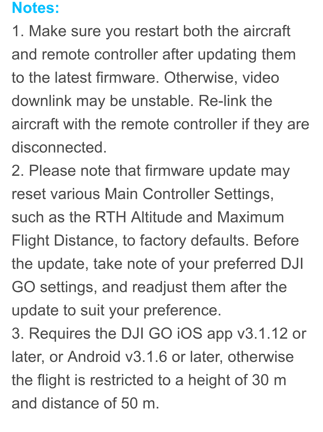

I suspect with RTH they will refer you to the cautions issued in the firmware update instructions.....
They may also claim that the advisory messages delivered by the app in flight should have been considered.

Interesting that u did not see this pop up from the GO App. Did you find that in the GO App when doing the update or do you have to refer back to it on their website?

It is BAD that they reset your settings after an update. No dispute there. But it is reality and must be planned for. It’s in the manual. When There are updates I go to this forum and research it before I update. Best not to update before a planned outing unless you are having severe issues.
Then always always do a preflight check including.
Max altitude check and recheck.
RTH altitude check and recheck.
