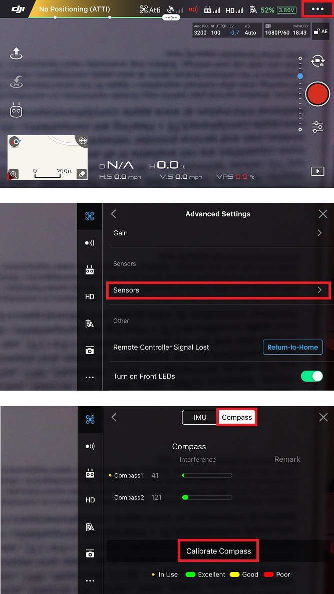

You can always calibrate the compass from the following section of DJI GO:

Phantoms have never asked you to set a home point and have always automatically done it as soon as they have a good GPS position fix.
There has never been any need to calibrate the compass but poor wording in older manuals caused many people to believe it was necessary.
In normal use it should never be necessary to recalibrate anything.
Calibrating the compass is 100% unrelated to RTH precision which is as accurate as the variable accuracy you get from consumer GPS.
If you let RTH land your Phantom 20 times, most landings would be within 2 metres of home point and some may be slightly more.
It would be very rare for any to be more than 10 metres away.
You don't need to let RTH land for you. If you have signal, you can cancel RTH and resume control yourself.
Or if you want even more RTH landing accuracy than GPS offers, your Phantom 4 now can use optical technology to give you Precision Landing.
