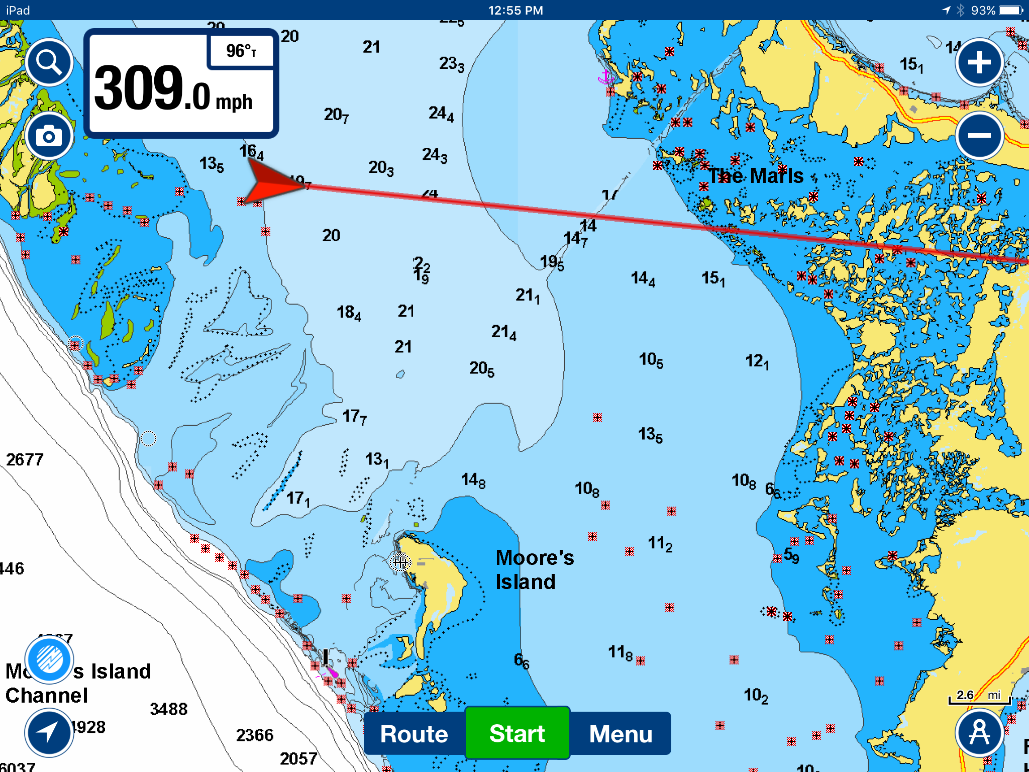

Here is the iPad location flying in an airplane going 309 mph.
iPad GPS work well except in DJI Go app ?
