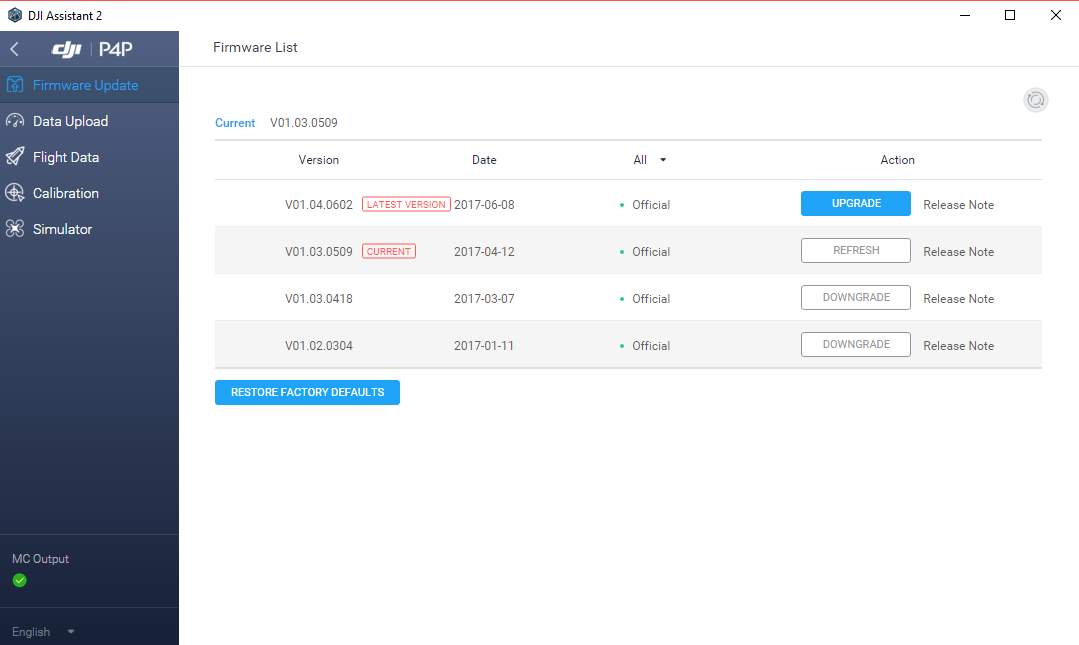

IF YOU ARE USING A PC instead of a MAC...
Does your P4P show up when its connected to PC running Assistant 2??? It sounds like it could be the driver issue if you haven't upgraded and used Assistant 2 since its last upgrade back in May, I ran into that and had to search for the link to quickly fix it. The only other thing that comes to mind is when I grab a "power wires only" USB cable she no worky, but when I use a full USB cable (like the white one that comes with it), it woks fine. Just turn on the RC, plug in the USB cable, PC makes a sound when it loads the driver, and away I go. With that I could do a factory reset which will reboot the tablet off the recovery Android image and voila, all was well.
Yes, it is AC version 01.03.0509 inside of that zip file and it is paired with RC rev 1.1.3.0, it is the last rev before this upgrade that was released on June 8th, and it was released on April 12, 2017 according to Assistant 2, so I am not sure where May 9 comes from.

I just got my P4P this week and it shows version #01.01.0203 while the RC is rev 1.1.3.0. I have done a few short flights and all seems ok, but should I upgrade the AC to 01.03.0509, which is one of the options I see when I run Assistant? Or just leave well enough ....

If you are NOT using a "+" controller then the "509" version is the one to use in the AC ... keep the 1.1.3.0 loaded in the RC ... do not upgrade the RC to the latest version"602" !!!
Nothing but MAJOR issues with the latest current release "602" !!!
