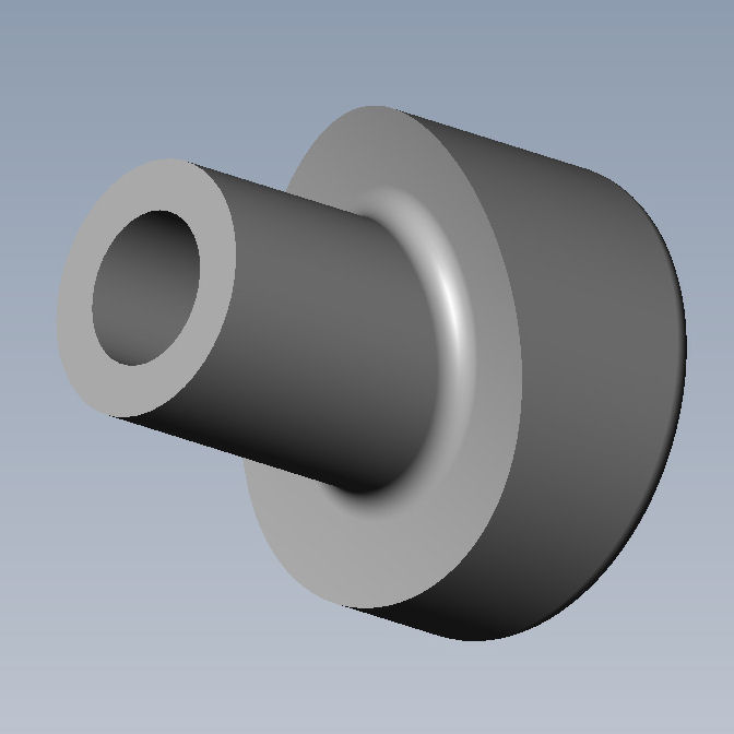

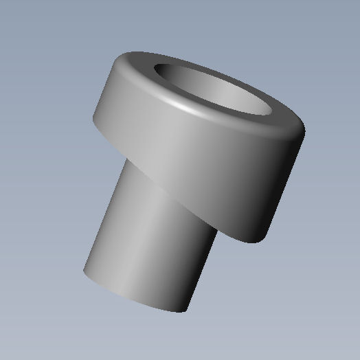

I discovered a crack on one hole of each rear arm on the "inner" holes.
I was given the 6-8 week option by DJI. I was going to tape or glue but I came up with a "fix".
I should have a set of these printed up tonight or tomorrow to test fit. I'm also waiting for some longer 2.5mm bolts to arrive. Wondering if anyone else would be interested in these?

How will those things fix the issue?
