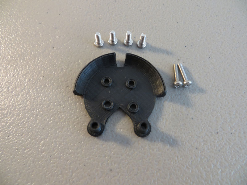

I will have the reinforcement plates available to ship by Friday. Just waiting on the screws to include in the kit.
Each kit will include 4 plates and 24 screws. Anyone interested can PM to preorder or visit our website.
