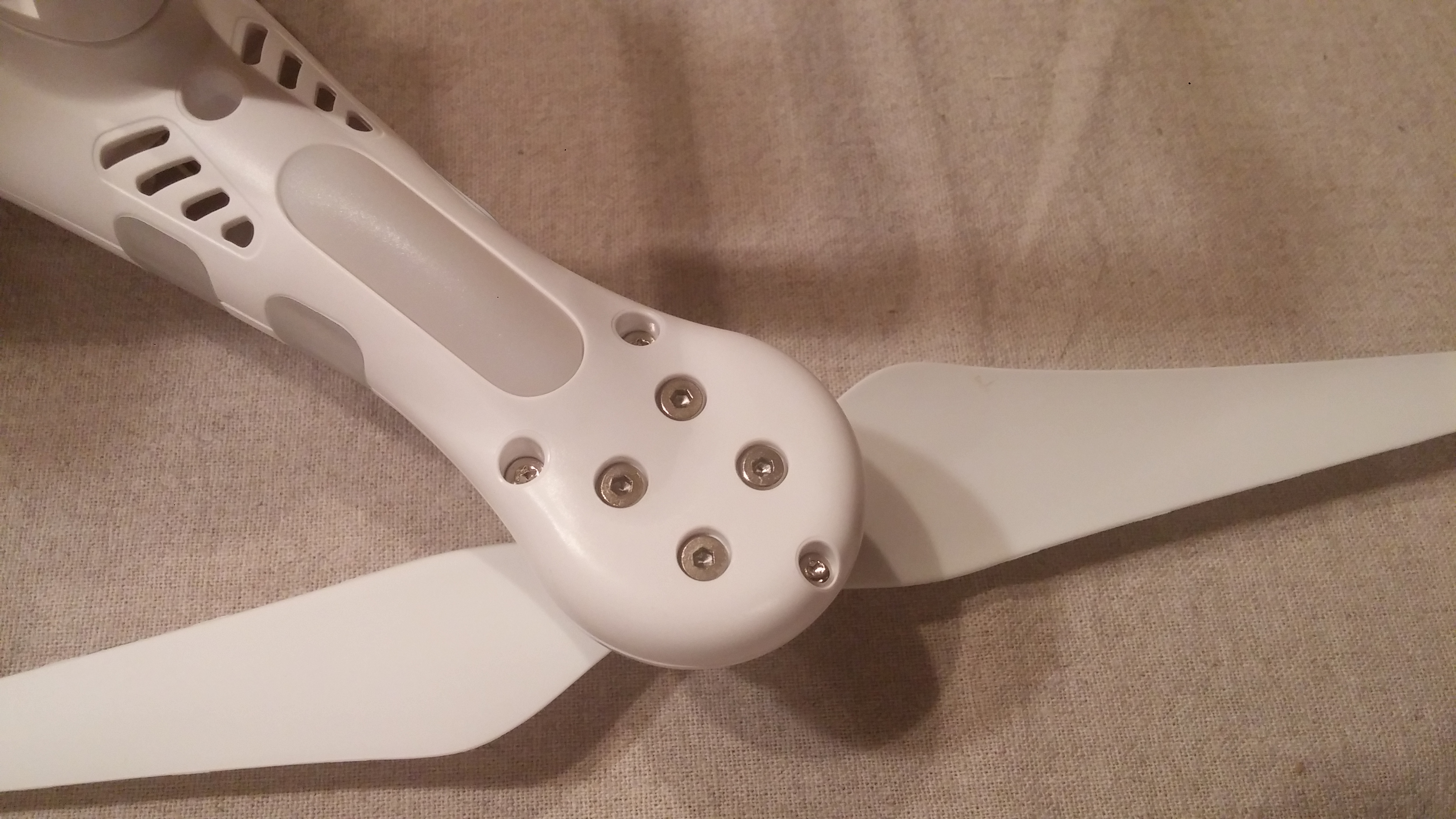

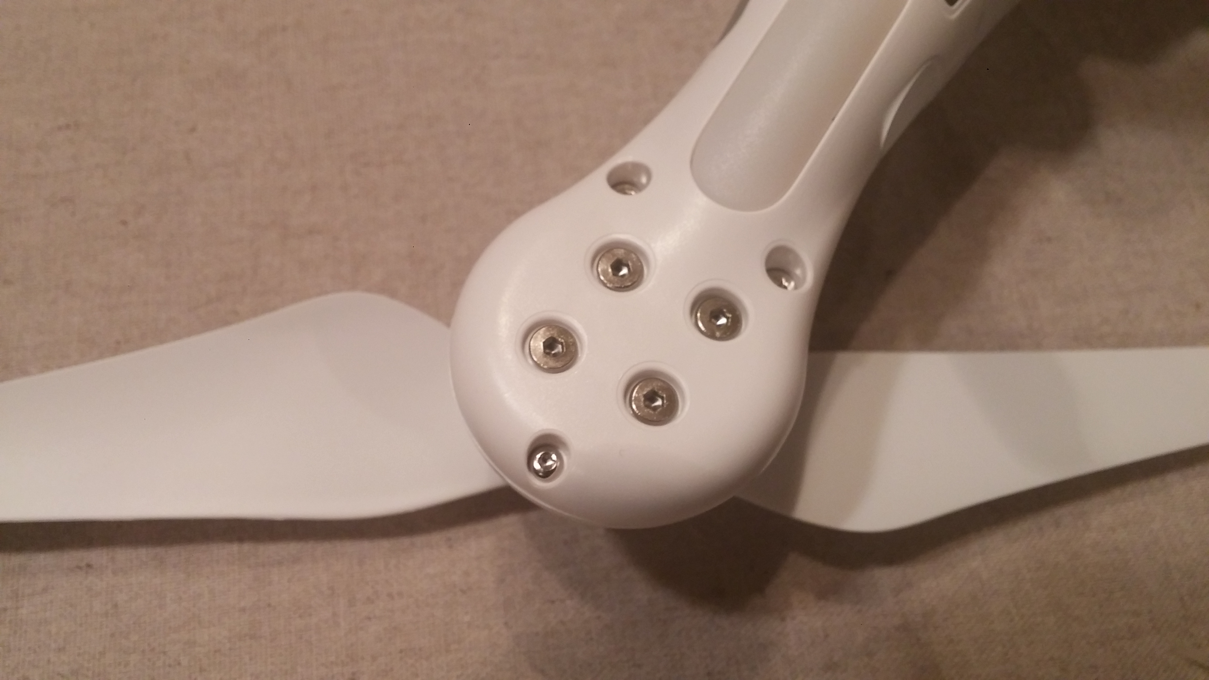

Looks like DJI changed the shell in the latest versions. I just got this advanced which has the new motors. The area around the screw holes has an outer ring on one side of the quad the other side is less pronounced. Thoughts?
View attachment 29269 View attachment 29271
Hmmm. Perhaps more material around the screws to avoid cracking? It has the indications of a thicker wall.
