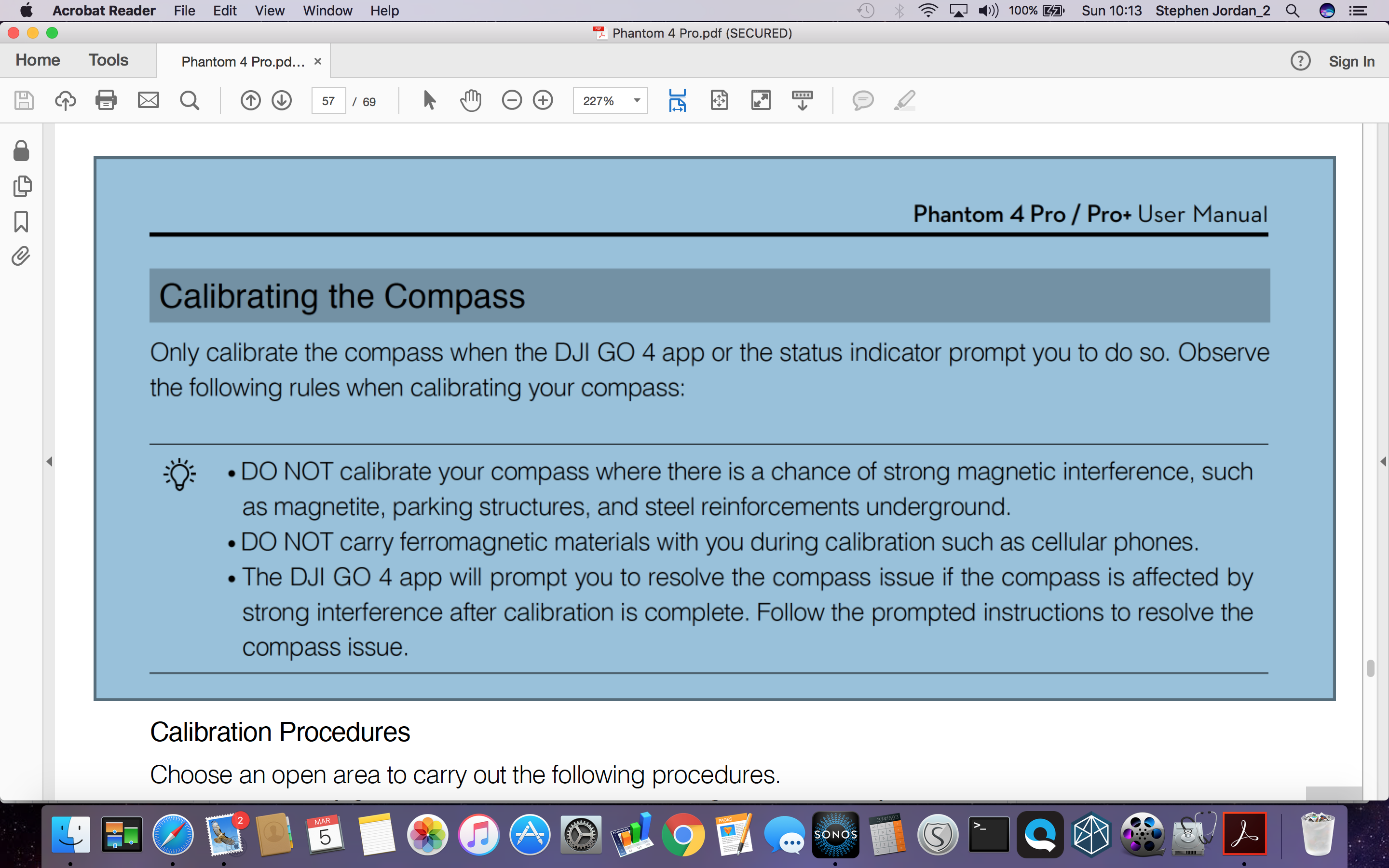

Dji support tells me that i actually should calibrate before every flight.
This is a screenshot of the latest DJI P4P manual....

My reference was the Phantom 4 manual. Did DJI change their procedures or is there a difference between the 4 and 4P compasses
It was never necessary to calibrate every flight or location and DJI are only now correcting the poor wording in the manuals for new drones.
Thanks for the update. Do not want to incorporate errors unnecessarily if a calibration is not required. Since I am new to this drone hobby, I was just following DJI written instructions.
So is the conclusion is to follow the manual, calibrate it once, then only calibrate it again when it tells you to?
The manual doesn't say to calibrate once.
Here's what it does say:
I have been flying my P4pro for three months straight out of the box with no calibration - exactly following the manual instructions and have had no trouble with it.
So after reading through the manual I also see that it says, "Only calibrate the compass when the DJI Go App or the status indicator prompt you to do so". I just got my P4P+ and it hasn't yet prompted me to do so. So I shouldn't do anything? Is that little "Calibrate" button on the Aircraft Status screen considered a prompt? Or will a screen/prompt explicitly say something like "Please calibrate the compass before your next flight"?
You do not need to calibrate unless it specifically says to. The button is just the button to do so. I've never calibrated mine out of the box yet either. And zero problems here.
