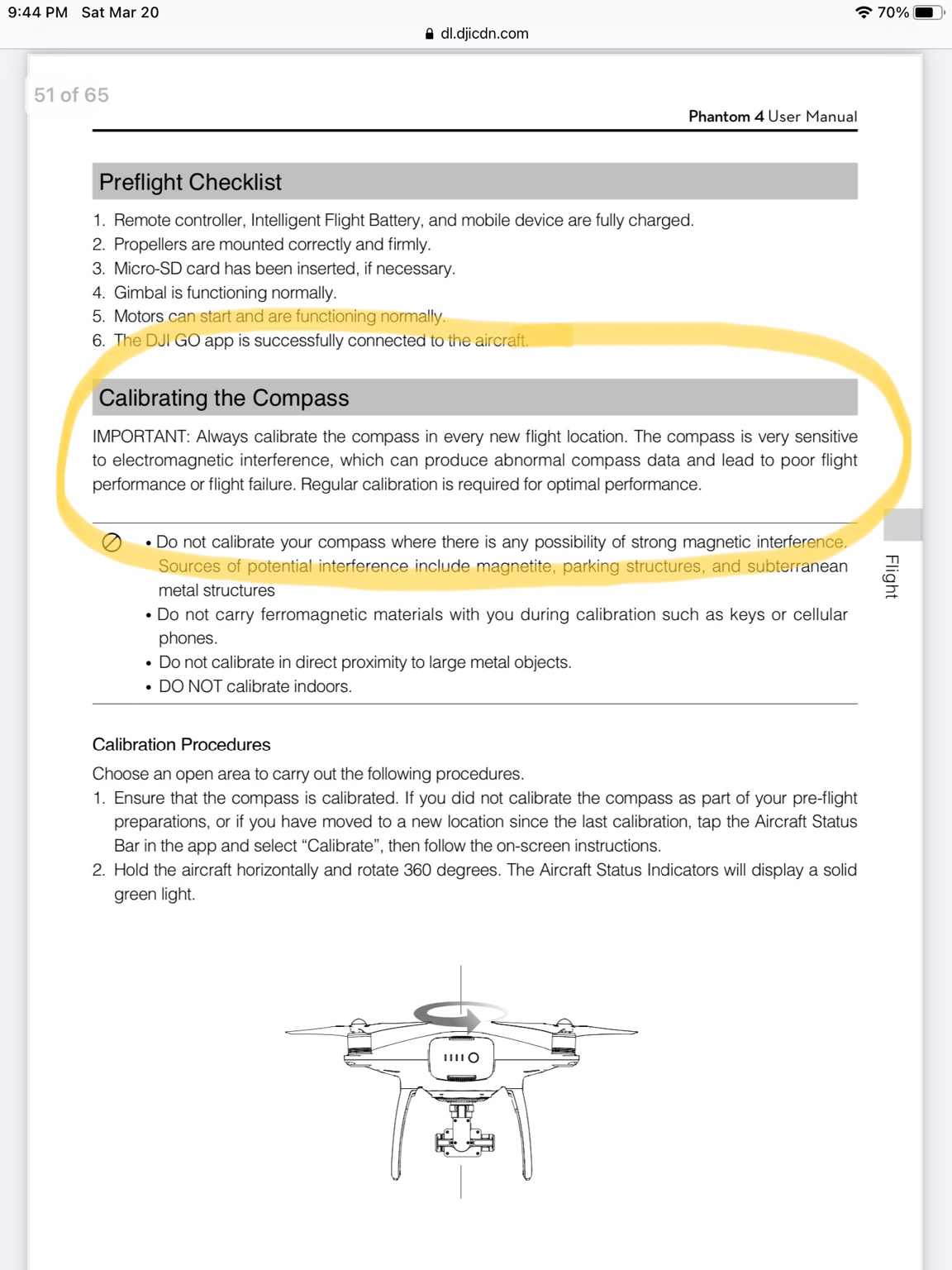

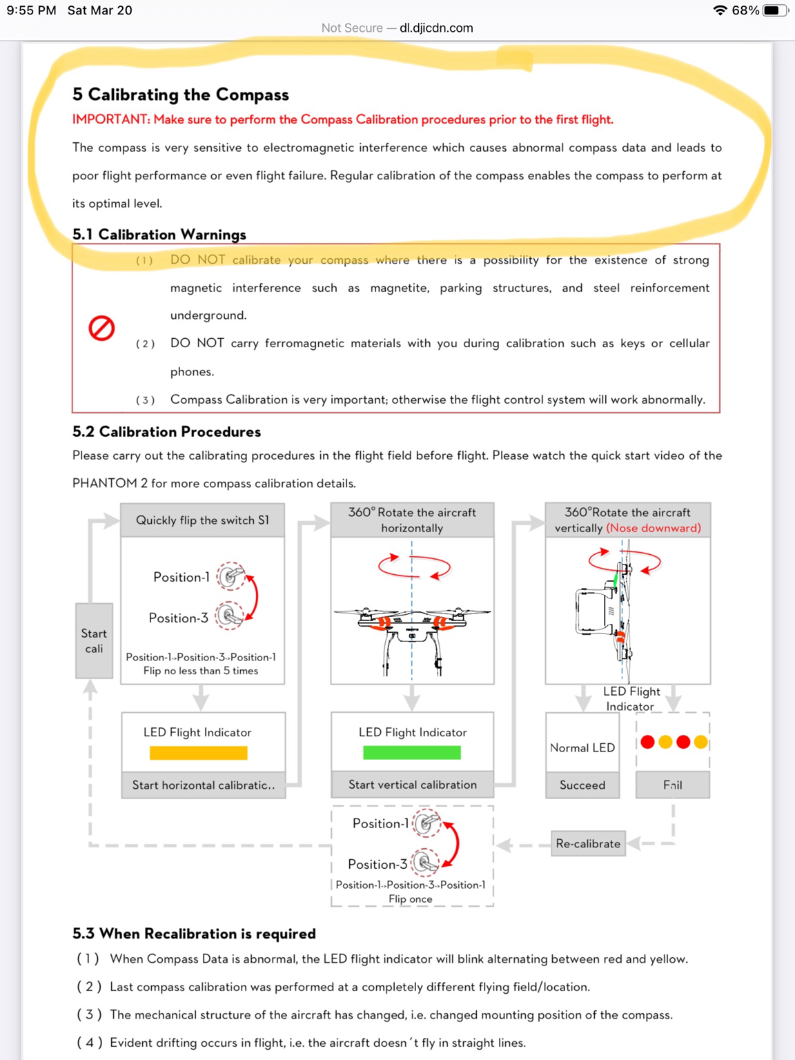

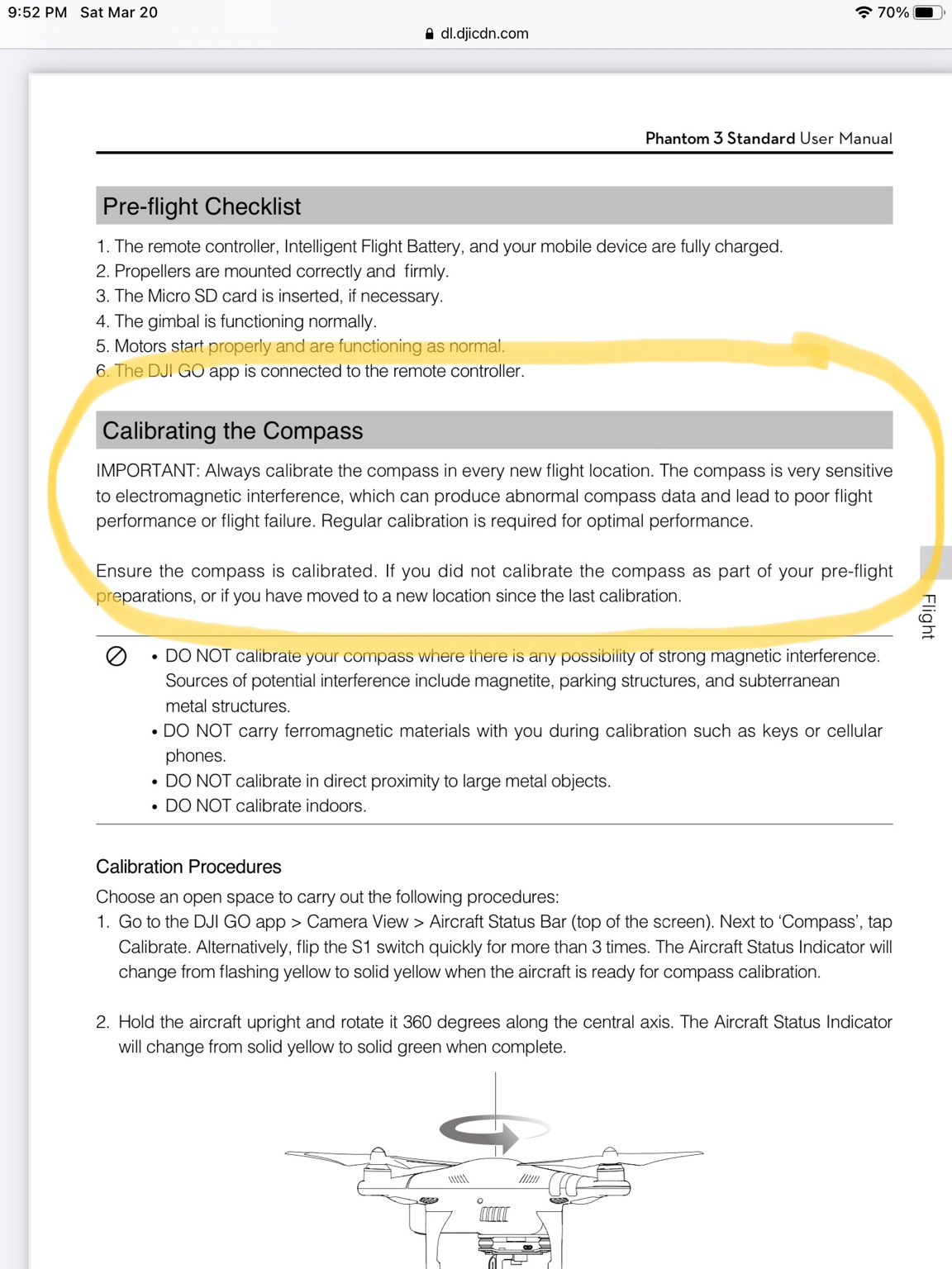

That quickstart guide is the only mention of calibrating before 1st flight that I've seen anywhere.
DJI have spread lots of misinformation in their manuals, giving inconsisyent and contradictory stories at different times, although the compasses all work exactly the same.
They almost got it right when they came to the Phantom 4 pro manual:
It mentioned nothing about distance or time from the last flight, but they went back to the same misinformation again in later Mavic manuals.
There is absolutely nothing about your location or distance from another location that has any effect on compass calibration.
Compass calibration is only related to the magnetic fields that are part of the drone itself.
Now that we know what compass calibration actually does and when it's needed, we also understand that DJI's manuals are not to be relied on for accurate compass information.
I guess one could infer from "Always calibrate the compass in every new flight location” to calibrate before first flight also.
Definitely a big difference to calibrate only when DJI app prompts you to. Nothing about first flight or new flight location there. I see the inconsistency in their wording. I only calibrate when prompted to on app.
