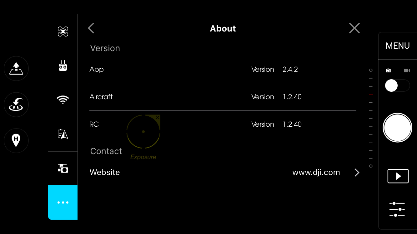

Apparently, my RC is up to date, but my aircraft is not. How do I go about updating just the aircraft. (Sorry. I'm sure this is a dumb question for you old timers, but I'm still new at this whole updating thing)...
Turn off everything. Now turn on your remote controller, the drone, launch DJI Go app. At the top of the app, there is a banner informing you that there is a new firmware. Tap that banner to update.
I did what you said and I get a notice about an Inspire1 download but no banner. Here's what I get:
