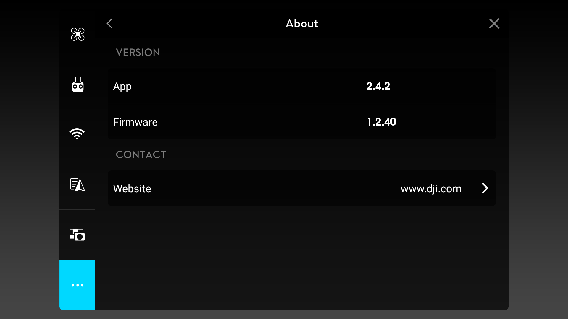

In this firmware we should update radio? I cant find what is version firmware in my radio control. 2015-12-03 15.41.53.png
In this firmware we should update radio? I cant find what is version firmware in my radio control. View attachment 37101
Don't know, but do you have the remote, phantom powered on and have the mobile device connected when your on that screen?

Farken A
Yes, i turn on.
I just got my Asus (some kind of a tablet) and my iPad2 out of my freezing rain covered vehicle (Remote starting is great). Anyway the Asus being a android does not display the RC version even with everything powered up.The ipad2 even though is not listed usable and is a crApple displays RC "1.1.30"
