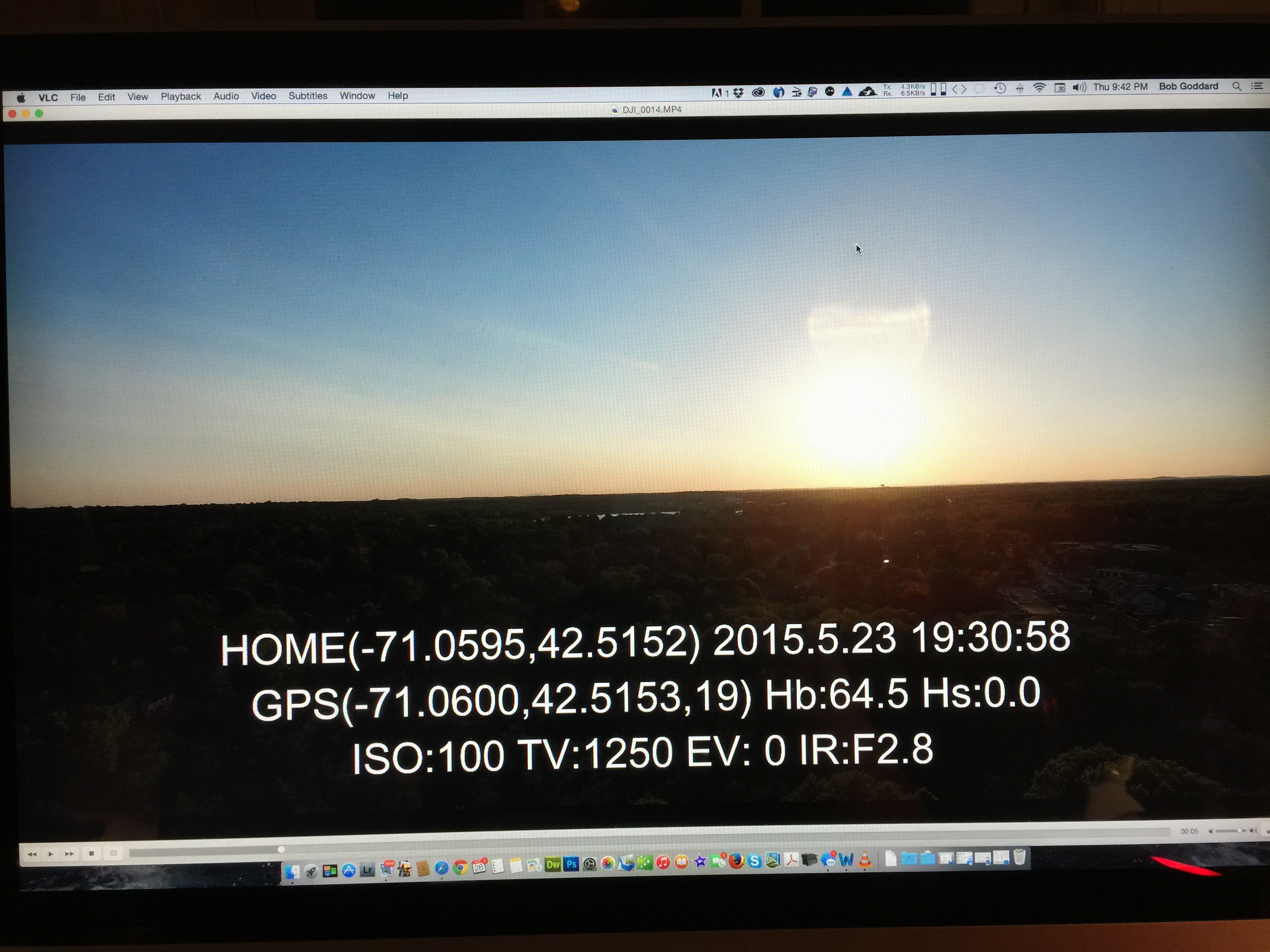

SRT acronym means?
It's a supplemental file to the video that contains the closed caption data. DJI could have just embedded the CC data into the video, but that would have been more difficult to remove if someone wanted to share a video without giving out potentially sensitive information (GPS coordinates of your house?).
