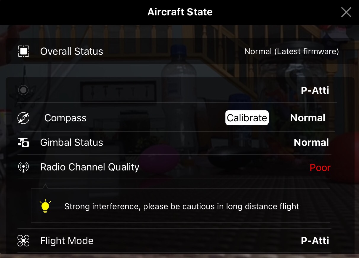

Is this the error you are getting?
That's the exact error I get with the previous rev of dji go. I'm one behind this rev. I was hoping this rev fixed it. Has it? It shows that but the channel itself is clean. Since I did the 32 channel hack I'm not sure I've seen it.
I haven't updated yet. I'm currently on the following :
I also have the 32 channel hack on a clean channel but still get the error which cycles on and off

That is exactly the error I'm getting. Upon closer inspection, DJI sent me the wrong P3P, AGAIN!! This is twice they've sent me the wrong drone. Getting a little pissed right now. I haven't seen the P3P I bought since March, when I sent it in for repairs.
I get the error as well but seems to go away after I take off and fly. It certainly concerned me but after numerous fights I've never had any issues. Sad thing is I don't recall which app version or firmware I started seeing the error. I have yet to update to the new 2.8.3 app yet so I'm not certain if it would fix the issue. I'd love to hear others experience with this issue.
