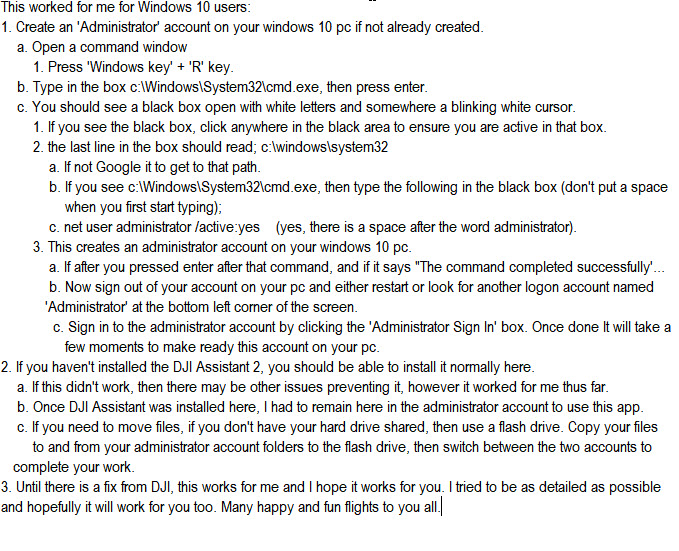

Concerning the install and use of DJI Assistant 2 and if you're really stuck... Try this;
