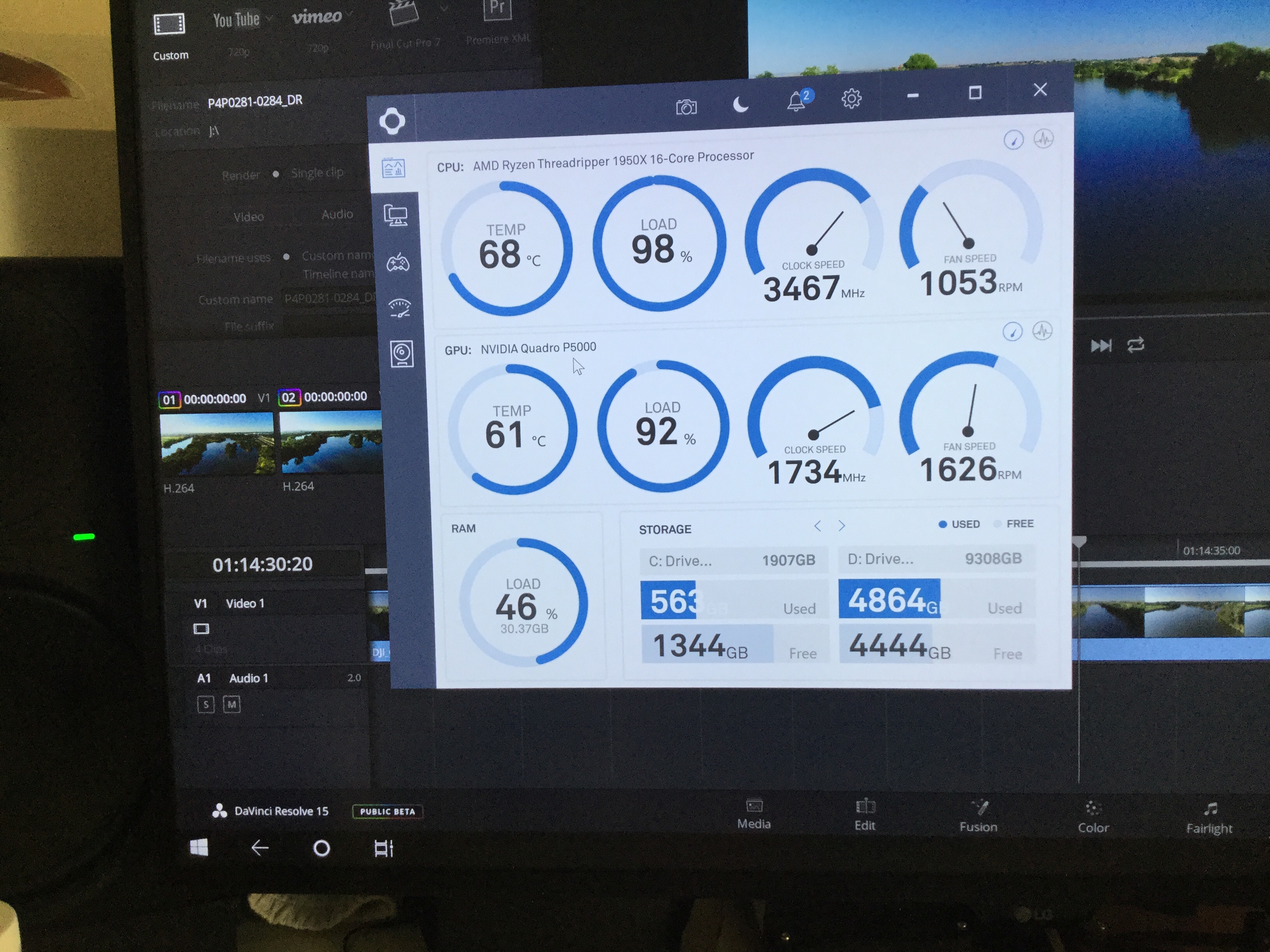

Here’s what my numbers are for DR, it fluctuates quite a bit;

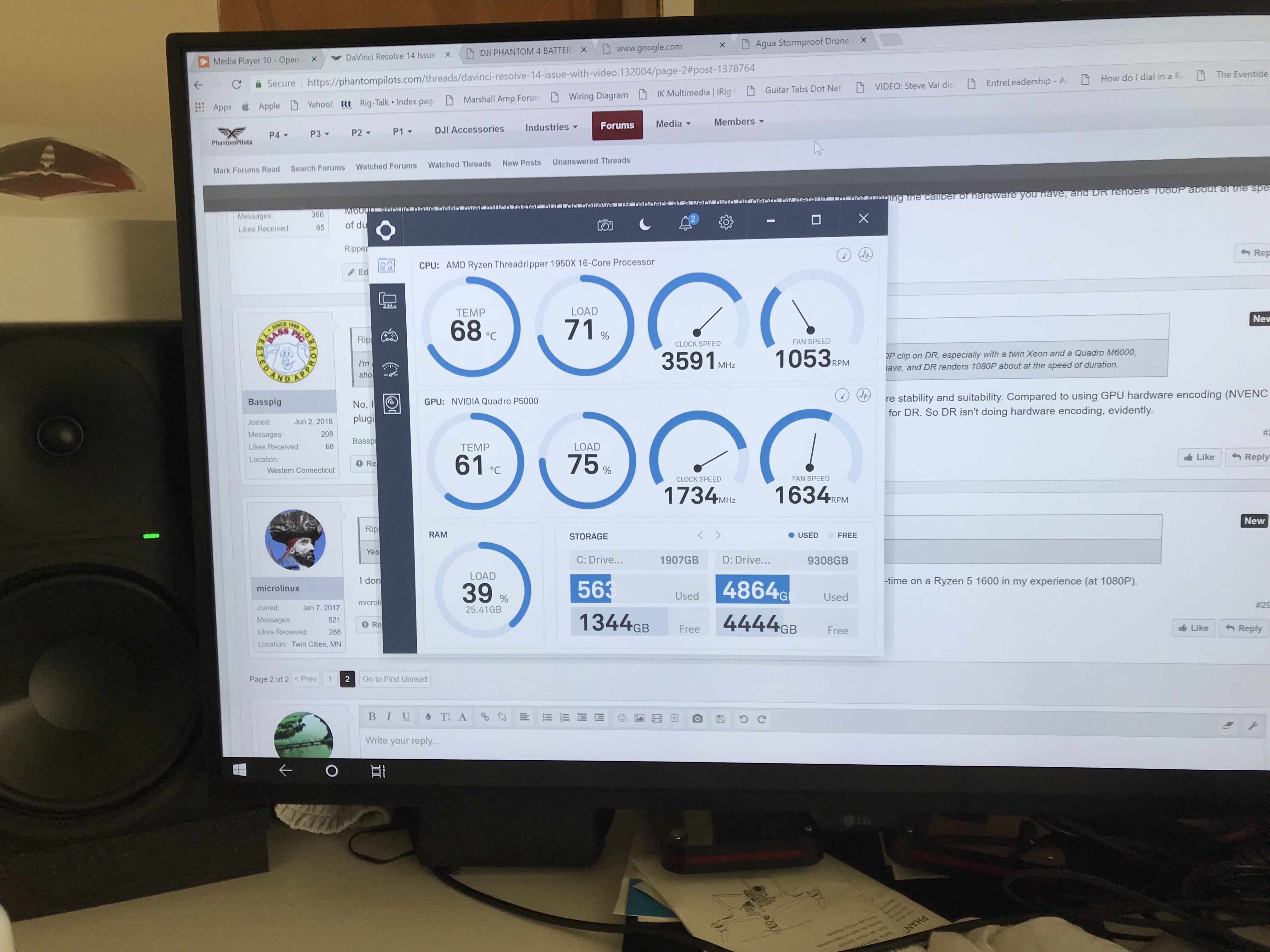

Here’s with DR & PP rendering at the same time;

Frankly, I'd be very surprised if one of the app developers incorporated NVENC hardware encoding into their app. With Premiere, it's a plug in you can download free. Premiere only uses GPU to accelerate scaling and certain GPU-accelerated effects during render. As such, it makes a small improvement, maybe 40% in my tests, but NVENC makes a 1200% increase in speed in some instances, especially when scaling down to 1080P. A minute of 4K video will render out to 1080P in about 8 seconds and that's on a GTX680 and Core2Quad machine I built in 2008.
