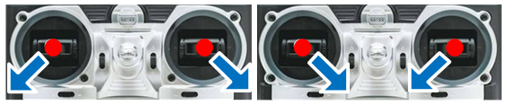

CSC can only be engaged like this:
Yes.

Those of you who have the option to use the simulator should for sure be using the simulator. Move your sticks closer and closer to the CSC until shutoff is triggered. You will see that both sticks down and in, though a very simple thing to do physically on the RC, really does result in a "batshit crazy downward spiral of death." Even though it is possible to do this, your P3 is not meant to be flown in that manner and you would likely not do this accidentally.
