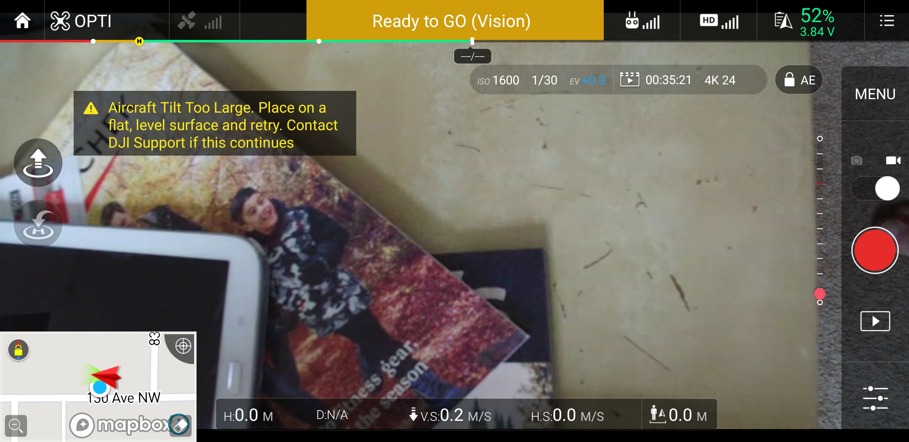

Ok youve all got me curious. Im gonna hookup my system. Power on the AC while its level. Point it face down and try and do a motor start (with no props obvs) and see what happens. Will report back soon.
@quaddamage Yes you are absolutely correct as shown here:
