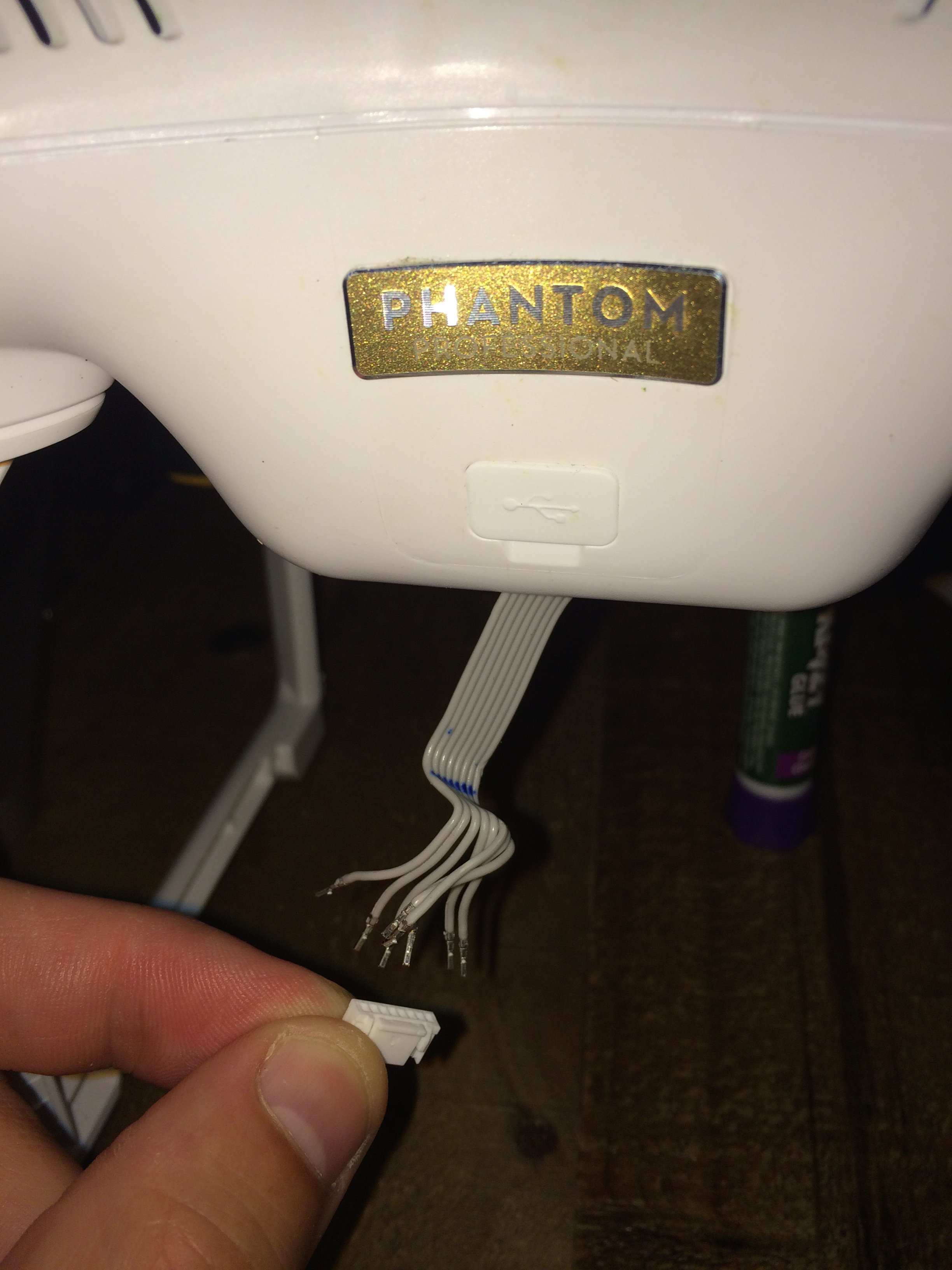

Hello, I had 2 days ago an accident with tree also. Planning to buy a new gimbal from dji, but what about those cables? Cause one small peace is broken. Where I can find that white peace? Please help, cause in my country nobody sells.
