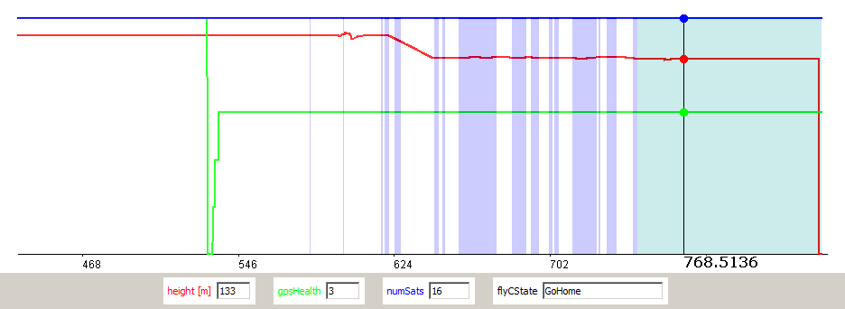

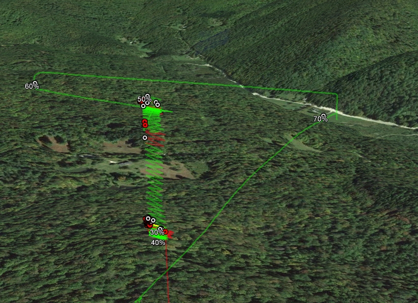

@Jnnyr I looked the .txt for this flight. This incident probably has a lot to do with a gps problem. Although the number of satellites remained at 16 the gpsHealth dropped from 5 to 0 and then back to 3 at 531 seconds.
Here the gpsHealth is plotted with the green line. The light green/teal background shows the GoHome that was issued either by the pilot or the P3. But, the P3 just remained where it was. The very tail end of this flight was showing a Lat/Long of [0.0, 0.0] indicating that it had no GPS info.
I understand DJI is telling you that wind was the problem. IMO this is total nonsense.
Without the .DAT this is about as good as I can do.

Don't know the answer to that. It's computed by the P3 and has a range of [0, 5] with 5 being the best. 4 is marginal. Anytime it's 3 or below the P3 will drop into ATTI and have trouble navigating.
I'm not a GPS expert but in addition to number of satellites there are other factors that will influence accuracy. HDOP (Horizontal dilution of precision) and VDOP (vertical dilution of precision) are some of those factors.
