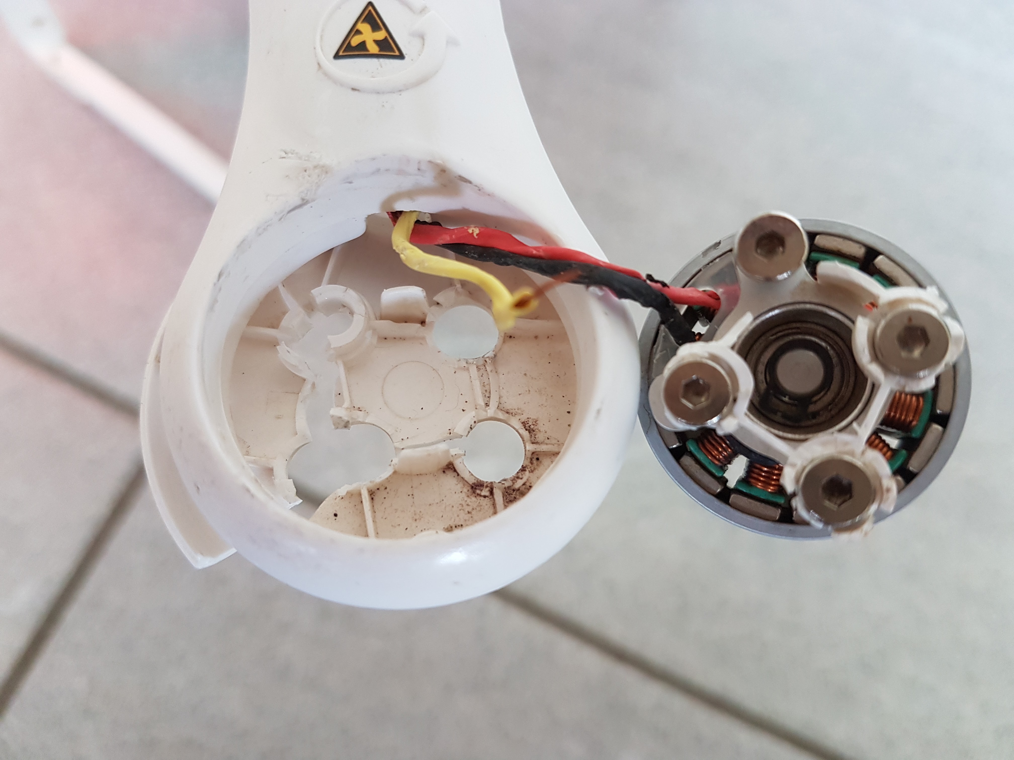

I had a similar occurrence with my P2V+, the body cracked in the motor mounts (like yours) motor popped out still working which caused the same visual effects on video. I usually don't fly very high, so it was visible to me.

one motor is definetly defect, maybe twoof them. Now here's my question: whenever I try to start the motors (with only 3 motors attached), I'm getting an ESC status error. (please see picture below). Before I buy a new motor; do you think this error will disapear when 4 motors are attached/connected? I want to avoid buying new motors and having the same issue afterwards. Then i probably would better invest the money in a new the P4. COmments are welcome and appreciated.

finally done. I had to replace 2 motors and the whole case. It looked like one of the motors went off because the body/case became instable from a earlier crash and because of the downspeed.... however, the baby is back in the air and flying. Thanks to all for your help.
