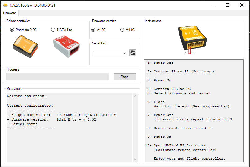

If you are using windows you have disable driver signing,hold shift and click restart,then in boot menu click startup settings then after restart press 7 and next menu,then install dji driver again
After driver install download naza tools exe from this post ,bridge bottom f1 and f2 with wire ,select phantom in fc type and choose firm ware 4.02 or 4.06,then click flash

"bridge bottom f1 and f2 with wire" your mean jump 2 pin (signal) on the left of Phantom2 FC ( hard reset FC) ?

Are you using windows?when u say you don't see anything do you mean you don't see naza tools program or you don't see fc in com port list

do you see this program when you run naza tools exe?,the two pins to bridge are bottom f1 and f2 at front of naza (next to m1 to m6 pins,if your using windows check device manager and see com ports when fc plugged in you should see dji USB device,also the fc needs to be powered on,if you only want to use phantom in naza mode it easier for you to use phantom 2 assistant then click phantom top middle screen and change to naza mode

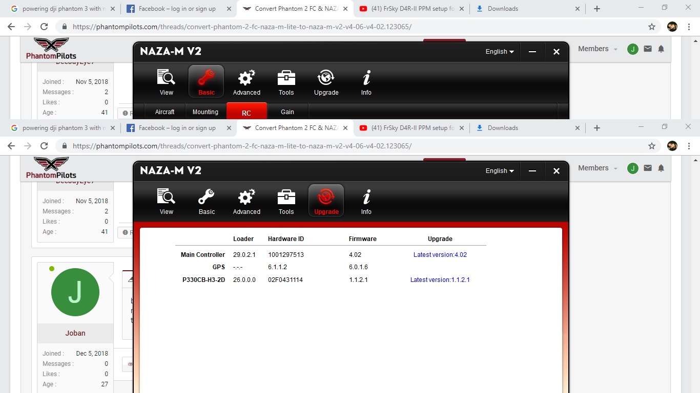

brilliant work... Is there a way we can roll back to the p2 firmware, i converted mine to a naza v2 and the esc leds are not functional... i really like the navigation and status leds on the escs... also my stock p2 gps is not detecting.. in the upgrade tab it reads the gps version but it shows atti in the rc tab

I found the problem, i updraded my P330CB-H3-2D board, now i need a solution on how to downgrade it
Hello,
Could you explain how you have upgraded your P330CB-H3-2D ? In the NAZA assistant
, I do not see any information about the P330CB-H3-2D distribution board or the GPS. What can be the problem ? Thanks for your help

Could you explain how you have upgraded your P330CB-H3-2D ? In the NAZA assistantView attachment 106314, I do not see any information about the P330CB-H3-2D distribution board or the GPS. What can be the problem ? Thanks for your help

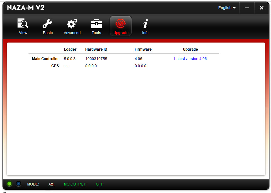

Hey,
It would only show if you have the fc connected to the mainboard of p2 via the exp port (gps port)
