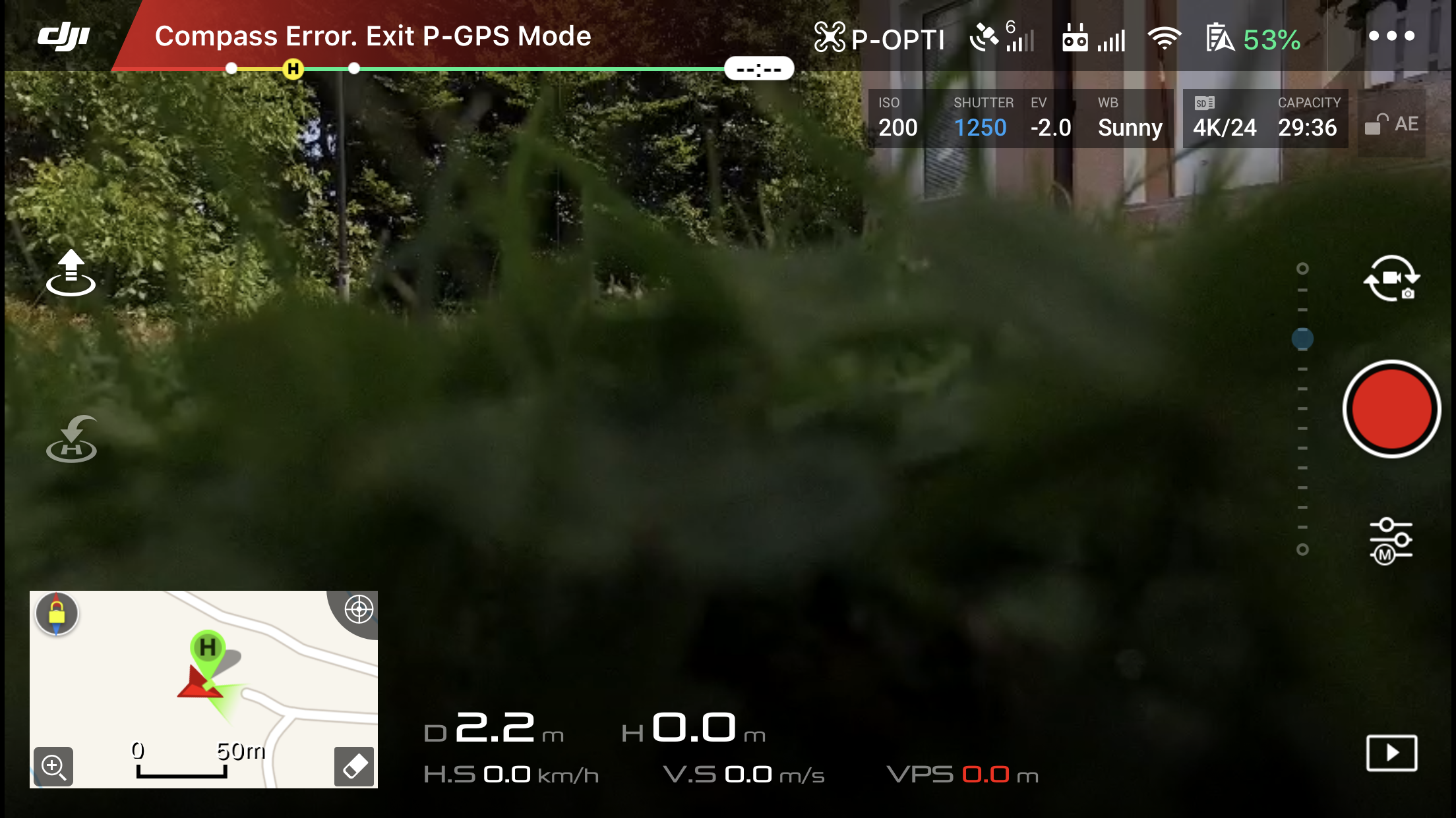

Hello. I’m new in DJI... I buy a used DJI phantom 4k... notice some problems with compass. It’s saying “compass error exit p-gps mode” or something like that... what can I do?
I did compass cal and IMU cal. but it didn’t help.

Actually I did fly with drone... when I did calibrations It’s ok and can fly... when I fly away from me (pointing camera away) is everything ok. Then when I turn around the problem starts... and if I again turn around (away from me) the dron then is ok again...
I live out off city... so I live in open area:)

Looking again at your screen photo .... I see a large building nearby ... indicates to me that you are possibly in garden ?
Can you try somewhere else ?

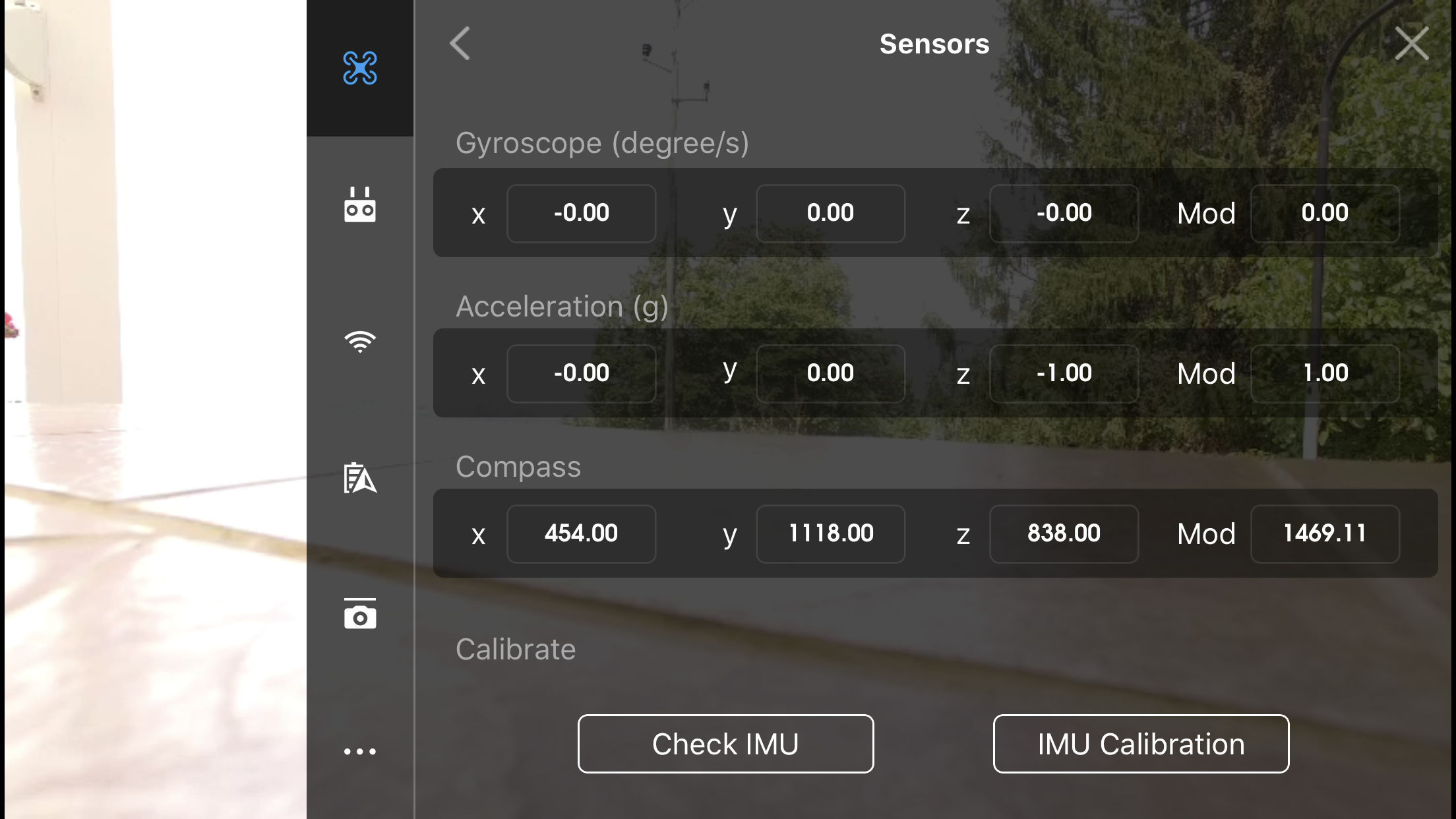

Can you post a screen shot or screen video of the IMU page where compass numbers are shown in their boxes ?
Yes they do fluctuate ... but should average out ...
Now others can see the numbers and comment on what they would expect to see ...
Reactions: Remsak94
In my case they don’t average out... they always fluctuate...
Sorry what I meant ... the numbers fluctuate either side of a mean ....
