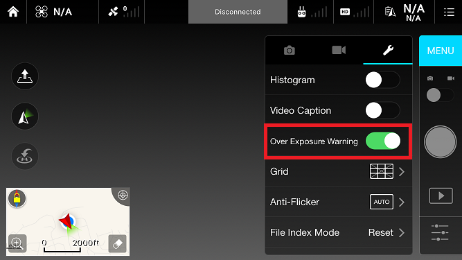

    I was flying my p4 over cancun yesterday and I noticed when recording in manual all buildings sand and hardsurfaces had a checker board effect black and white. Has this ever happened to any one before if so please help

    thats because it was overexposed and it is warning you about it, as you have that option enabled in the app

    You can disable that feature in DJI GO here:

    Sorted for me to!
    Cheers
