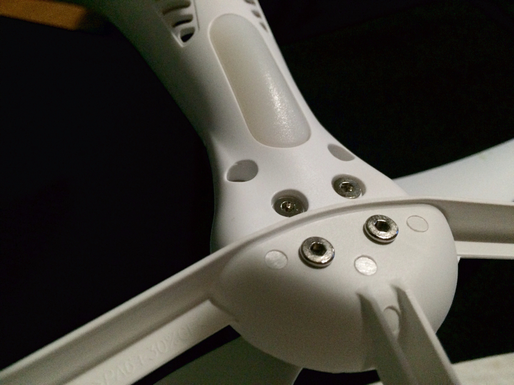

I recently got my phantom 3 pro 2 weeks ago. Having only installed dji prop guards and about 13 flights, I've noticed some slowly growing lines in a couple of the screw holes. I'm guessing these are the beginning of stress cracks? Should I throw a zip tie on the end to help relieve maybe some pressure? Can u still use prop guards with the reinforcement plates? I like the added protection.
I baby this thing and follow everything by the book. Let me know what I should do here to prevent what's been happening to others. Or is it too late?

I want to post in that forum but I'm to lazy. My picture shows what appears to be the beginning of a stress crack. I barely let this thing touch the ground. Only to take off. Double hand land it every time. It's my baby lol, and what a beauty it is. Check it out, this is not a slight mold defect its 100% a stress crack, small it may be for now. Gonna install zip ties. Worth a shot.

Not that I wanted to but I sent my P3P in a week ago. I had cracks going from each motor mount to the next. I didn't lose a motor but completely stopped flying when I saw it. Literally showed up in a day. I have always checked for them and I flew for the last time at my father in laws place to show him. Immediately after taking off I noticed it was a bit "wobbly" and seemed louder. I brought it down and noticed when killing the motors that one seemed to stop spinning before the others. I brought it inside and bam, cracks around all four motor screws on that specific arm. I had flown it previously that day perfectly and no issues. I've had no crashes, no rough landings, nothing since day one. Logged close to 125 miles and had no issues whatsoever. I read about these cracks daily and felt like it was a fluke but it's real. I bought the UAVbits kits and contemplated just going that route, but with it being the motor mounts and all four, with cracks up to the separation point, and the fact I had never crashed or anything, I figured sending it to DJI to get fixed and to at least serve as another example of a genuine shell flaw and not a "user failure" would serve me the best in the long run. I'm not sure my giant caveman hands would do well trying to replace the shell. I know my limits. Haha.

Good call that looks like it is on the edge of failure. I just ordered a set of strong arms as a just in case.
