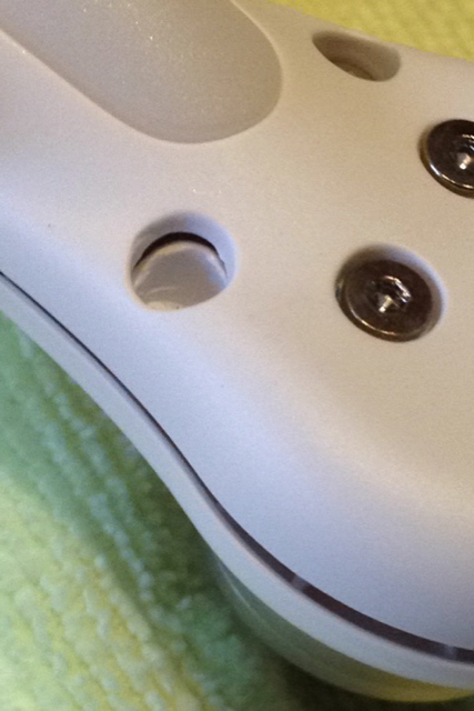

Catastrophic design flaw of Phantom 3
Here's my P3P after 12 hours of flight time. No crashes. I want a replacement!

Yep, call DJI and if you didn't crash it they most likely will repair/replace it for you. Or you can zip tie it for now and keep flying it until flying season is over. But you must call DJI now.

someone posted pictures of your motor failure on RC Group - The DJI support guys there are saying this failure is likely the result of a crash resulting in continued motor spinning generating enough hit to burn through the plastic rather than weak plastic failure such as those with small cracks. I think they would love to access your logs to find out one way or another.

Here's mine. Cracked in same place on both rear arms. It runs from the seam all the way to the screw. Not as bad as some of the others but still unsettling.
