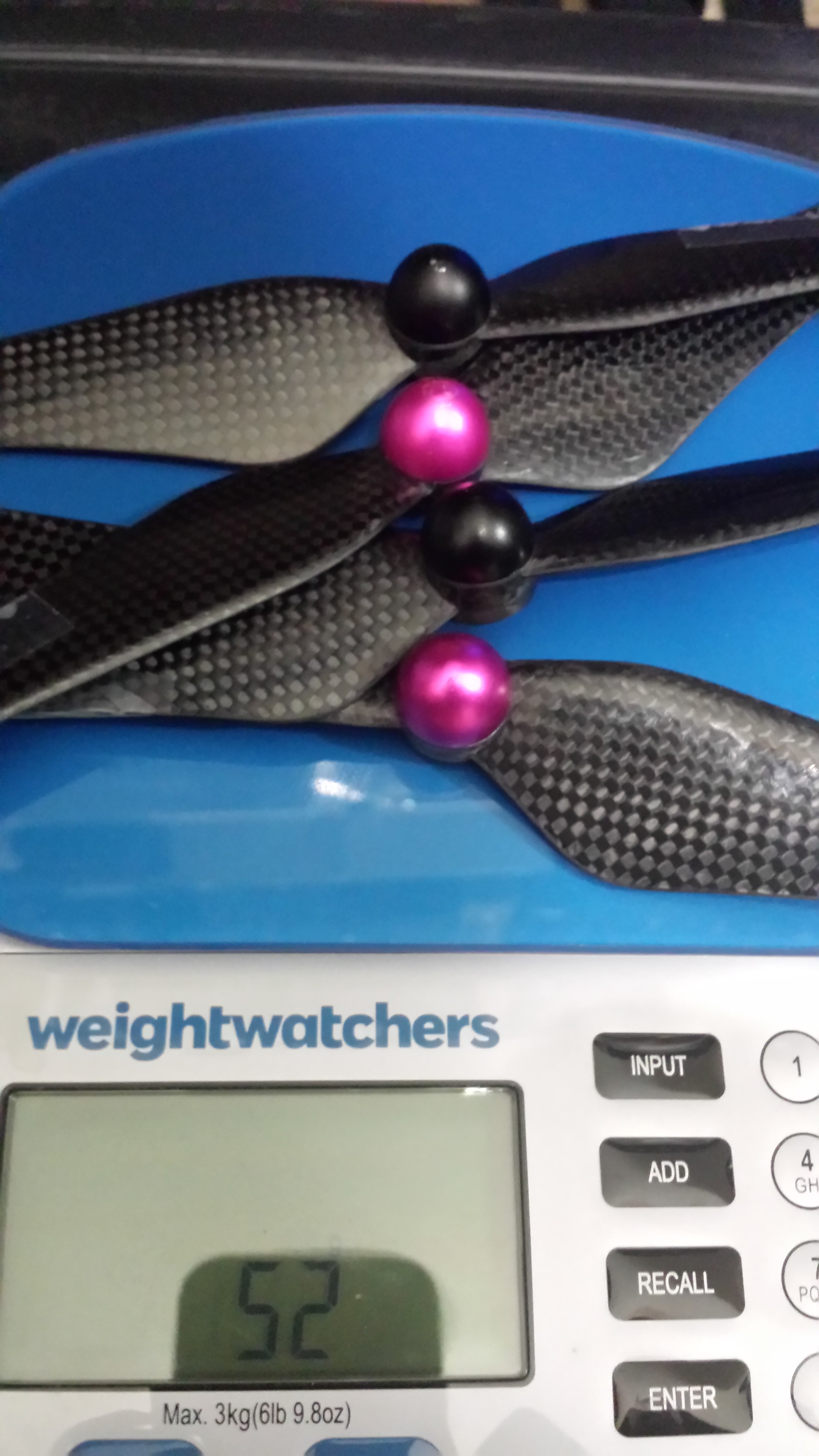

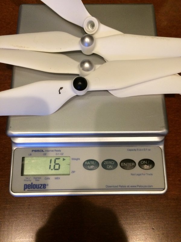

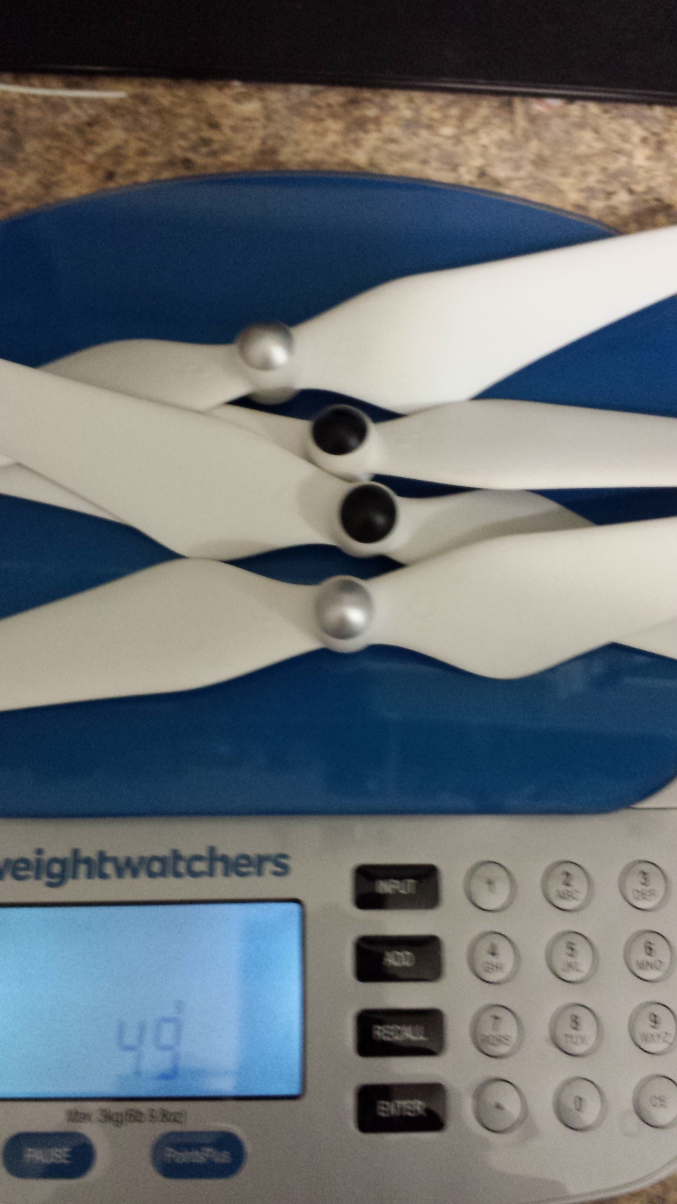

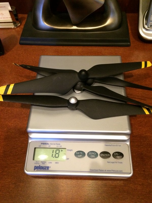

But here is a repeatable test I made a few minutes ago. All props are DJI. Unbelievable, I know - CF are .2oz heavier per set. Not much difference, but definitely not lighter.
wierd, someones scale is off :) ill have to pull out mine next time i fly my P2 or P3, typically CF are advertised as being lower weight , so i didn't doubt the measurement i linked to.

I pulled the CF props out and my WIFE weight watcher scare. You know it's good.
The CF props came in a little heavier then the stock DJI props. I'm going to say because of the large center. One thing I did notice in my flight it was like I was flying on ice. Yes I have droven on ice. If you watch the video it was all over the place and I was trying to keep it straight. I did loss it coming back half was. lucky there was no ditches ;)
