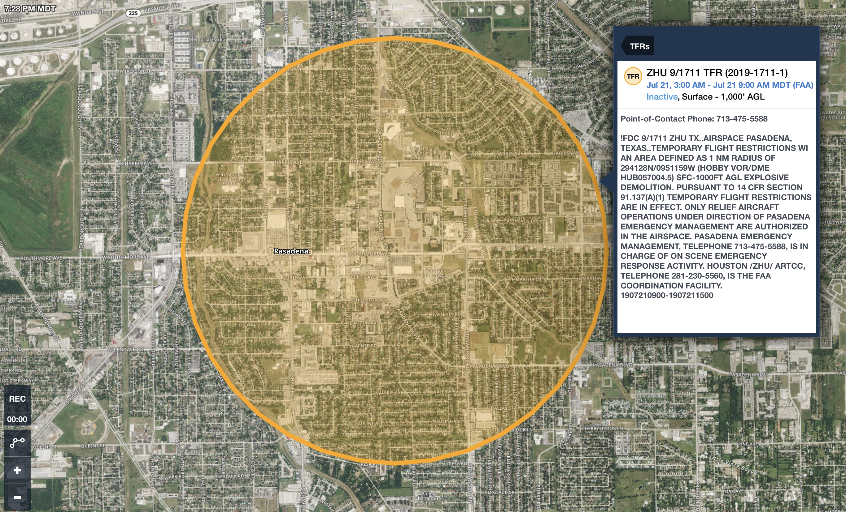

I mentioned that the Class B airspace was on one side of the bank, but not on the other. If no TFR materializes, then wouldn’t I be good locating out of class B?
B4UFly is confusing with all the overlapping etc. I wonder if someone with better understanding of this map could determine if the east side, say over the Chase Bank, would be flyable.
Demolition bank is 1001 Southmore 77502. Chase bank is across the street a little east. Looks like1100 Southmore.
Thanks,
Geo
Looks like I found the TRF. Oh well...
Geo
Yes - there it is.
112883

each TFR when posted will list needed information, coordinates, altitude, etc. It will also list the controlling agency and a contact number and person. This agency can authorize flight into the TFR at their discretion. Most likely not a UAV because it has no transponder code, but that is how you get permission
The TFR is in post #30.

simple answer is no
Neither can the film company weather they have a 107 or not if there’s a TFR in effect
A TFR is a flight restriction so that certain aircraft can fly in a certain place without other aircraft interfering. A TFR is not always to keep all aircraft from flying near something, though it is sometimes used for that. But if the city created the TFR and if the filmmakers that the city hired are part of the aircraft involved in the event, then they can fly there. But you sadly can't. Maybe you could set up some ground cameras and film the event, or go outside of the TFR and the controlled airspace and fly there, though you will probably not be very close to the subject.
