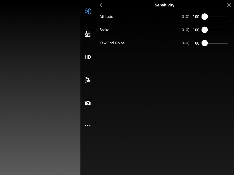

Actually it might have been an aircraft adjustment in the Main Controller settings > Advanced Settings > Sensitivity > Attitude. That setting needs to be dialed down a bit.
Maybe someone else will remember. It helped some when there was a visible aircraft vibration while hovering after an earlier update.
