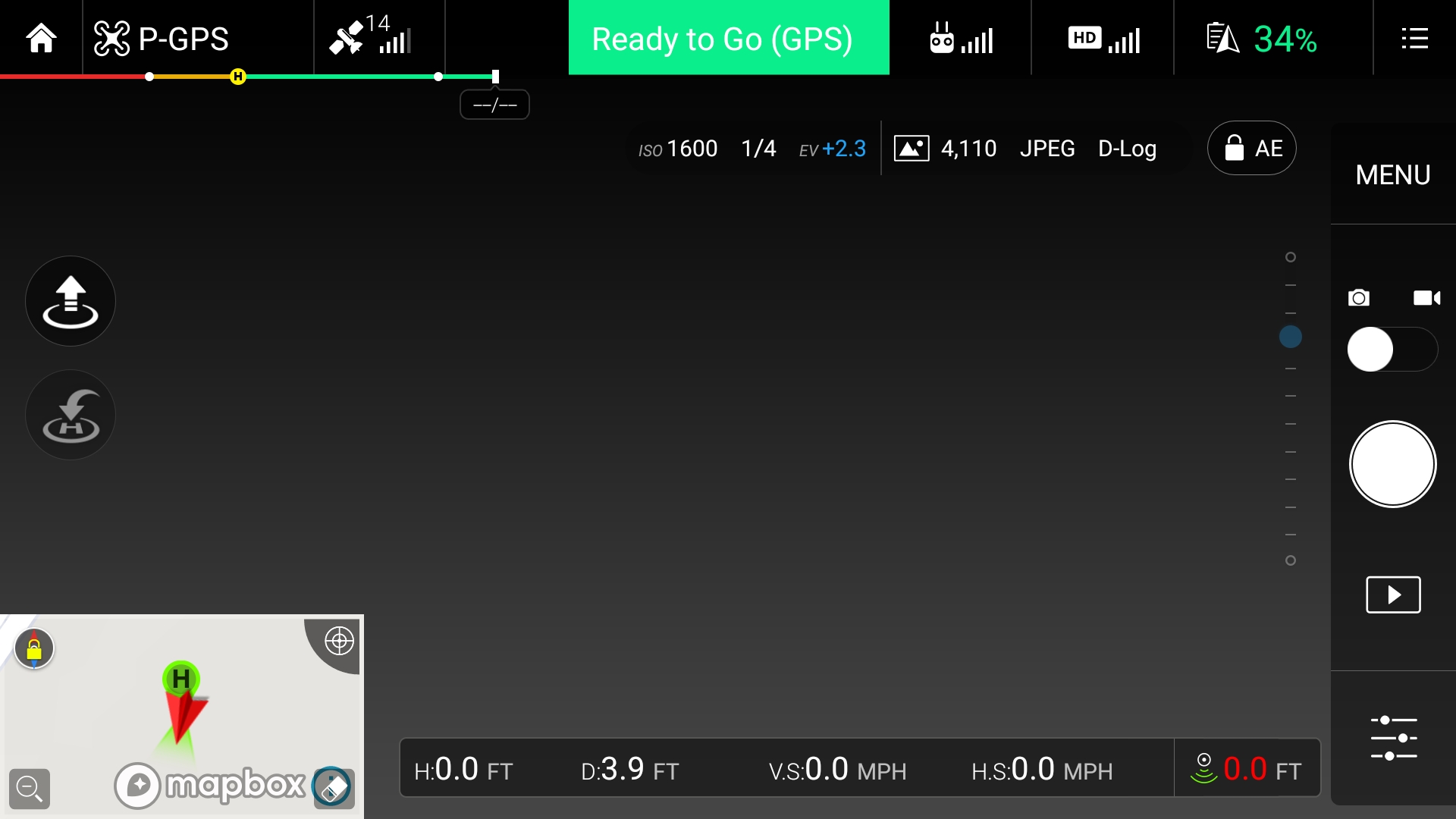

Here's a picture of the screenshot right before I am able to launch the Drone. I didn't want to launch it because I just got home from work and it's nighttime and I don't want to lose it because I can't see but it's pretty much the same thing when it's in the air... also my brother has the same drone I tried his cord and also his controller still the same thing

How far along in the troubleshooting chart (posts 11 and 16) have you gone so far? For example, have you confirmed via your LOG_AB file if your modules 8/15 are detected?

I tried following along in the log but it gets super confusing to me I'm no professional drone flyer I just fly around my house and take video pictures having fun so I don't know what a lot of that means
