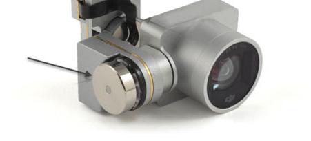

Hi guys, I'm new to the forum and flying. I just bought a used P3S. I was told that the pitch motor needed to be replaced as the camera does not move up and down when I use the scroll wheel on the remote. Typically when I fly I position the camera forward facing and I can fly for a few minutes before it drops straight down. Well yesterday I went out flying and surprisingly the camera worked perfectly fine and the scroll wheel moved it up and down. It only worked for a few minutes before going back to non responsive. That had me thinking maybe it's not the motor? Has anybody ran into anything like this?

The pitch motor is one of the harder motors to undo the wiring if you are not familiar with the connectors. I have a little metal hook that I use to flip the lever up. Then all l would have to do is push to ribbon in and push back down on the lever. Done.
Otherwise you have to remove the camera to get to the screws to remove the cover to the pitch motor so you can get to the ribbon connector.

I've tried doing the auto calibration but it still doesn't move up/down. I haven't been able to get it working normally since last week. I'll attempt to replace the cable first and see if that works. Thanks all

There is no part number because DJI does not sell parts. It is called a " Pitch Motor" Go to EBay and search for " DJI Phantom 3 pitch motor"
The pitch motor for the P3 works on the Standard, Advanced and the Pro. They only used one motor for all 3. You should be able to find a seller in your country. There are lots of sellers in China selling these if you want to wait.
