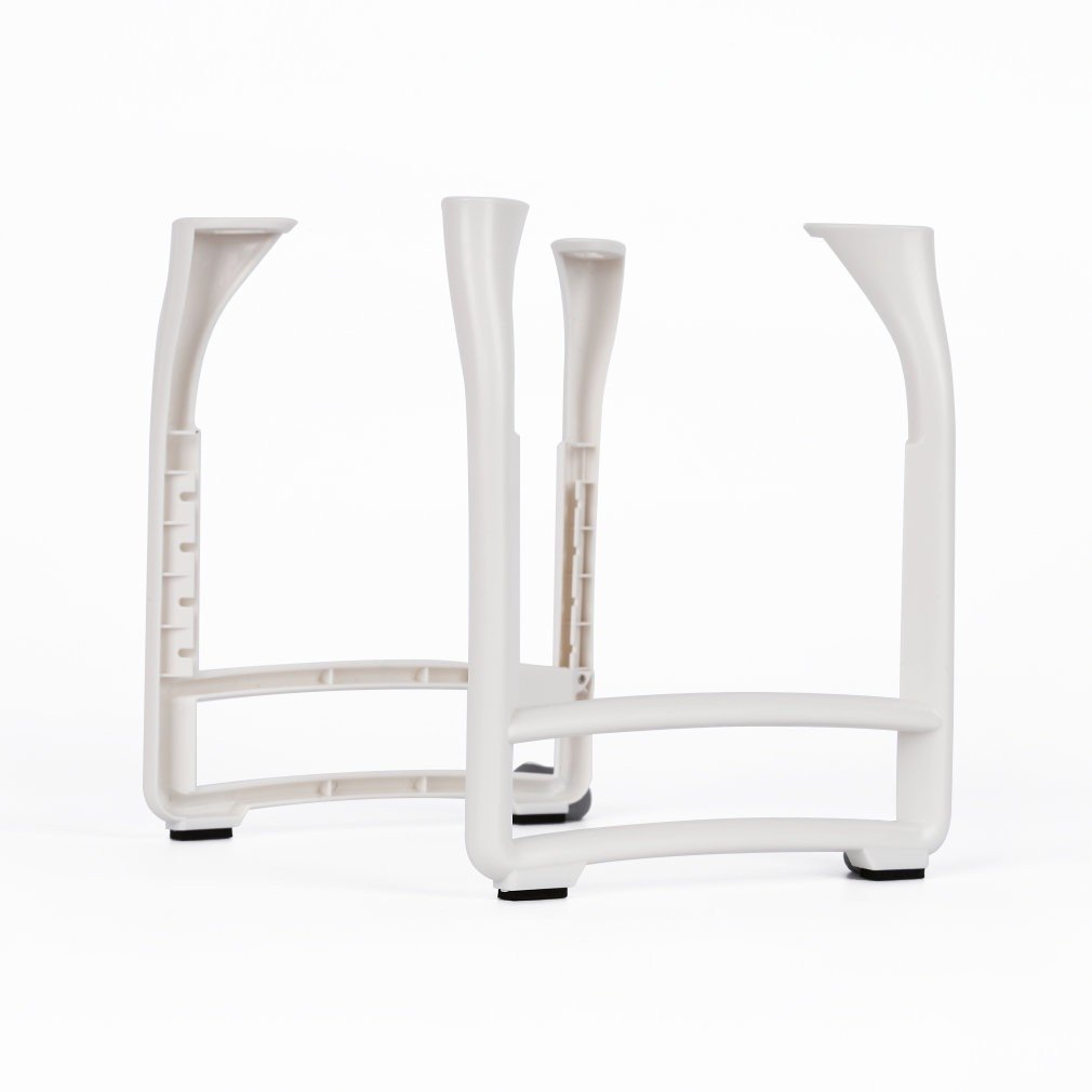

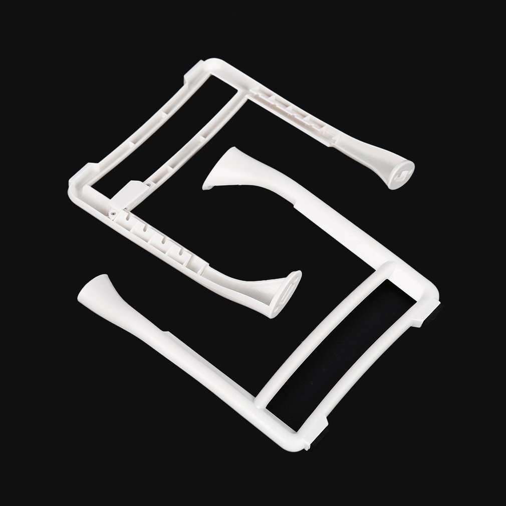

Hi ya all.My camera hits the gimbal guard of my P3 Advanced on start up and in simulated flight.I so far have bought 3 and they all do this! If I bought extended legs then the bird would be top heavy and what about the 4 aerials or whatever you call them that are in the legs?Wouldn't they then be too short?
Hi gagetman, what do you mean by "camera hits the gimbal guard"?
Since you posted a question at Pro/Adv I assume you own a P3P or P3A. A gimbal guard should be removed before you start your AC otherwise you will get gimbal overload error.
I don't use extended landing gears but I suppose you can use them without a problem. You should measure them to see how much extra weight those landing gears are but I guess it's insignificant. The 4 aerials are called "Antenna", when you open the shell there is a little extra cable length of each stock antenna (1/2" maybe?) that you can stretch it out. Do these extended landing gears with a longer antenna?

Remove the "Gimbal Guard"..... and set it back about a 1/2 to 3/4s of a inch..Mark the area where the webbing needs to be cut at on the gimbal guard with a felt tip marker that it needs to fit between and use a Dremel with a cut off wheel or a piece of a fine toothed hardware blade to cut new slots for the gears webbing.....No more touches of the camera what works FOR me can sure work for others Yaaaaaaaaaaaaaa !
Oh longer landing gear might be OK....but it can make it much easier to tip over on a non smooth surface..:oops:..the gear extenders would be my choice ! The best of Luck what ever you do.;)

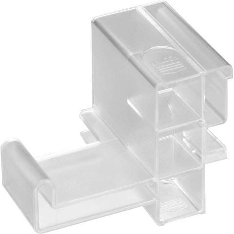

Vaughan, note that your original question was in reference to a guard attached at the bottom of the landing gear whereas the comment about removing before starting was in reference to the gimbal lock such as this one:
