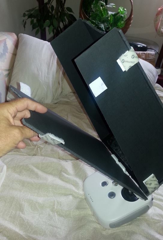

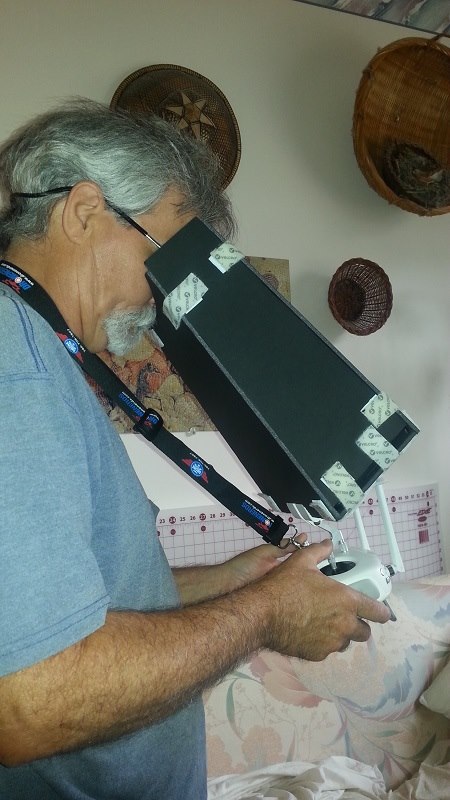

I make them out of what some people call Gator Board (held together with Velcro).
1: because it's cheaper, 2: because you can make them however you want IE length and taper...
Might look big and bulky but it's "very light weight"...
No pictures of the iPad (which is white on the outside) but here's the K1...
Geeez, had to go to FB to find and download these old pictures...

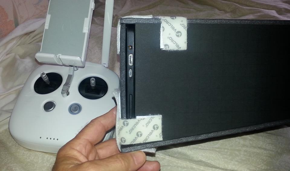

I wear light colored shirts when it's hot out (which reflects up onto the screen) so my shades all have removable bottoms on them.
Pictures were before I made a cut 5 1/2" up so only 5 1/2" of the bottom panel drops down (so you can tap on the screen to make changes)...
The way I sandwich the Table in here makes the box VERY sturdy with minimal amount of Velcro.
I used white Velcro because I though I was going to have to cover the outside White to reflect sun/heat but as it turns out the foam insulates so well that it wasn't necessary...
