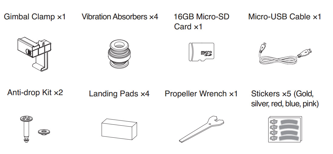

Here's a Question. Why does DJI include a prop tightening wrench? That would be more than just snug I would think.

that is good enough-- don't even worry about the prop tightening wrench -- you wont need it unless one is too tight and you cant get it off with our fingers.

How tight enough is perfect??
I use 1 hand to hold motor and the other to tighten the prop. I think tighter than I could do with just hand
Holding the motor and tightening the prop with just the one hand.
Dale
There is no prop tightening wrench. I bet you dont find that term anywhere on DJIs website, or any of the resources associated with it!
