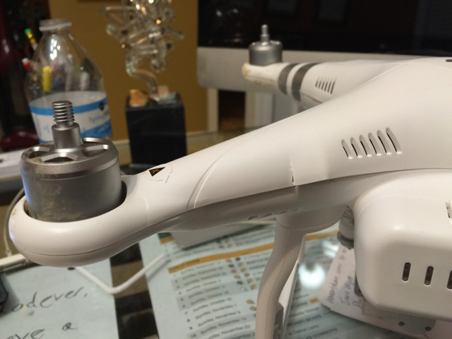

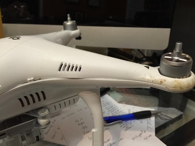

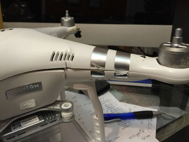

Two arms are fine. These are pics of the other two arms where damage is visible. The last pic looks like the worst damage.

Yes that shell is a gonner. I see you have the new motors - that's good. If Dji will not warranty it, you can replace the shell yourself. 3 hours plus another 2.5 hours for it being the first time. Follow the Youtube video as you work. Separating the shell is the hardest part, but you won't have that problem.
Straighten it enough that the props don't scrape the shell and see if it flies and the camera/gimbal work. Then have at it. You'll need torx and hex drives.
That's only if you can't warranty it.
Good luck! (for a change)
