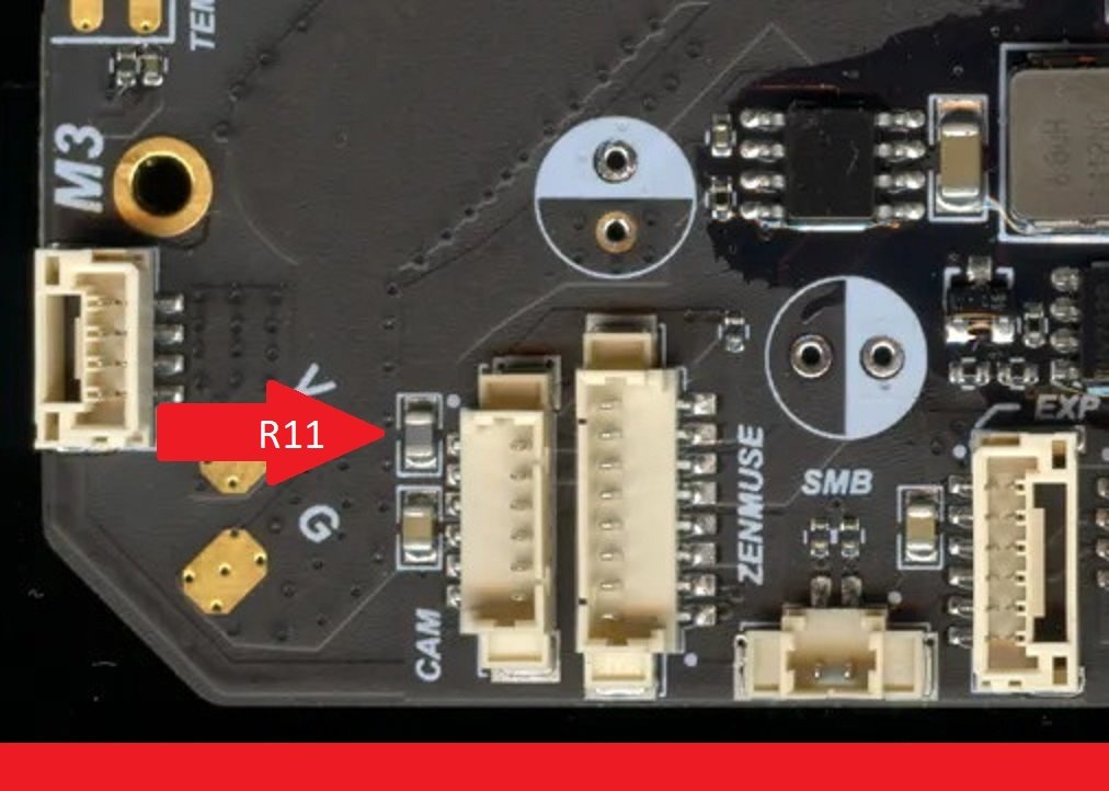

Hi, I have a Phantom 2 Vision (Std)
The R11 resistor on the main board has turned into a small blob of chard charcoal so it is dead and the resistance can’t be measured.

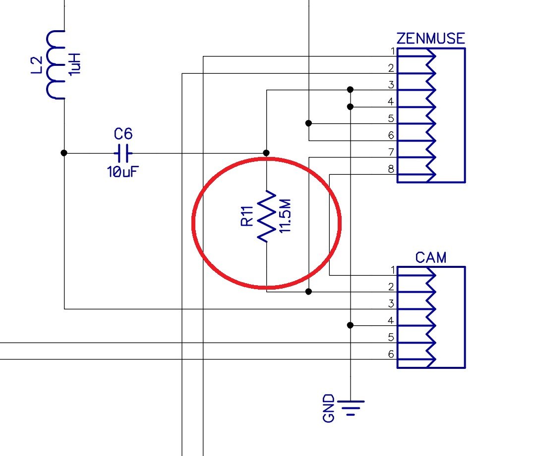

From the only circuit diagram I found on the net it is identified as R11 and is 11.5Meg Ohm resistor. As it’s the only diagram I can find I need to be certain what it is before I replace it.
It is a surface mount resistor next to the CAM socket on the main printed circuit board.

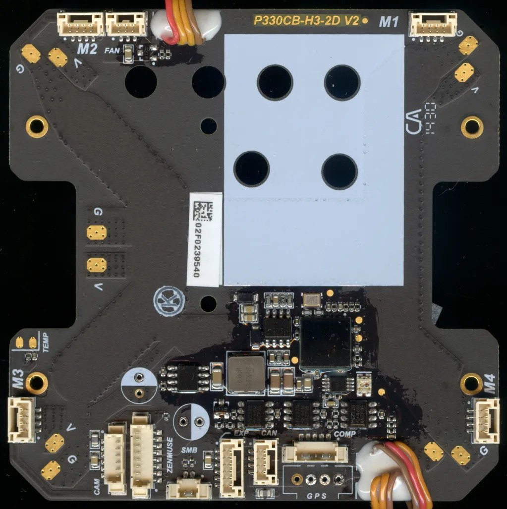

If you have one of these drones/main boards and are able to measure the resistance of the resistor I would be so grateful. The main board with R11 on is a P330CB-H3-2D V2 board.

Hopefully the attached pictures will clarify which resistor I need the details for.

Odd it should show it being a value of 11.5M as it's not a common value, hence the reason to have its value confirmed.
I have a garage full of components so I have plenty to choose from just not that actual value, but as you say it's a pull up and so it will have a wide value range that will still work OK.
