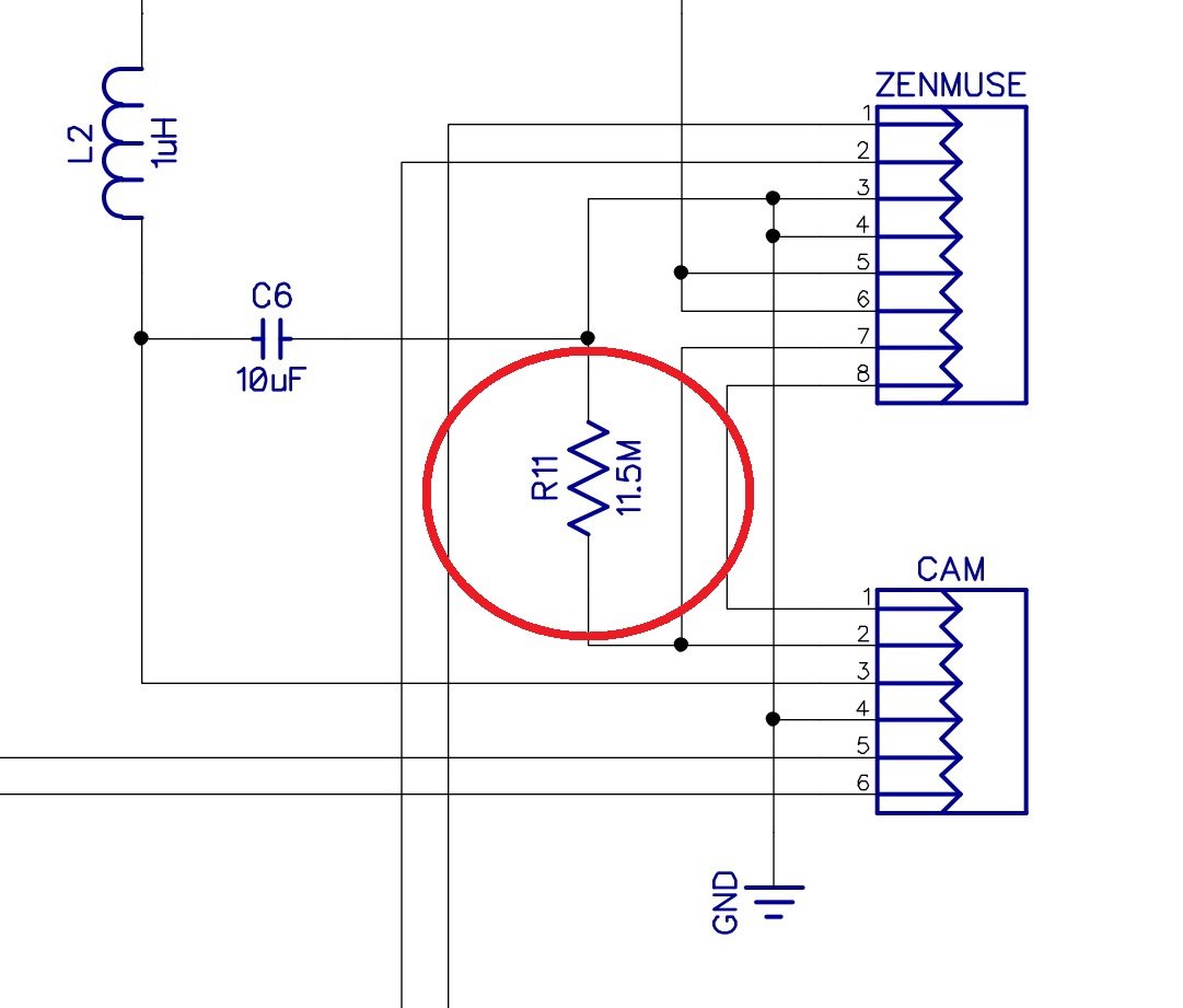

A resistor has turned to charcoal on the main board. From a circuit diagram posted on the net (the only one I can find) it is identified as R11 11.5Meg Ohm.

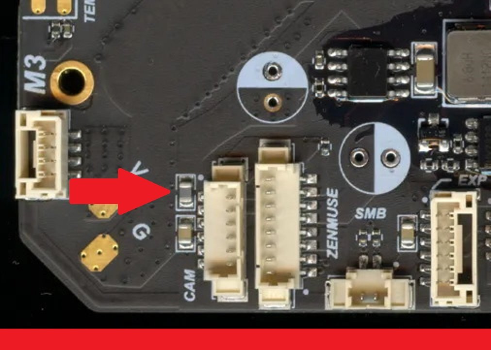

On my drones main board I can see it is a 0805 sized surface mount resistor next to the CAM socket on the main circuit board. Mine is just a small blob of chard charcoal so it is dead and the resistance cant be measured.
Having been designing electronics products for almost 60 years I have never come across a 11.5Meg Ohm surface mount resistor (I’m not saying they don’t exist but I don’t believe they are commonly used). Because of that I need to check and be sure before replacing it.
If you have one of these drones and are able to measure the resistance of R11 I'd be able to get it repaired quicker and I would be so grateful.
The attached pictures shows the position of the resistor.

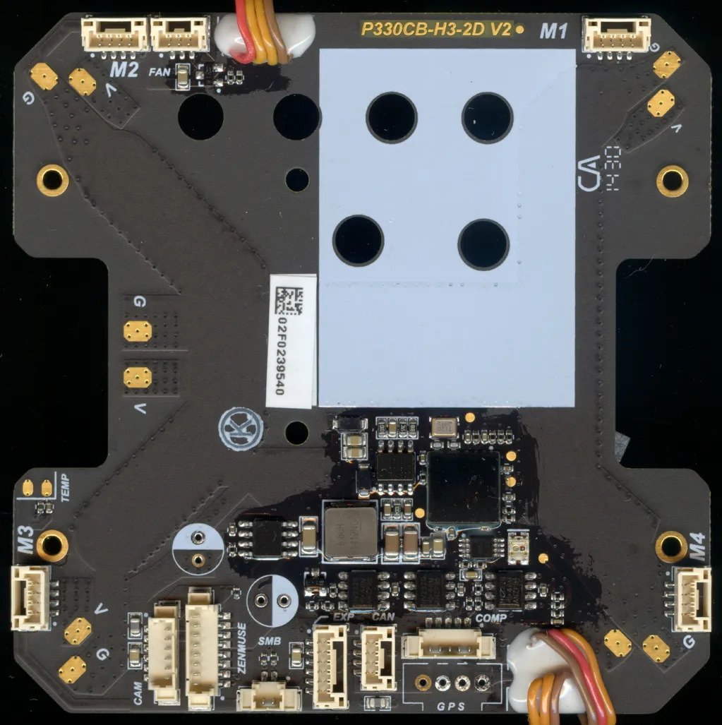

My main board (the one with R11 on) is marked P330CB-H3-2D V2 (see pic)

To measure the true resistance of the R11 first remove the drone’s battery, then remove the connectors from both the ZENMUSE & the CAM sockets. You should then be able to measure the true resistance by putting the meters probes on each end of R11.
