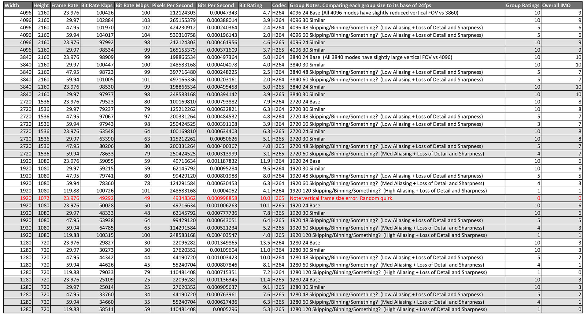

My findings...
Great table.
However, if you don't mind my asking... What's your subjective takeaway after testing all this?
For now 4K 30fps H264 is my go to mode. Still want to test 2 things properly to make a final opinion:
1. Fast movement and detailed scenes (eg flying low over long grass). It has been reported elsewhere that 1920x1080 and 2.7K retain much more detail is such scenes and movement than 4K. I trust this is the case but want to test for myself.
2. Does H265 have any benefit over H264 or visa versa. Opinion is H264 is the better option.
Thanks for the insight! Look forward to your final conclusions!
And thanks for sharing with the community!
