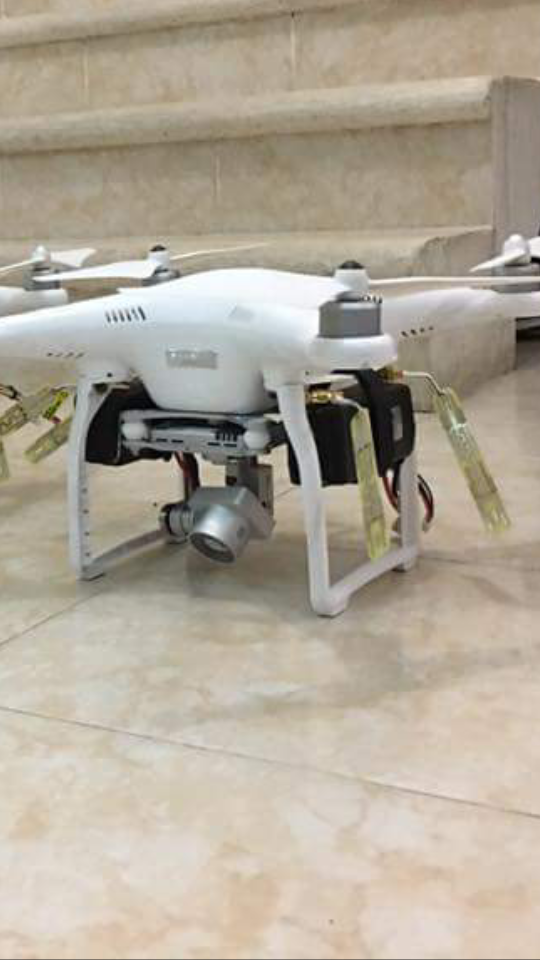

Here is the pic of the dudes setup...View attachment 77577
I love that!!! Really!!!
But the issue is vertical "polarization" The antenna on the remote are vertical..
So the ones on the Bird should be too...

Hey guys she is done,instead of completely taking the p3 apart,what I did is remove each antenna disconnected from lightbridge.then snake each wire though the p3 and re conected the wire.it was fast and easy.30 mins hope this helps.time for a test flite ooooooyaa!:)
